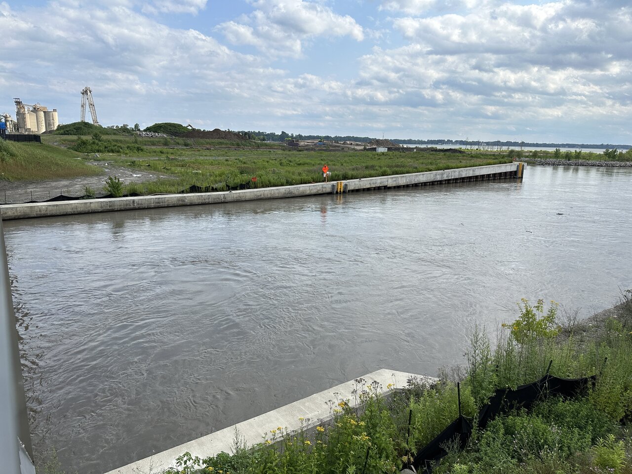

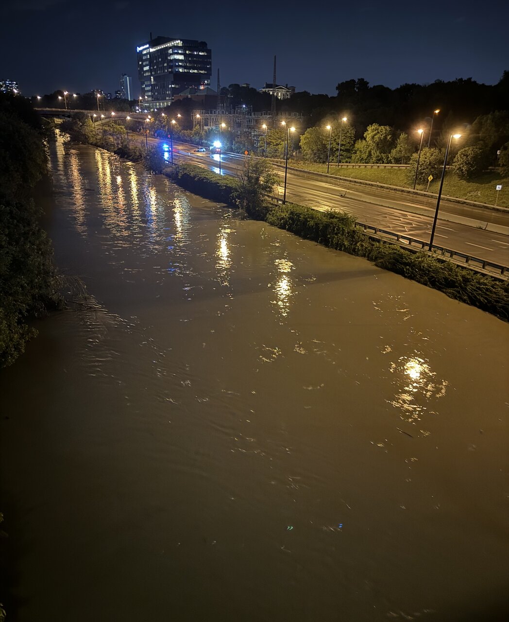

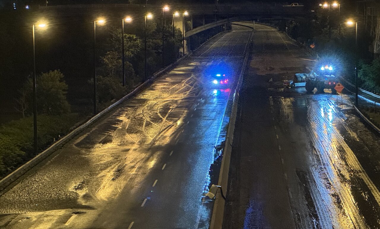

I REALLY wanted to get down there to check it out this afternoon but dealing with water issues in my home (located very close to Dundas / DVP) plus an out of town meeting later (made difficult by power outages and flooded roads) made that impossible. Just got home this evening and snapped a couple of cell shots from Dundas St. Sludge and muck still there but at least the water continues to recede.

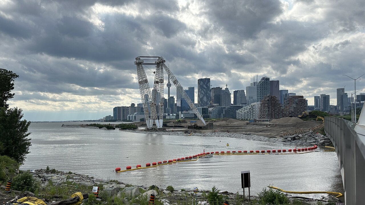

And here's a really grainy, far-away shot of the Lower Don Lands (to get us back on topic) you can really see how muddy the new river is. Looks like it did indeed take a lot of the overflow. Whole inner harbour is muddy actually.
