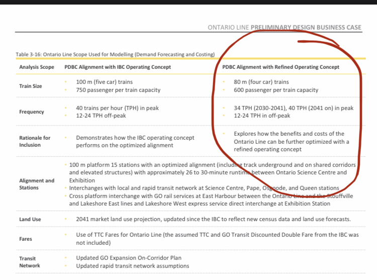

Is that true? I thought that on opening day it would have a capacity of 34*600 = 20400, which is definitely less than line 1. I agree with everything else you said.

If we use the Alstom Metropolis as a guide (which is the type of train that Metrolinx is eyeing at), a 6 car Alstom Metropolis TS which is used in Sydney has a max capacity of 1100. The Ontario Line will have 100m long platforms - long enough for 5 cars, so approximately 916.7 passengers if we assume all cars can hold the same number of passengers (realistically it doesn't, but for the sake of this comparison, the variation is fairly minimal). At 90s headways, or 40 tph, that's 36.6k PPHPD, significantly more than than Line 1 under the block signalling system which is at 26200 PPHPD. After ATC, yes Line 1 will once again have a much larger PPHPD than the Ontario Line, but if the last 70 years are any indication, its going to be A LONG TIME before that 36.6k becomes a significant problem, and at that point we can easily justify building a new line.
If we use the Alstom Metropolis as a guide (which is the type of train that Metrolinx is eyeing at), a 6 car Alstom Metropolis TS which is used in Sydney has a max capacity of 1100. The Ontario Line will have 100m long platforms - long enough for 5 cars, so approximately 916.7 passengers on the conservative side. At 90s headways, or 40 tph, that's 36.6k PPHPD, significantly more than than Line 1 under the block signalling system which is at 26200 PPHPD. After ATC, yes Line 1 will once again have a much larger PPHPD than the Ontario Line, but if the last 70 years are any indication, its going to be A LONG TIME before that 36.6k becomes a significant problem, and at that point we can easily justify building a new line.
Those estimates seem reasonable. Even if that's not planned for opening day, I get what you mean. Why do you think the train capacity numbers in the PDBC are so much lower than your estimate? (750 vs 916.7)
I'm not sure, but its likely that the PDBC is based off older estimates - perhaps assuming narrower trains (remember that they are still working on the fine details, and whatever assumptions they made when they wrote during the PDBC almost certainly do not reflect current plans). The most up to date publicly available specifications assume 3m wide and 100m long trains, which matches the Metropolis almost perfectly (3035 mm). Also I believe I have seen the 36k PPHPD marker written in an official document or press release however I can't exactly say for sure.
I'm having a hard time tracking down the 1100 people capacity on the 120m Alstom Metropolis TS. I keep finding the same dead link. And that number seems high to me. It's the same as the TRs which are significantly bigger. Full longitudinal seating accounts for some of that, but not all. Plus, the 76.20m x 2.94m Metropolis trains on the REM only have a capacity of 600 which would imply a capacity around 800 on the OL trains. If you do come across that 36k PPHPD figure again I'd like to see it.
Is it really 100m now? The PDBC changed it from 100 to 80, so that's a relief! :)
That's new. The only mention of 80m was an option to start at 80m long trains on opening day, but still build the line with 100m long platforms
That's fair, but let's assume that these trains will carry the more pessimistic REM specifications. That's still 32k PPHPD, which is still more than Line 1 today.

IIRC the PDBC called for shorter trains and fewer tph at opening with a provision for expansion later. It’s been known for a while, and there was quite a discussion on it in this thread.
That’s why your numbers are larger.
As I said.
I'm still using the maximum design capacity since upgrading the system to 100m long trains would cost almost nothing so making a distinction between the 80 and 100m variants isn't important. The platforms will be built for 100m in either case, the only change that would have to be made is adding a 5th car which wouldn't be difficult.
