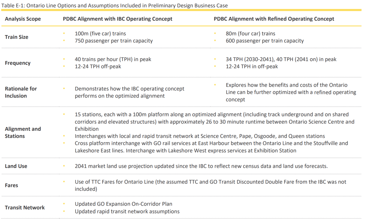

2- The ultimate train size is still targeted to be 5-car 100*3m trainsets at a capacity of 750 people per train. But the December 2020 Preliminary Design Business Case mentions that it would be prudent to start with 80m, 4-car trains. It has not been announced if that is the plan is what they will go with. Note that the capacity stated is not under crush load.
For reference here is what the PDBC's Refined Operating Concept.
For reference here is what the PDBC states as the design considerations.
A decision has not been announced on whether the province will go with the 80m train plan or not.
