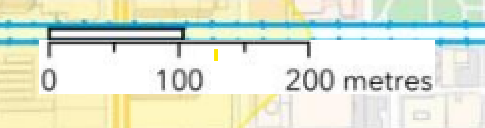

So the queen station box is a smudge over 100m:
(possible metrolinx intended it to be 100m but made one of there famous typos)
Compare that to this pic of the actual station:
... that station box is supposedly 100m. You'll notice two dashed lines where the elevator shafts end on the Ontario ... these are likely denoting the platform ends. Using our knowledge that the station box is 100m ... we can do some meters to pixel math. That spits out a 55m platform length. So either Metrolinx really bad at producing scale documents or ... all that blank space is for potential platform extension and the line is starting out with a Canada Line-ish 55m platform length.
The first image is not showing the station box but the length of the platform. If you compare with the actual buildings shown in the 2nd drawing above, the distance between the two dotted lines is indeed 100m. The station box is way more than 100m.

Did they? When has Metrolinx even released drawings showing detailed platform lengths? I’ve never seen any.
Nothing detailed - but on each and every station "plan" they issues in the last round, the station box was noticeably smaller. It was far too consistent to be an error. Though I suppose it's not impossible that the previous round included the entire box, and the new round only included the platforms.
Someone should ask about platform lengths at the next live session. Changing the station boxes and platform lengths is in line with the change in the PDBC in only planning for 80m trains.
