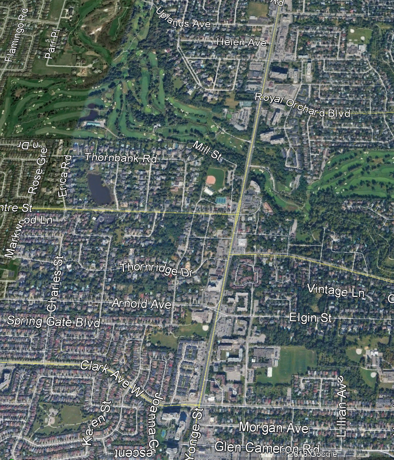

This is just a fast screengrab but for people who don't know the geography and topography:
-The golf course and river prevent you from building anything northeast of Centre. Similarly, it's a deep valley with old houses on the northwest corner, giving way to Bridle Path-level homes by the pond. You can also see the street network int he heritage district on the two south corners. You're getting ZERO infill on any of those corners. You would get some limtied redevelopment from Arnold to Centre, perhaps, but that would come even with nearby Clark.
-Royal Orchard has some substantial commercial lots right along Yonge, stretching north of Uplands, on the east side. There are some on the west side as well, but you're still probably looking at no better than midrise (6, maybe 8 storeys) and, again, the valley dives down to the south so literally no redevelopment there.
Will mixed-use development that is strictly limited to those Yonge properties be adequate? Maybe, but I remain doubtful.
As for the heritage districts, they have strict protections and even if they're not quite the Annex, particularly on the Markham side, you're going to get lots of NIMBY complaints even along Yonge. The interior is a total no-go zone.

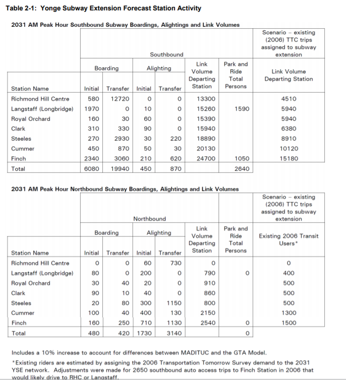

Went digging through the Conceptual Design Report which, as far as I know, is the most up-to-date planning document. Not hard to find the ridership projections...
Re: Royal Orchard:
"As shown in Table 2-1, the MADITUC model projected 340 passengers boarding and alighting at Royal Orchard Station during the morning peak hour in 2031, making it the least busy of the six proposed stations on the YSE. In comparison, current morning peak hour ridership at Bessarion Station – the least used station on the entire TTC subway system – is approximately 540....
Approximately 55% of the developable land located within 500m of the proposed Royal Orchard station is situated within the Vaughan Thornhill Heritage Conservation District (VTHCD)... In addition, the relatively shallow lots on the Vaughan side with the well-established Uplands community behind it and the existing high density on the Markham side, further limit the redevelopment opportunities surrounding the Royal Orchard station. Within the 500m surrounding the proposed station, approximately 70% of the 2031 projected development is already present.
The projected ridership volumes are too low to justify the capital and operating expenses associated with a subway station."
I'm curious what they think has changed here...
