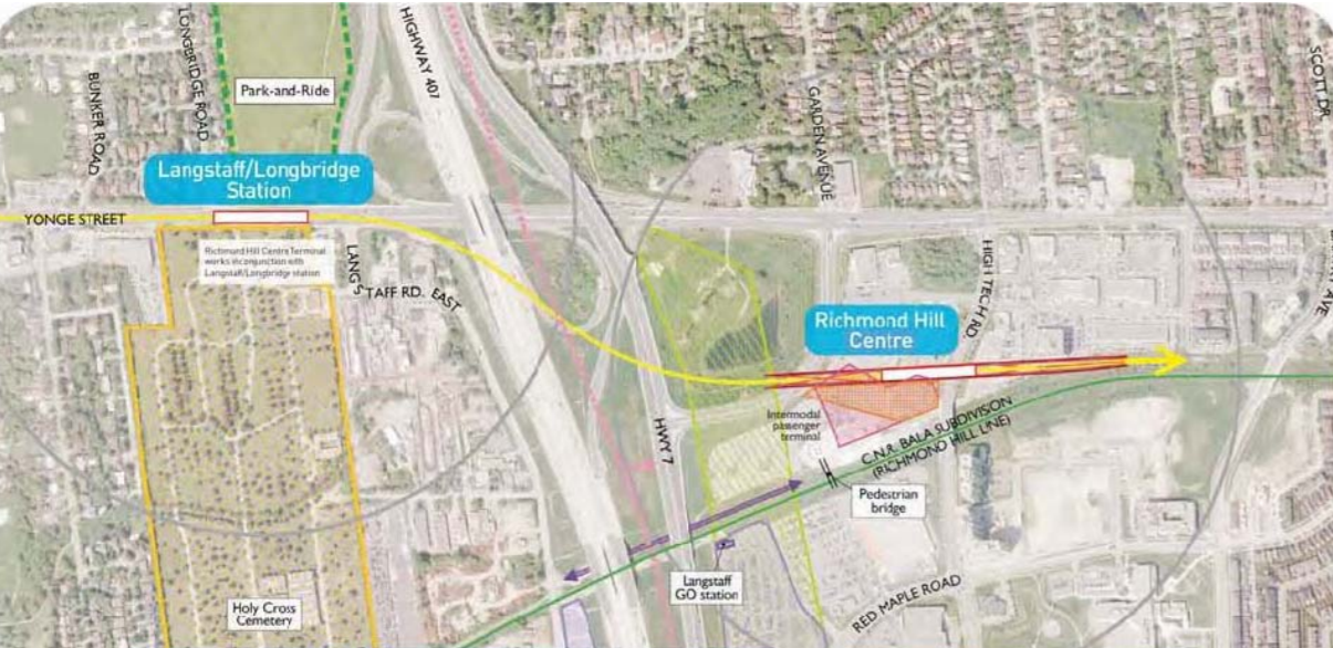

I'm not a fan of this:
  1. It makes the sharp turns even sharper and the speeds even slower
  2. If the inviolability of the Holy Cross cemetery from the center of the earth to Low Earth Orbit is the reason for our current alignment, then I don't see why using the southern end to run an above-ground train (that also cuts off the south eastern section for the curve) would be acceptable. Unlike all the other proposals, this would actually involve re-interring bodies and expropriating sections of the cemetery.
  3. If the goal is to add a stop at Baythorn (which seems to have better development potential but worse street connectivity than Royal Orchard) then the options that involve staying on Yonge are better for that since they don't force sharp curves
  4. If the stop is at Bay Thorn drive/Thornhill avenue, I think it would make more sense to name it Thornhill (as a homage to the area) rather than after a local street name.
But I like the very sleek map, it looks like it was made with Adobe illustrator.

The last leg. 400m radius curve off Yonge, north of cemetary. Langstaff Station - which slightly below grade (with development above it). Another 400m radius curve to get you back onto the Rail corridor (at-grade). Need to "tunnel" under 407 - which is a touch deeper than the Kitchener GO/401 tunnel (which is good) and the trains are not as high so tunnel diameter is less (which is also good) but it will still cost in the $100M range.
Your proposal is my favourite. I like that Langstaff station is located inside the Langstaff gateway. The original plan was to have it just touch the corner of the Langstaff gateway lands, with the cemetery covering the east side, a park and ride on the west side, and a highway interchange on its north.
Your proposal puts it a lot closer to all the development.
