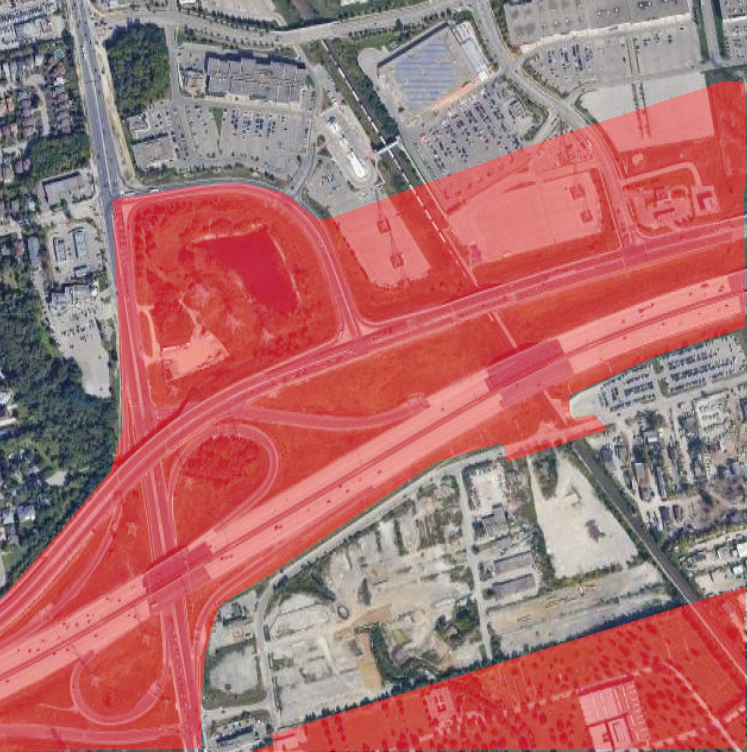

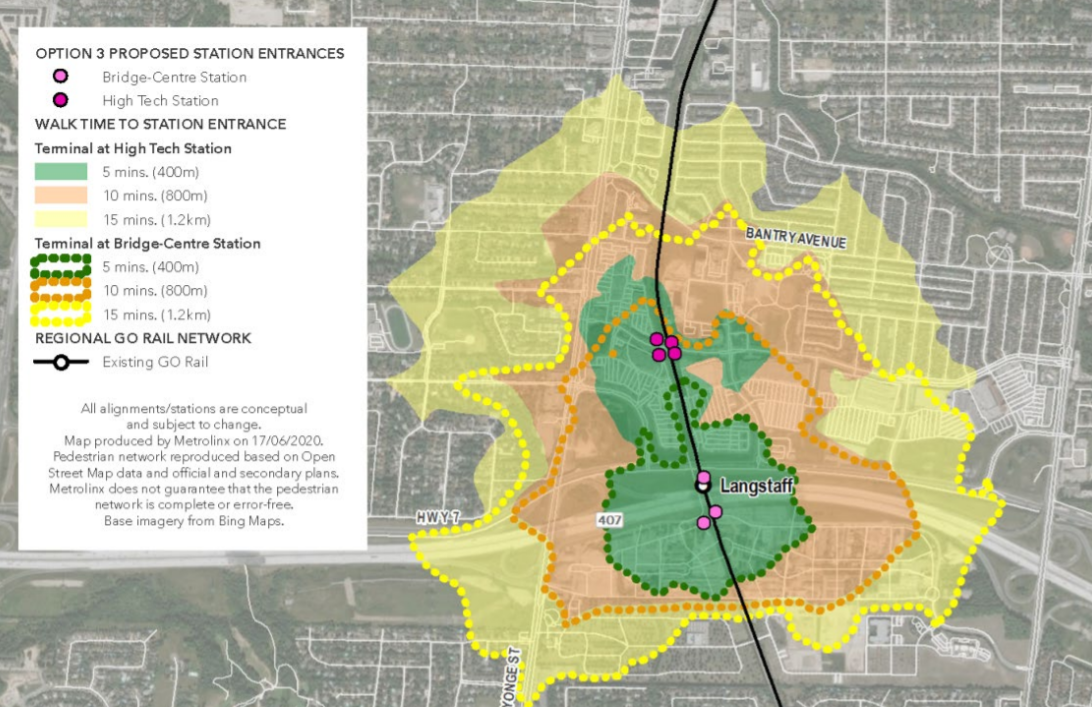

Any transit planner that sees the sea of red and puts a station in the thick of it doesn't seem to know who they are serving. Goal #1, maximize the developable lands served by the station by filling up 500m radius circles with lands that have or will have a large number of people to serve. Anyone who sees a station in the middle of nowhere as a win was measuring public asset value in a similar way to the pyramids of Egypt.
Everyone understands the contstaints of the site and the challenge isn't what to do if you were building from scratch but how to maximize with what you have. I understand the point you're making but disagree with the conclusions. Metrolinx's modelling (yes, it's modelling, not time travel) shows this configuration maximizes access to transit and ridership for the 2 halves of the growth centre. You were talking about the radii for walkability, well here they are:
Obviously some of that is in your red area but it's still capturing a lot of people and a lot of potential density and, given the existing constraints, that's why it's the best option. Langstaff Gateway alone is supposed to house 35,000 people and it looks like about 90% of them would be within a 10-minute walk of Bridge station. That's a win, right there. That's serving who you're supposed to be serving, especially when you take into account how easy that station location will make it to transfer between different modes/systems.
They aren't going to be moving the 407, highway 7, and the hydro corridor period and that space is the distance from King to Queen wide. No matter how dense the areas outside the red zone get, you significantly lower the value of the station by putting a station in the middle of undevelopable land.
You can find many materials on how to properly design urban transit successfully and walking distance and walking environment is always a key determination factor in how many people will use a station or stop. Ideally you put stations in the middle of developable land, not on the periphery of developable land to maximize the destinations that can be walked to in the distance that people would be willing to walk. I have seen that distance being a radius of 500m, 750m, and 1000m where the greatest value is walking with 500m, 750m you are starting to loose people, and beyond 1000m is needing a bus or not meeting the need. If you draw a 500m radius around a station and you don't have a good 2/3rds of that being developable land the station is in a really bad place.

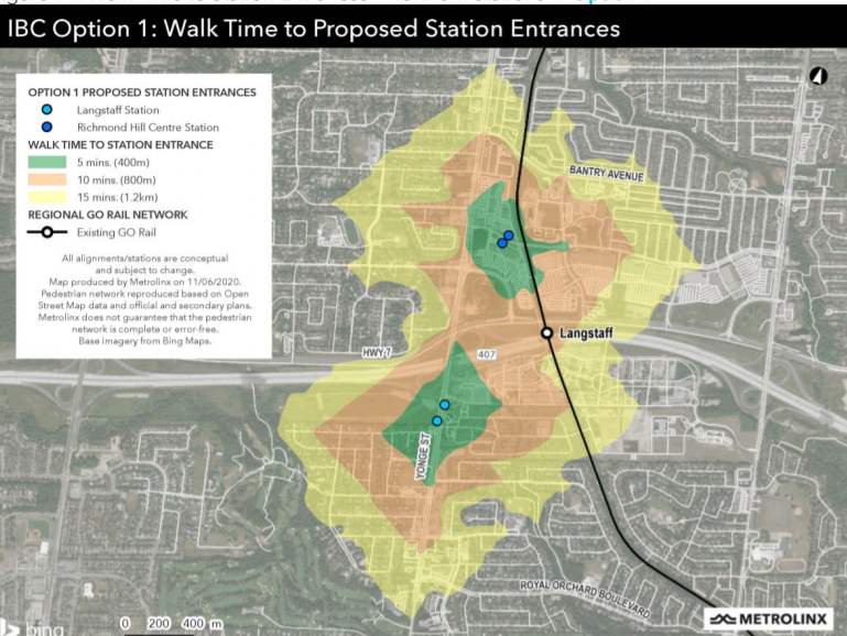

To be fair, the original (Option 1) location for Langstaff station was even more surrounded by red (cemetery to the east, park n ride to the west, SFH to the south, highway ramps to the north. So at least this is more central on an east-west axis to the Langstaff lands. You can see that in the station access time comparisons:
EDIT: I see @TJ O'Pootertoot beat me to posting this

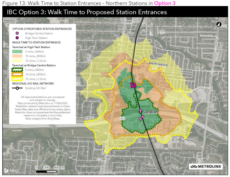

I think you're mistaken in saying that the only/primary goal for this station is maximizing developable lands. You'll notice that Metrolinx basically whittled the project down to the "Primary" stations, which have heavy bus traffic, and the "Complementary Urban Core" stations, which are more about TOD. Bridge is one of those Primary stations since it has such strong bus transfer demand from the rapidways.
Most of the jobs and people in York region aren't located along Yonge, they are located further east in Markham. To get there, most riders will be transferring to a bus, not walking from the station. The "Bridge" station is the central hub of the entire shiny new overbuilt Viva BRT system (and future 407 transitway) that connects everywhere else in York region. It's also a very convenient connection to Langstaff GO.
Direct, seamless transfers through the new bus terminal in result in significant cumulative travel time savings, which was noted in the option comparison of the IBC (option 2 vs option 1.) Mind you, all that bus transfer travel time benefit was lost in option 3 by the slower subway alignment.
In a way, they did try to improve the amount of developable land by using the no-man's-land between highways for the bus terminal.
I suppose one could argue that they also tried to stitch together the Langstaff lands and RHC with this station, since the station provides pedestrian connectivity between the two areas. It reminds me of the original plan for the Relief Line, where despite being downtown they managed to find put a station under a tangle of ramps. The stated objective was to stitch the neighbourhood together with the station.
Why? People understand that high-capacity transit is supposed to serve people right? What person considers it convenient to be dumped in the middle of an undevelopable no-man's-land? I don't understand why people would look at this and say "hey, this is a prime location for a subway station".
I think that, in general, you're absolutely right that this isn't a great location for walkable, urban development. I don't think we should plan to have high densities of people next to the noise, pollution, and general hostility of a highway anyway. The original (option 1) Langstaff location wasn't great either, since it was surrounded by a cemetery to the east, a future park n ride to the west, SFH to the south and highway access ramps to the north. At least the new bridge location is more centrally located in the Langstaff lands on an east-west context instead of just touching a far corner.
I think the fact that they decided to make RHC station only 400 meters away was an acknowledgement of the fact that Bridge is in a hostile location: Metrolinx needed to give York region the station for their "downtown" that they "deserve" which is centrally located for TOD, while still maintaining a convenient station link for all the bus transfer traffic.

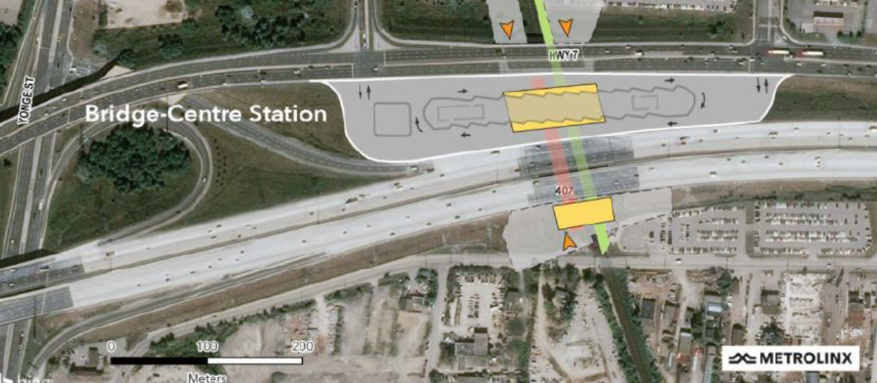

The proposed option surfaces as soon as reasonably possible. The goal is to get the subway north of the 407 is be able to effectively connect to the viva network and regional 407 buses. Unfortunately, because of poor prior planning, there is no surface ROW available so the choice is elevated over young or underground. Elevated would probably be cheaper but is, unfortunately, a political no-go given the areas it goes through. Whether you like the new design or not, I think Metrolinx deserves some praise for trying to push a design they believe is better for the long-term, despite the pain it'll cause in the short term.
I personally believe there are some smart engineers at Metrolinx who have figured out that they need to pick their battles for the long term. A couple of examples:

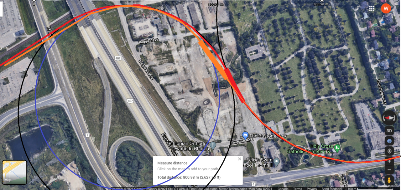

I made a couple of assumptions.
  • the NW corner of the cemetery property is not sacred. It appears to contain a scenic pond, and a storage building. I assume this can be dug up and covered over again.
  • A tighter curve is not as bad in the proximity of a station than it is mid-way between them. Near a station, the train is still accelerating so it's speed is not as high and the discomfort to the passengers not as great. Mid-way between, the train has already reached speed after leaving the station - then it has to slow down - then speed up again to make it to the next station.
Based on this, I have two options that will get you to the CN Corridor to go under the bridges.
  1. First, a 300m radius curve from CN, that joins a 400m radius curve to Yonge. The station is where these 2 curves meet - which I know is not desirable to have a station (Langstaff) on a curve and a compound curve (a cork screw at that to honour the nearby Dragon Fyre roller coaster).
  2. Next a 250m radius curve from CN, then a short tangent section for the Langstaff Station, then the 400m radius curve to Yonge.
My main goal is to build along Yonge using cut-and-cover and still make it to grade (or close to it) and utilize the existing 407 bridges. In terms of vertical elevation, I think it would only make it to grade at the Langstaff GO station. I think the cemetery would complain a lot more about a TMB launch site immediately on their doorstep than a relatively quick cut-and-cover operation that briefly occupies the corner of their property.

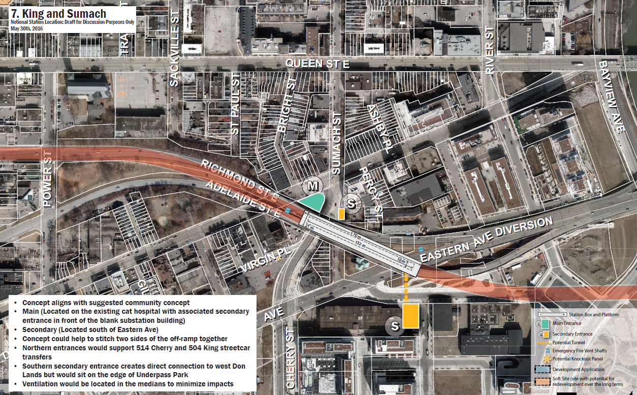

RE: Elevated. The most notable elevated transit in Toronto is the SRT in the STC vicinity. It is also the most built-up area of the entire line.
For Ontario Line, although some complain about the elevation - other complain about taking up valuable space in the GO corridor, not actually saving that much money with all the portals and TBM launches required.
The one thing Metrolinx has not considered is cut-and-cover. It seems fine to do it for stations - where the disruption is maybe 5 years. But for linear track where, with precast components, the disruption would be measured in months - they refuse to consider it.
If I lived in the area I would much rather have cut-and-cover for a few months, plus an extra station (with 3 years construction), than to have a subway roar through 100' below ground and no station within walking distance.
(I agree that elevated doesn't work here, and the only at-grade portion should be in the Rail corridor - if it makes it there).
Your alignment looks like it would be much cheaper (cut and cover) and slightly faster (shorter) than Option 3. It also puts the station right in the middle of the redevelopment area instead of straddling the corridor. So I think that's an improvement.
The only disadvantage I see is that you lose the direct bus connections. It looks like all the buses would be diverted north to High Tech road and RHC station instead of using Langstaff. So you've replaced a transfer station with an Urban Growth area.
If you're using cut-and-cover and approaching at-grade at that point, then you will definitely be digging up the cemetery. But from what I can tell on Google Streetview it looks like the part that you're slicing through is just landscaping, no graves. So maybe that would be acceptable with some compensation for the disruption. Given declining religiosity and church attendance, it's possible that Holy Cross would accept compensation for short-term construction impacts to their street-front landscaping.
Again, I'm not clear on what the actual constraints are with the cemetery, and Metrolinx doesn't make it sound like they explicitly know either. The option 3 refinement report just has the following passage:

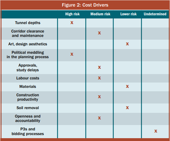

Since there's been some discussion here on why subways in Toronto are so expensive to build, I wonder if this is going to be a contributing factor:
The RCCAO report suggested that cost of material inputs isn't a significant risk factor in the cost inflation of subway projects.
But I'm sure that will be a contributing factor, along with the runaway growth in land prices.
I hadn't seen this before. This certainly makes a better transit hub than I was thinking with GO at Langstaff Bridge, and YRT/VIVA where it is currently located. Options that would improve service of developable land:
1. High Tech is the transit hub (subway, GO train, VIVA, YRT) and serves the lands along High Tech Road, Langstaff serves the lands south of 407. Use the hydro corridor to create better access roads and approaches to the bus terminal and re-orient the terminal to have more bus bays. Move the GO platform to High Tech. Maximized development potential and existing draw for the land north of 407. For Langstaff subway station move the subway station into the developable lands rather than tucking it into the undevelopable no-man's-lands.
2. Langstaff is the transit hub (subway, GO train, VIVA, YRT) and is shifted south from the proposed location, and High Tech station is not likely to be a big draw for any significant time and could be postponed until later because really Clark/Meadowview would have larger demand for a while. Bus bays on the site of the Langstaff parking lot with bus road under the 407 to the east of the tracks. Platforms centered south of the 407 better serve the Langstaff lands.
High Tech will barely cost anything compared to any of the mined stations, considering all you really need a roof, and stairs/elevator down from High Tech, so there's no point in comparing it to the Yonge stations.
And the Langstaff lands will be developed super quick. The few property owners own these lands for this exact purpose. The entire block is green(grey)field, and there are no neighbours to NIMBY around or complain about shadows. Free tax base for the municipal governments. High prices from developers for subway connectivity. The towers will probably be ready for move-in by the time the subway opens. I expect even higher density on this side of the Subway U than on the VMC side considering it's closer to the urban stretches of Yonge around NYCC and Midtown, plus the convenience of the GO station for downtown commuters.
