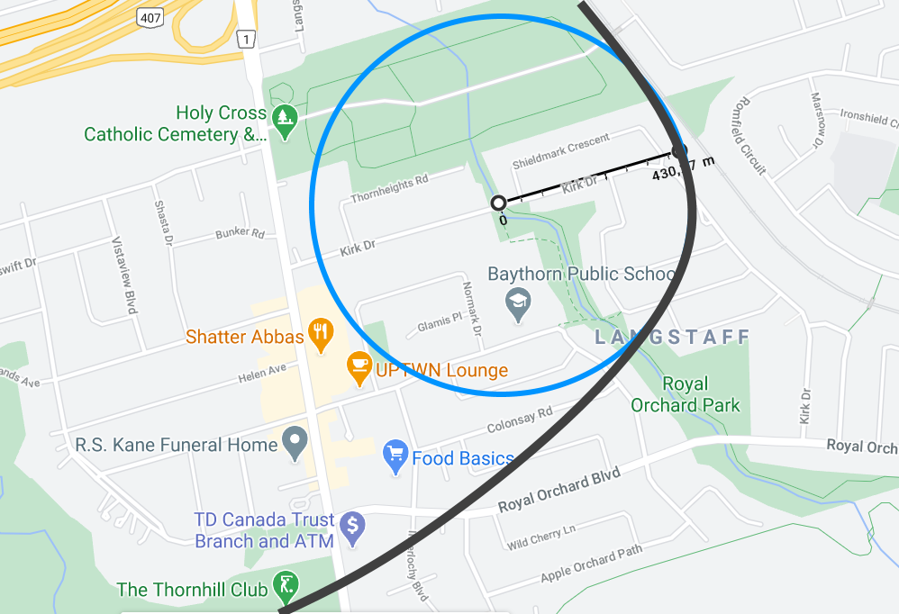

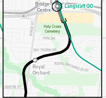

This is Metrolinx's curve
Eyeballing it looks like a ~430 meter curve, which is already not great.

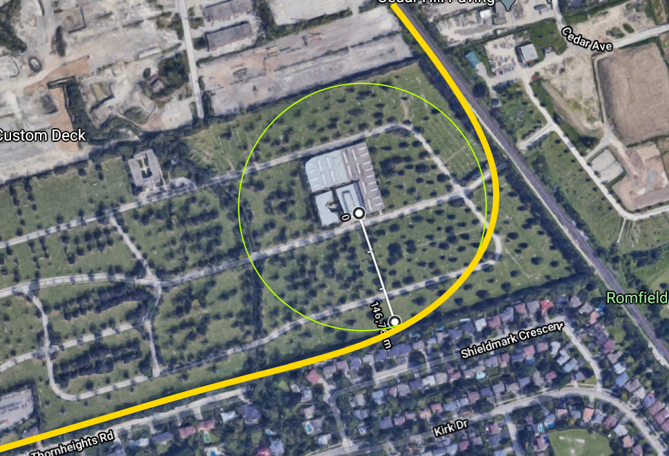

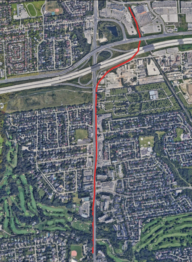

This is your alignment, the curve seems to be a little over ~150 meters. The cemetery is only ~300 meters wide and you are turning more than ~110 degrees, so for you to do the turn entirely within the cemetery means that <300 meters is the maximum minimum turn radius. But at that point you would just be cutting across it, not staying to the one end.
So yes, the curve is tighter with your alignment, which is natural when you only have a strip of land to work with vs. an entire neighbourhood to tunnel under.
The the bigger question is: You've avoided the disruption of tunnelling 25 meters below some people's homes to instead:
  1. Create an at-grade corridor running through those same people's backyards
  2. Eliminate the potential "rumbling" of deep underground trains and replace it with the screech of trains navigating a tight curve above ground (curves are responsible for almost all the noise and wear-and-tear on tracks)
  3. Carve up a good chunk of the cemetery for the TBM extraction point, portal, curve and at-grade corridor
I wasn't trying to do a reductio ad absurdum on your post, I was suggesting what I thought was a better option if the cemetery can be moved. The difference between option 3 and your alignment is that option 3 (the original, unrefined option 3 from the IBC) went under the cemetery and came at-grade in the CN corridor, so it doesn't involve moving bodies. It might be worth calculating what the cost savings are of having a trench through the cemetery vs. tunneling around it. If we save $400 million in construction costs and the Archdiocese is willing to accept $100 million in compensation for moving the cemetery across the street, it would be worth negotiating a settlement.
I'm suggesting moving it to Bantry, so it would be spaced evenly between Highway 7 and 16th Avenue. The two stations could have overlapping walksheds in the RHC area and "bookend" the development there. It would put it next to a bunch of highrises, not single family housing. But it would lose the direct link with High Tech road. High Tech road and Highway 7 are ~400 meters apart, so it's not really possible to have subway stops serve both without being close together.

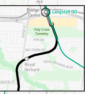

Actually a funny thing I've noticed about that black line curvy alignment map you showed. That's the map that Metrolinx gave to the media, that all the news websites used and is the main image for the Yonge North webpage on Metrolinx. That map does not exist in the Initial Business Case they released on the same day. That alignment is nowhere to be seen in it.

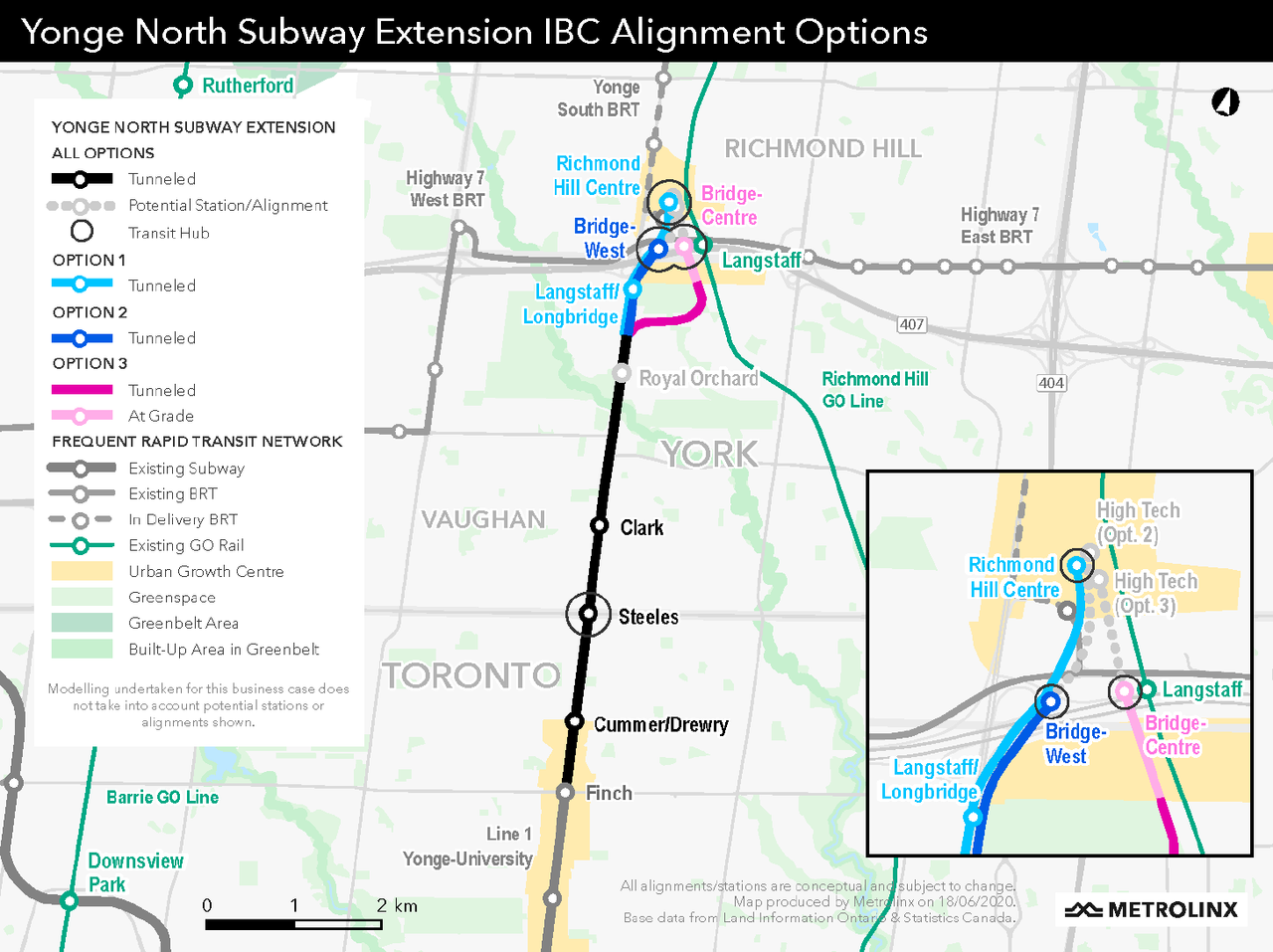

These are the three alignments indicated in the IBC:
I totally understand where you are coming from, that from that popular image that Metrolinx showed with the alignment veering westward to make a long curve to go diagonally under the middle of the neighbourhood to then make another sweeping curve along the rail tracks. From that, I would agree with you that sharper alignments aren't possible. But from Metrolinx's own IBC, they don't have that sweeping alignment. They have 1) the original undergound alignment 2) the original undergound alignment but with Bridge Station instead of Longbridge 3) an alignment that goes straight up Yonge and then makes a sharper 90 degree turn east on the north end of the neighbouhood just south of the cemetery and a larger radius but still acute angle, almost 70ish degree turn toward the rail tracks and come out of a portal at the north edge of the cemetary and at-grade to into RHC. So according to Metrolinx, sharper corners are available to use. Ofc, I absolutely agree that my map could show bigger radii and I believe there is enough room for bigger radii as well.
So I have no idea why Metrolinx released that alignment map showing the sweeping curves to the media when it is not even in their IBC. Going to be confusing for community consultations. In a recent York Region news article, residents had an outcry because they saw that map all over the news that showed the alignment right through the neighbourhood. But that alignment isn't being studied. It is an outcry for nothing. At the most only a handful of houses will be dug underneath in Option 3. Which is why I proposed moving those curves northward a bit so the tunnels would be going under grave rather than houses.
So really, I just think Metrolinx is in a mess and they seem to not know what they are doing or at the very least don't know how to handle PR. Is it that map they released to the media showing large curves veering westward to east? Or is it one of those three alignments in the IBC?

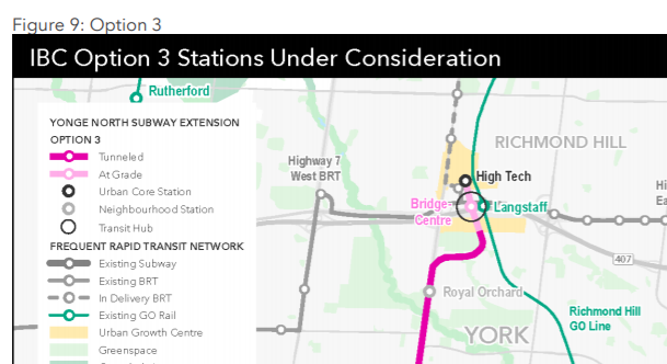

There are two option 3's:
  • There is the IBC Option 3 where part of the curve was tunneled under the cemetery. This is from 2020 but was only released this month.
  • There is the Refined Option 3 where the subway enters the CN ROW south of Holy Cross cemetery. This is the most recent alignment from 2021.
The Option 3 alignment as presented in the IBC saved on the costs of building tunnels and underground
stations by leveraging an existing transportation corridor. The alignment is proposed to curve east of Yonge
Street in the northern segment of the extension to emerge at the surface north of Langstaff Road to run
parallel with CN/GO railway line. The proposed Bridge Station and the alignment and stations north of it
would have operated on the surface within the CN/GO rail corridor. The alignment would have passed
under a portion of the Royal Orchard community and a small section of Holy Cross Cemetery before
reaching the portal north of Langstaff Road.
Metrolinx recognizes there could be sensitivities associated with construction and operations on or near
cemetery lands. With those issues in mind, further analysis of the northern section of the Option 3 alignment
was advanced immediately after the findings of the IBC were considered by the Metrolinx Board of
Directors. The refined alignment proposal presented below, alongside the Initial Business Case will form
part of the analysis that is presented in the Preliminary Design Business Case, which will guide the next
phase of the project. It represents refinements to the Option 3 alignment to avoid tunneling under Holy
Cross Cemetery and any associated land requirements.
So the Option 3 with the sharper curves isn't currently on the table.
Whoops my bad, I took another look and the document from 2013 that I linked to compared options 1, 2, and 2a instead of 1, 2, and 3. So yes, it's new but I doubt it was any more involvement from him personally than a directive to "innovate" to stay within a project budget and avoid unnecessary blowback.
I live near to this cemetery, and sometimes jog through it.
I'll admit that I would prefer if it had more water and mature trees as a park. And it has operating hours, which is a limitation that Toronto parks don't have. But I wouldn't consider it a landfill leaking toxic chemicals.
San Francisco, in its history, hastily relocated most of its cemeteries. A lot of the gravestones ended up as landfill and you can find tombstones wash up on the beach.
That is true about the screeching I did not think about that, thanks. Yeah, my map started as an exercise to see how Ford could save even more money, but I'm not really attached to it anymore.
Apologies for thinking you were ab asurduming my cemetary thoughts. But yes, I think the cemetery is full of opputunity and savings if it wasn't there. Even if construction savings weren't that high and negotiations with the church is high, the area of development for housing and park space would be worth a lot more.
Do you mean inbetween High Tech and Bantry? Or like right on Bantry? Because north of Bantry is all single family housing. I'll rather short spacing between High Tech and Bridge but with more proximity to dense development than the longer spacing of Bantry and Bridge but with less dense development. And i'm against further extending the subway northwards because it would compete and make mostly null the recently completed Yonge Viva rapidway, which has a station at Bantry.

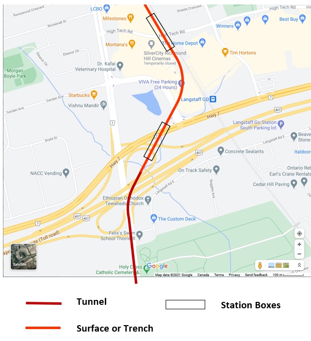

Still don't understand why ppl aren't talking about how they're going to extreme depths to tunnel under the Don. RL, where there's pretty well zero space to build a bridge, posters out of the wood work decrying how it's stupid to tunnel. And Metrolinx doing the rounds in the media saying it's stupid to tunnel under the Don. But out in the outer suburbs where there's ample space surrounded by low density? Where are those posters, where's Metrolinx saying we shouldn't tunnel? Doesn't add up.
Yup, there is abundant room to build a bridge here, instead. You could run elevated past the cemetary, but you still have the problem of the tight turns to get over to Langstaff GO, if so desired. Maybe cut diagonally across the Langstaff lands (sweeten it with a station at the NW corner of the site), over the 407 and put an elevated station at Langstaff GO. Should be possible to have a fairly gentle S-curve on the edge of the Langstaff site and over the 407 really, and aligned with the GO corridor past Langstaff GO. I guess we would have to see how aesthetically minimal we could make an elevated guideway for Line 1 rolling stock. Of course, Thornhill is too precious for an elevated guideway, let's spend several billion instead.
It's almost like 'elevated' is not even a consideration for Metrolinx. Shouldn't this have been one of the options, if not just to talk about the trade-off of cost vs minimizing above-ground impacts. Maybe we could have all the stations we want and not have to de-scope if they were above ground.
Just thinking: why do Metrolinx Options 1 and 2 have to be fully tunneled? Could they make something like in the picture below?
Looks like all conditions would be met: the cemetery is intact, the Royal Orchard houses are intact, both stations are on surface or in a shallow trench, the subway curves aren't too tight, and the subway line joins the rail corridor and can access the new yard in the north.
The price is: rebuilding a section of Hwy 7, the Yonge/ Hwy 7 connection road, two of the 407 ramps, and the Viva bus terminal. Maybe, filling up part of the little pond located between Yonge and the connection road. Compared to the hundreds of millions for tunneling and underground stations, or delays caused by the community opposition, maybe that's a reasonable price.
The price is why it's not happening. The little pond between Yonge and the connection road is a stormwater management pond - without it, surface runoff would be draining right into Bridge Station. It's likely not going away until Richmond Hill has a grand vision for the area in place to compensate for removing the pond, unless they decide to keep it. That, combined with having to rebuild Highway 7 and the connection roads and ramps, would cause absolute chaos in the area and I seriously doubt York Region's cities would let that happen.
