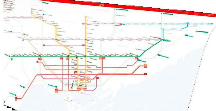

I have zero mapping skills, but I will attach this mangled version of your map just to show my point graphically. I suggest you change the scale of the map the further you go from downtown. i.e. make the 4km from Bloor to the Lake twice as big as the 4 km from Bloor to Eglinton, which in turn is about the same as the 8 km from Eglinton to Finch. I tried something similar in the East-West direction (i.e. scale gets smaller the farther you go from downtown), but made an even bigger mess of it. This would make it easier to follow where the streetcars actually go. It may be nice to have the street grid faintly in the background and/or some of the streets labeled so you can tell what streets the various transit options are on.
That's common practice for many transit maps but I don't like it for a couple reasons. The first is that Toronto is wider than it is tall, if you elongate the horizontal it actually makes it even more difficult to fit everything within a small area. The second is that I wanted to keep relatively close to the actual geographic distances between points. One of the issues with the London Tube map is that people don't realize how close stations actually are to each other because of how abstract the routes are. We don't have a very dense system here in Toronto, even in 2020, so a high level of abstraction isn't really necessary in my opinion.
