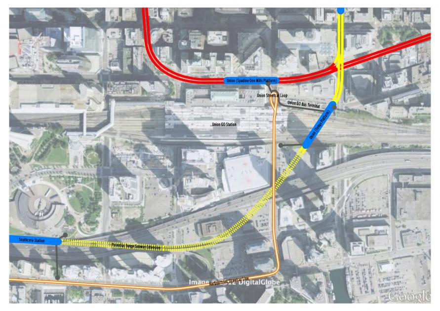

This is more what I had in mind. You can see that the station box avoids the foundation of the Dominion building (although admittedly just barely). Based on the grades as well, I have the Yonge line passing overtop of the Spadina-Don Mills line. That may pose a problem coming east from the existing Union Station though. I admit that this would need a more detailed feasibility study than what I have the resources or the expertise to do, haha.
