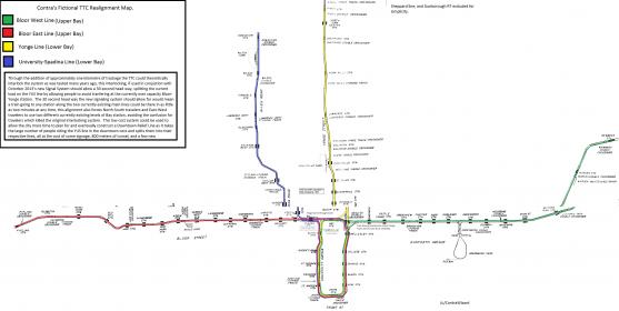

Not so much a fantasy map as a relatively inexpensive alternative to the current system which could prove to lower some of the current strain on the Yonge-University-Spadina line, by interlining the system (as has been tested previously) and splitting it into four lines one could control for the problems faced with different levels at Bay Station, the realignment would need about a kilometer of new track reconnecting Lower an Upper Bay stations in new ways, the alignment depicted allows all North-South trains to be on the lower level at all time, and all East-West trains to use Upper Bay exclusively. With some re-signing downtown and the addition of an automated announcement system, along with the new signalling system being installed in a few weeks, one could reasonably expect to have a train going almost anywhere in the city with a minimum head way of two minutes, or 30 seconds between each train (headway for trains on the YUS line after this October's shutdown).
This system could not serve to replace the idea of a Downtown Relief line, but it could reduce some of the strain on the current system and buy the city some time to build the a new line. I welcome any criticism to the map or the idea, I'd like to see this actually go somewhere, and I'm hoping its' relative simplicity and low cost make it attractive. It would also be possible to examine the idea of adding a Cross-Bloor express train that does not do the entire loop and runs the current Bloor-Danforth line in peak periods, allowing those crossing downtown to bypass it and avoid a transfer.
Contra Wizard. -First time poster, long time reader.
Edit: Sorry my pain skills suck.
Edit 2: Large Image at: http://i.imgur.com/fSRuwKR.gif
Interesting idea, and welcome to UT!
The interlining scenario certainly has some merit. I just have to question the feasibility of building a new partial wye around Yonge & Bloor. I mean, the Yonge Subway through that area isn't very deep, and there are many more buildings with deep parking garages underneath than there were when it was built in the 50s. I know the map isn't exactly to scale, but specifically the N to E crossover from Wellesley to Sherbourne, that would have to cut through a sea of condo and office tower parking garages in order to match the grade of the existing Yonge Subway. Also, the section of the Bloor line from Yonge to Sherbourne was TBMed (or at the very least not cut-and-covered, but I believe it was in fact TBM), so building a new wye in that area may also be very difficult.
Also, I would add a through-route on the Bloor-Danforth line, because there are quite a few trips that cross Yonge. Even in the original interlining scenario the TTC had, there was still a route that ran from Kipling to Kennedy (or at that time I believe it was Keele to Woodbine). You'll also need that in order to maintain adequate headways. With 4 routes running downtown and assuming a minimum 1.5 min headway, you're looking at a minimum of 6 min frequencies on each of those branches. If you want to cut that down a bit, what I would suggest is running 2 routes on B-D instead of 3: One that runs from end to end, and another than runs from end to end via the downtown loop. That would still get the diversion you're looking for, but wouldn't chew up so much headway time.
Very interesting idea though, and if they wye complications can be sorted out, certainly something that has merit.
