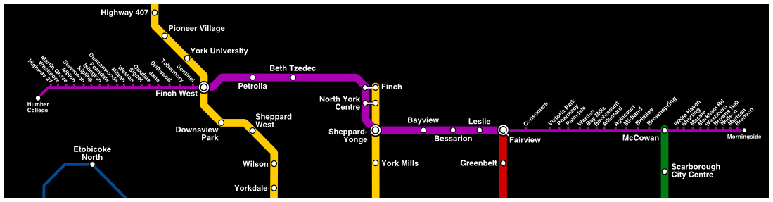

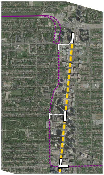

Although I love the idea of northerly crosstown light metro solution, and definitely believe something interesting could/should be done with the SRT's existing guideway, I'm more inclined to keep the current SELRT and FWLRT plans - but fix the central section and how the two meet. I think Gweed's idea is good in that it uses Dufferin, TTM's idea of using the valley/parkland to connect on a diagonal has merit as well, and I think Bathurst is worth a look too. But at the moment I like an idea I posted a couple months ago.
-Sheppard Stubway converted for LRT
-a 2.5km tunnel built under Beecroft paralleling one block west Yonge, with connecting stations through North York Centre
-a 6km surface alignment along the Finch Hydro Corridor, with subsurface stations at Dufferin and Bathurst
So basically everything would be very similar to the Eglinton Crosstown in that it's in-median tram-style in the outer areas. But between Keele and Don Mills we have full grade-separation and subway-like speed/reliability.
1) The costs of the 2.5 km tunnel paralleling Yonge would be too expensive. Since this line will have low ridership, it needs to be designed as inexpensive as possible.
2) Your plan is good is if our goal is to improve local travel. But if our goal is to facilitate crosstown travel, the Highway 401 surface subway alignment I propsed would be better.

I do quite like this idea, but I don't see any particular reason why the line can't be run at-grade through North York Centre. I'd also shift the line up Yonge Street past North York Blvd in order to provide a better connection to Finch Subway Station and to add an additional station at Churchill.
A station at Churchill is a good idea, and I'd consider adding it to future maps! But the reason I wouldn't want it to run on the surface (particularly on Yonge) through North York Centre are twofold:
1. I don't really see how we could make a portal from the existing Sheppard tunnel for the line to get up/onto Yonge without basically destroying much of the existing tunnel (and thereby compromising use of its tail tracks to the west, the Yonge-Sheppard interchange, and any potential future use of the tunnel). I'd like to keep the existing Sheppard tunnel/tail/station intact, which I think a small diversion track from Sheppard->Beecroft could do.
2. Although Yonge is definitely wide enough to handle an in-median setup, this type of tram-style operation in such a high traffic central area would very much lower the speed/reliability/capacity of the line. And for a route to go from in-median (Finch West) to grade-separated (Finch Hydro) back to in-median (Yonge) back to grade-separated (Shepp Stub tunnel) then back to in-median (Sheppard East)...it'd be an operational nightmare. So I think keeping the central section between Keele and Don Mills grade-separated is important. In other words it'd be similar to the Crosstown, or other pre-metro / stadtbahn type lines around the world.
I'd like to it to be cut/covered, which should have much lower per km costs when compared with deep bore. Not unlike other streetcar tunnels we currently have. But IMO the high cost of this 2.5km section of new underground infrastructure would be made up for by the inexpensive surface/trench grade-separation on Finch Hydro (6km), and conversion of Shepp Stub (5.5km). So the end result of a complete 14km grade-separated central section would justify the cost of the short Beecroft section.
True. This is basically a common gripe many had with TC, and what Schabas covered in that chapter I linked to. This is why I try to see the benefits of each proposal, fantasy, idea, etc. Should we have more stops and slower service (e.g in-median), or fewer stops and faster service that may or may not deviate from where people live or are going (e.g light metro or subway)? All are beneficial imo and worthy of consideration.
But yeah, I definitely support most of your idea. I just don't think heavy rail subway is the right mode - even if affordable attempts are made. I think the original ideas behind a northerly crosstown line got things right in that it was all in the mode (ALRT or ICTS...both variations of a similar medium-capacity adaptable 'light' system). It would do the things your line proposes, but more optimally. E.g elevating steeper gradients, tighter turns, running through greenspaces and highways, offering medium/long-haul commuter benefits (but also local/med-haul rapid transit benefits), etc. Standard light rail can do this too, but afaik because of street-running requirements the trains are heavier and more expensive. The standard Toronto subway rolling stock on the other hand is a hulking beast that lacks many of these benefits, and IMO should only really be used where absolutely necessary. This is why I believe the Sheppard Subway as heavy rail was a mistake, and why it never got extended further than it was planned.
