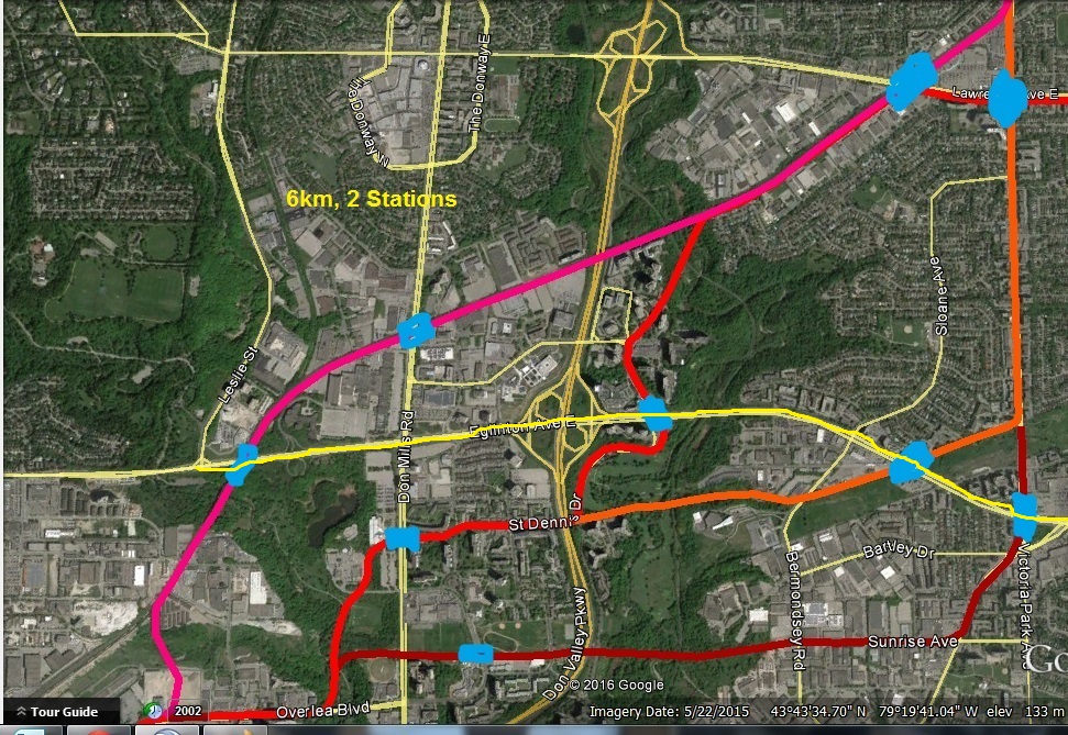

Second Segment: (South-East) North York
Targets: 1) ECLRT Interchange. 2) Other Stops
This is about 6 km, with several possible routes, with about 2 stations.
With ECLRT not being grade-separated, it makes it difficult to find a strong preference on where to cross Eglinton. Vic Park makes some sense as the busiest location, but it means another crossing of the hydro corridor. Near Leslie, alongside the CPR is easiest bus misses serving Flemindon. At Wynford, through the Don Valley is another option.
Depending on exact routing of DRL, could have an interchange at Don Mills/CPR, or at Science Centre, or leave the interchange for the Thorncliffe area.

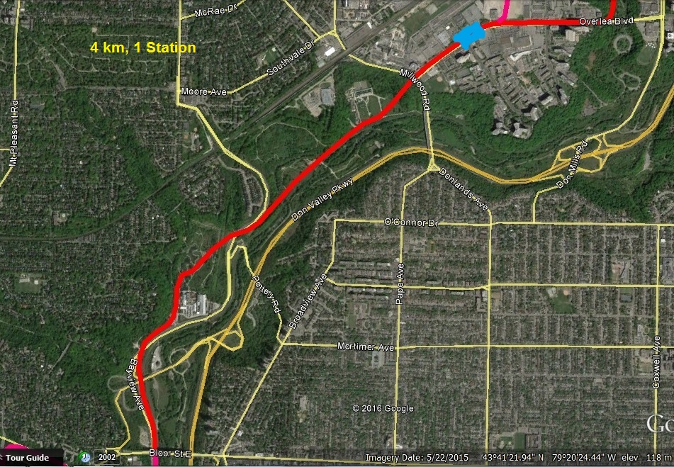

Third Segment: Thorncliffe and Don Valley
Targets: 1) Thorncliffe
This is about 4 km, with only 1 station.
The only stop here is at East York Centre Mall. Depending on DRL alignment, an interchange could be made with the DRL could be made, although near Science Centre is another possibility. The other goal here is to find a route that is fast, inexpensive, and disturbed the fewest number of NIMBY's.

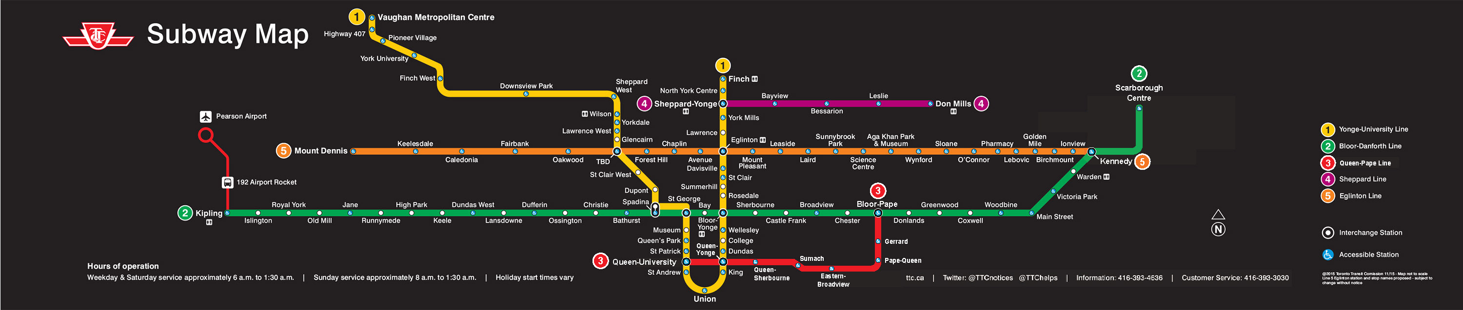

Assuming DRL and SSE based on most recent proposals:
AWESOME map! Well done!
Only a few things I would change / add… for the relief line, wouldn’t the Pape station be renamed Danforth-Pape? It is on the Danforth. I suspect Queen-Pape will be named Queen East. I’d love to see the Eglinton Crosstown East line added.
Don't count on it. Knowing the TTC of late they'll just leave the station named as Pape because a few idiots would get confused if they renamed the station properly. See Eglinton station not being renamed Eglinton-Yonge.
