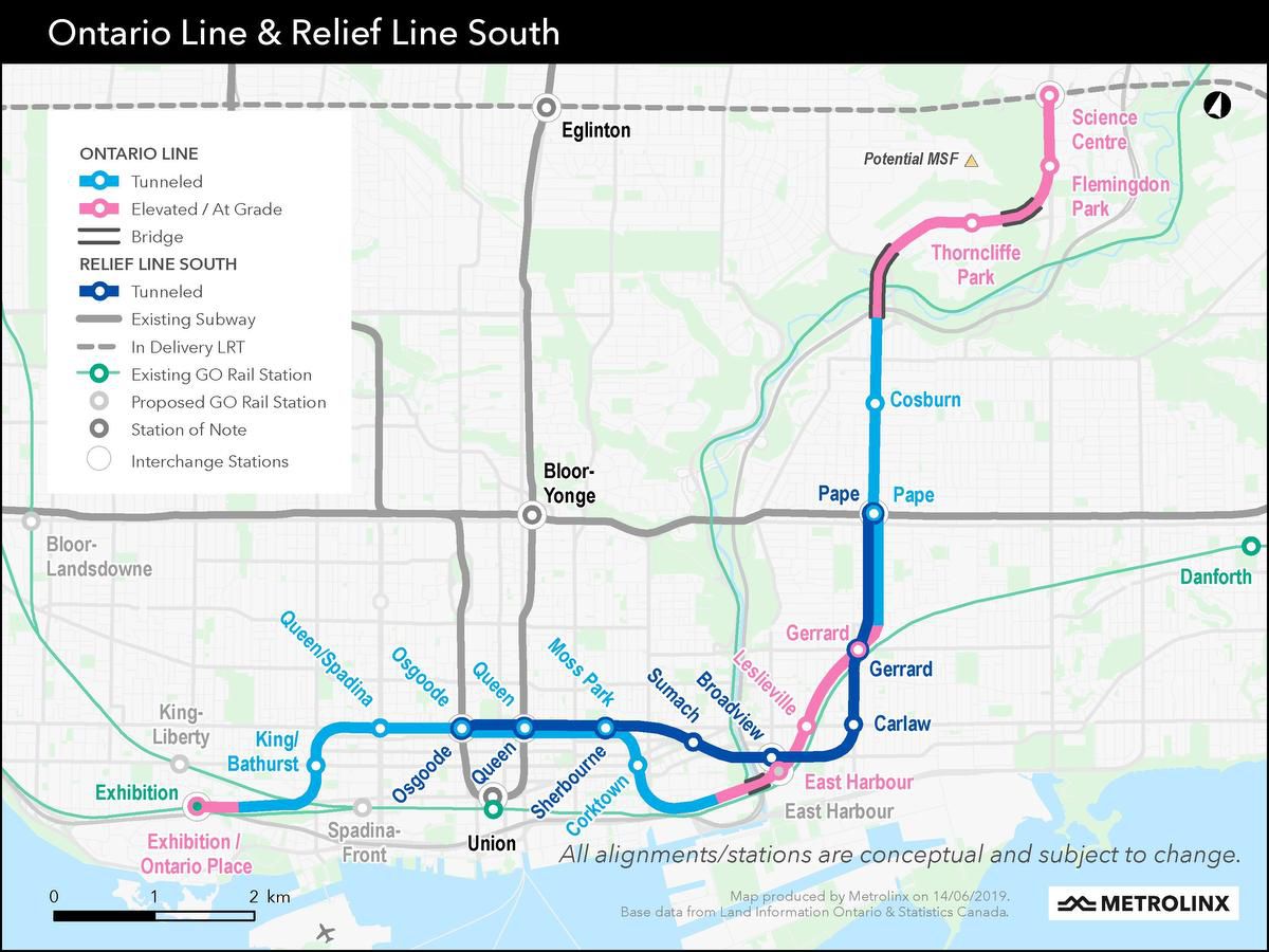

Ontario Line beefed up a bit to make it more useful to the surrounding communities:
  1. At distillery, the line is likely on a steep grade to switch from buried to elevated. Not sure there is enough space to put a flat enough spot for a station.
  2. I was liking your Liberty alignment, but appears that some current construction will preclude the curve from Queen south.
  3. one stops enough North of Danforth.

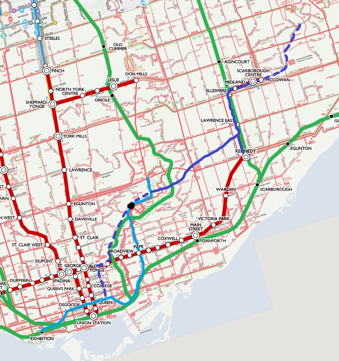

What can be done with Scarborough Subway, now that Ontario Line route is more or less set.
SRT corridor to Hydro corridor to Thorncliffe.
Here it would temporarily interline with the Ontario Line. The next phase of this Scarborough Line would forge it's own way downtown, through the valley, up Rosedale Valley, and down Jarvis.
Cost.
$0.2B for funicular from Lawrence East to Kennedy (1.5km connection to B-D).
$1.0B to rehab track from McCowan to Lawrence East (5km, 5 Stations).
$2.0B to elevate from Lawrence East to Thorncliffe (6 Stations, 8km).
$1.0B to lengthen all planned Ontario Line Stations to accommodate this additional demand.
Other phases
$0.8M Throncliffe to Sherbourne (6km ,1 station).
$1.5B to mostly elevate from McCowan to Malvern/Finch (4 Stations, 6km).
$6B? Down Jarvis, across King, and up Roncy? (haven't really thought about this route enough - maybe 12km up to ~St. Clair).

I think some of your costs are low-balled, but the concept definitely has some appeal. Especially, Phase 1 if it results in higher capacity limits built into OL. In fact, the Scarborough branch may become a permanent part of OL (the other branch continuing up Don Mills), if enough capacity is provided in the downtown section.

I actually thought my costs were quite generous. No a single bit of tunnel is being constructed - and none of the stations are especially complex in terms of integration with multiple bus routes, RER, etc. - with the exception of STC, which is an existing station requiring only a bit of refurbishment.
  1. From the "EGLINTON CROSSTOWN RAPID TRANSIT BENEFITS CASE" (the combined SRT/ECLRT), the demand was about 13k (ppdph). I can assume this will be similar for this direct Scarborough Line. Let's bump this to 15k for 2041 demand.
  2. From the "Ontario Line Initial Business Case", the demand is 20k (ppdph).
  3. Thus, 2041 demand is 35k.
  4. Using my 120m stations (20% larger than that assumed for the Ontario Line - the capacity would be 36k.
I almost think no matter what you do, two branches would swamp the Downtown portion of the Ontario Line - especially if you think about extending Ontario Line farther north. I would rather have redundancy with multiple routes, compared to a single line that carries 40k+
My plan is that this branching is an interim measure - with the new Thorncliffe to Sherbourne to King portion being complete by the early 2040's, or in conjunction with extension of the Ontario Line to Fairview Mall (or Seneca).
