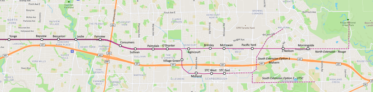

If any line is to be split in two at the end, I think it should be this one. Both branches are closer together and would probably not require full service, but the section from Yonge to Pharmacy will hopefully grow to warrant 3-4 minute service. Alternating branches can remain on Sheppard or detour to Scarborough Centre. The issue with extending the Sheppard subway further west is that Sheppard is fairly constrained when it comes to redevelopment potential as is. East of the GO tracks you have more backyards fronting onto arterials, and those areas would be more suited for a lower frequency.... the line could be brought above-ground here, or be transformed into a TTC gauge Crosstown-like service.
It is more economical to build one branch and run 100% frequency, then to build two branches and run a 50% frequency on each branch.
If you can find a way to go over highway 404 (i.e. just south of existing vehicular bridge), then pretty much everything you show is elevated. It's much more affordable to have branches if they cost $100 to 150M/km and not $500M.
I think the branching is possible if Sheppard becomes LRT of any kind. The trunk up to Pharmacy could be elevated, the branches with lower frequencies could be mostly at-grade.
If Sheppard is extended retaining the existing subway technology, or converting to OL type trains, then the per-km cost will be too high to create branches.
Both options have their pros and cons; if the Ontario Line eventually reaches Sheppard, then convertion of Sheppard to OL type trains will become a more appealing proposition. But if branches are desired, then it should be LRT.
Oh, and I should mention that I think the line should be converted to LRT in the same vein as the Crosstown, to maintain similar service on the current part of the line to what exists today, but I don't see how it would be completely impossible as a full-fledged subway.

Lots of lines have branches, from the different services on the NYC lines to the many branches of Boston's Green Line.
I think it should climb upwards while under the 404, but only emerge above ground somewhere between the 404 and Victoria Park Avenue. Line 4 is fairly deep, and around Consumers there is a lot of underutilized land that can be expropriated before we get a street wall on Sheppard. But yes, everything beyond that point, ideally, is above ground.
@north-of-anything curious why you positioned Sullivan station between VP and Pharmacy
The roads are only about 400 meters apart. Putting the station between the two roads would make both a very short walk from the station. It also allows for more space to bring the line above ground if Consumers Station is placed underground.
Michael Schabas, in the report that contained the "Scarborough Wye" suggest that it could be elevated before hwy. 404. I am not certain I believe him though.
In the report by Gordon Chong, they had elevations of the entire Sheppard line - except the portion from Don Mills Station to Consumers Station. So I have no way of confirming exactly what can be done.

I feel like if the Scarb RT/LRT or the one stop scarb subway was being built the option that goes down to STC and then up to Malvern would make the most sense.
However now that the subway is planned to Sheppard and McCowan, I feel like going there makes more sense.
I think that we can use the Eglinton East LRT for Malvern, and have it loop back and connect to McCowan. A Zoo spur could be built in the future.

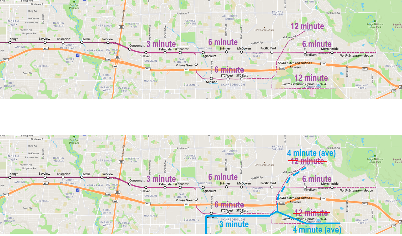

I did a bit of math, and the branches at the extremities are not getting much service. Once you're beyond 8 or 10 minute frequency, I don't think you can call it rapid, frequent, transit. Looking at the Schabas "Scarborough Wye", it had Sheppard service overlapped with SRT service - creating more reasonable frequencies.
Though it might be said that 12 minute frequencies for Malvern is not really that out of question for the respective densities and transit mode share of the area. It certainly doesn't look off when looked at international comparisons.
But at that point I'd begin questioning the value of the branch and whether it's worth the capital investment!
I wouldn't suggest that both of the southern extensions be built! I called them Options 1 and 2 to kind of imply that having both would be too much. In fact, I don't think either south extension would be warranted if refurbishing Line 3 is on the table - just make STC a south terminus for Line 4 that has a transfer onto Line 3, and maybe even skip the Midland stop and go right to Village Green.
