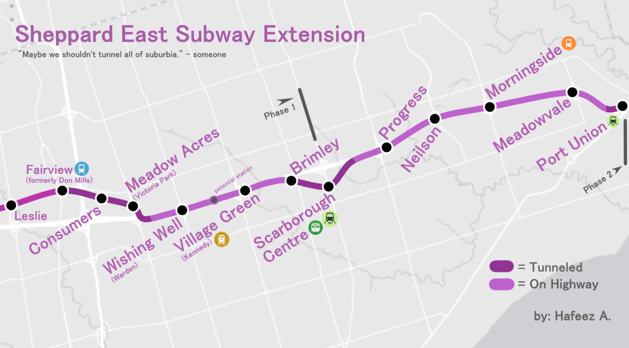

There have been many conversations on how to expand the Sheppard Subway east. Some say to build it underground to STC, some say build it aboveground on Sheppard, some say to convert the entire line to light metro or to replace the line with an OL Extension.
Here's my alignment. Basically running on Highway 401's express lanes removing one express lane in each direction, and running the heavy rail subway along most of the extension. This makes the line way more efficient and affordable to build. It'll be similar to phase two of the Confederation Line in Ottawa, so it won't be new.
The first phase would be tunnelled from Don Mills to the 401 stopping at Consumers and Victoria Park and rising to the 401 and stopping at Warden. It would continue east along the highway stopping just east of Kennedy and veering off the 401 for an open station at that massive field at Brimley. Then the line interchanges at Scarborough Centre with Line 2 where phase one would end.
Phase 2 (work in progress) continues and has a stop at Progress/Markham for a connection with Centennial College and buses, then potential stops at Neilson, Morningside and Meadowvale and could end at either Rylander (Abbey Lane) or Sheppard/Port Union.
I seriously think this is a really good option for the city/province to build transit a bit more affordably and could actually reduce drivers on the 401 with the conversion of traffic lanes. It'll be construction hell for a decent amount of time but I think it'll be worth it.
Pros:
-Less tunnelling compared to fully tunnelled extension to McCowan; more affordable and quicker building
-No disruption to Sheppard East
-More compelling for commuters to choose transit
Cons:
-Construction Nightmare on the highway and rebuilding some overpasses.
-Highway Stations at Interchanges can be difficult for pedestrians. This can be worked out by making interchanges less encouraging for speeding, -widening sidewalks, cycle tracks, traffic signals controlling on-ramps etc.
-Less potential for development and transformation on Sheppard Avenue East.
Consumers Station would be located underground on Consumers Road connecting with buses and the heart of the business park.
Meadow Acres (Victoria Park) would also be underground connecting with buses, the eastern business park and new developments!
Wishing Well (Warden) will be a simpler station connecting with the 68, Warden Hydro Corridor Trail and the local neighbourhoods.
Village Green (Kennedy) will connect with the 43, Village Green, Kennedy Commons and a potential Stouffville Station (read more below)
Brimley will be a cut-and-cover station on the SW corner of 401 and Brimley connecting with the 21 bus and massive redevelopments.
and Scarborough Centre will connect underground with Line 2, DSBRT and other various connections and POI's.
Phase 2 is still a work in progress for alignment and stations. Also a future station could be added at Birchmount to connect with the far-future Midtown Corridor and Birchmount Rd.

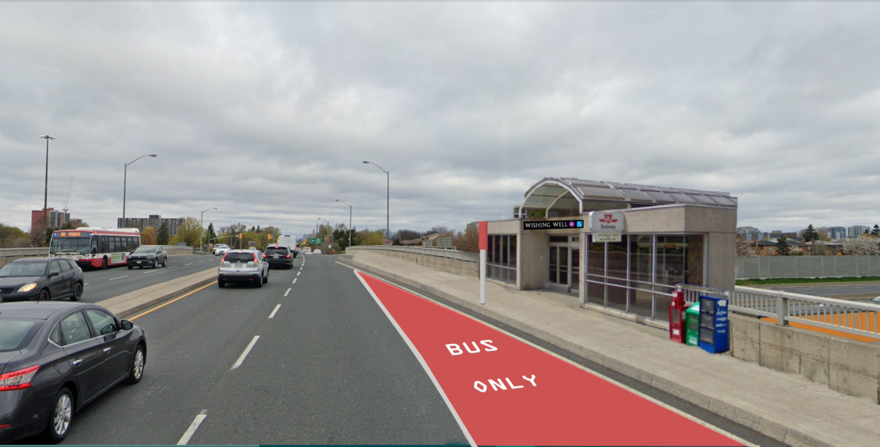

Here's a terrible photoshop of a station at Wishing Well (Warden.) Can you guess which station I stole this entrance from?

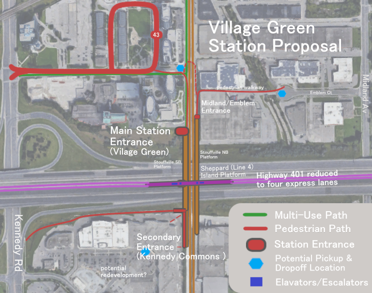

Here's a serious proposal for a station at Village Green (Kennedy) that would work hand-in-hand with a new station on the Stouffville Line and would seriously improve transit and active transportation connections in South Agincourt. Sure, there are encroachment issues but I think they can be worked out.

I have always wondered why a line above the 401 wasn't built. My question is how you plan on convincing a politician to do what is basically something that will ensure they will not be voted in again by suggesting removing lanes.

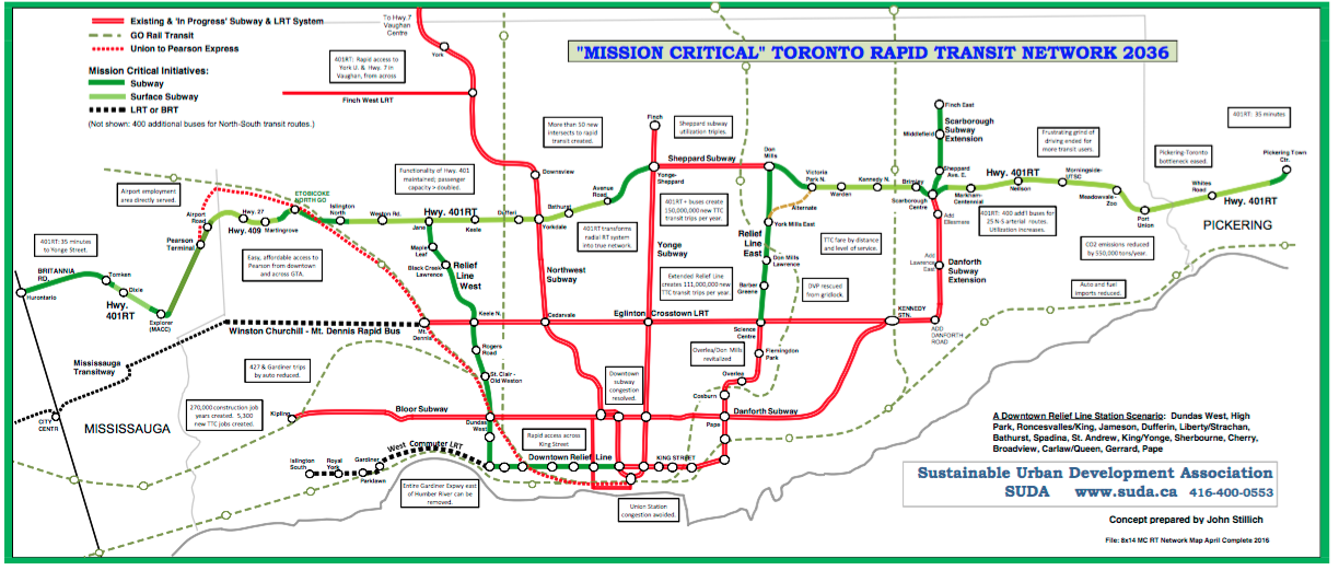

I just make mine in Paint.net and I think they look great:
View attachment 370581To be fair though, I just expanded on a TTC subway map I got off Wikimedia Commons and added a lot to it.
This is what I hope by 2050 the Subway map of Toronto will look like. It will look a complete and holistic system.
The Bloor line is extended westwards towards Mississauga City Center and eastwards Towards Markham
The sheppard line is extended westwards to link up with the bloor-danforth line and extended eastwards to link up with the university line.
The Ontario line is extended upwards to Don Mills to link up the Sheppard Line on the East end, and extended upwards from Exhibition linking up with Bloor line at Dundas West, Eglinton line at Mt. Dennis and Finch LRT at Jane and Finch.
The Eglinton line is extended westwards from Renforth to link up with Hurontario LRT.

The photoshop is from Lawrence West stn, I guess.

I think the 401 ROW is too valuable to waste on a subway line. It should be converted to an express passenger rail line after the Midtown GO line opens.

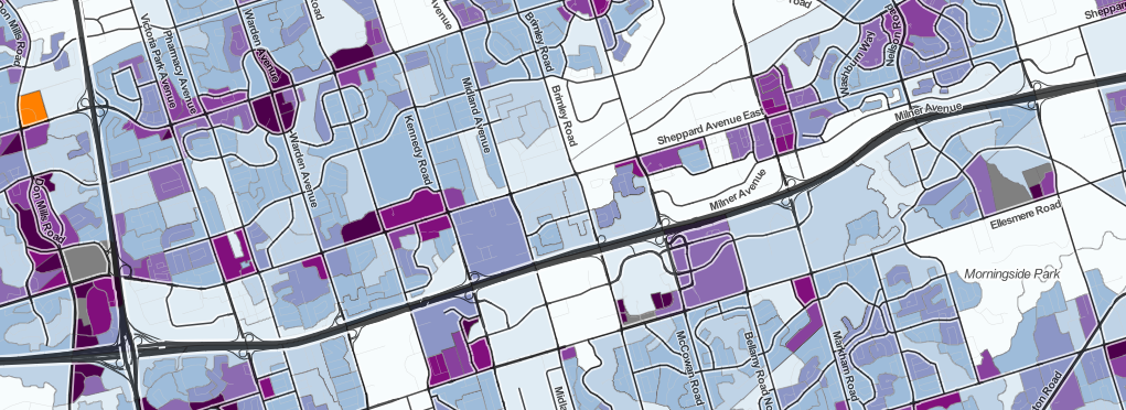

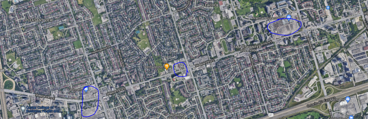

I'm not a fan of freeway alignments - while most ridership comes from buses, a subway could densify the Sheppard corridor, something it couldn't do if it was in freeway. Let's grab a density map:
The 401 alignment avoids basically all density, which is concentrated along Sheppard and Ellesmere.
I can think of three very good locations for TOD along Sheppard:
Pros:
Cons:
Thoughts?
There was this map I saw here a few years ago (page 291 of this thread) that had pretty much the exact same idea.
I don't think this is currently viable politically or otherwise, but it's intriguing nonetheless. Also make you think whether an Ontario Line West extension could eventually follow sections of the Gardiner Expressway/QEW and then head North on the 427 to YYZ. If they want to discourage driving this is probably the most viable way to do so, plus having the added benefit of much cheaper and quicker construction. Also there's obviously already a precedence with the Allen Rd. section of Line 1.
