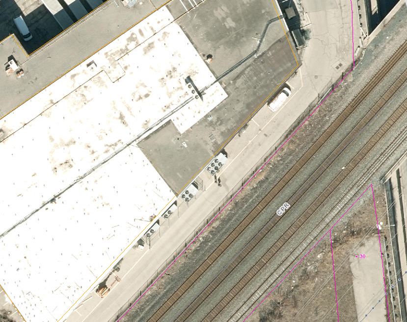

This is a shot of the ROW at Shorncliffe:
The pink lines are the property limits.
There are other probable and expensive land takings. (note that Shorcliffe is not a proposed station site, so one must displace a building merely to widen the ROW)

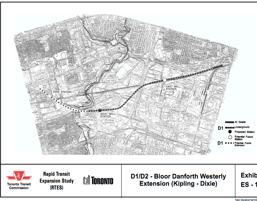

Routing, the options for any westerly extension of Line 2 were originally the subject of an EA in 1993. But a more recent report gave the once over to several options in 2001:
From the above:
Note the significant departure from the CPR alignment, and also that it has been planned almost entirely as underground.

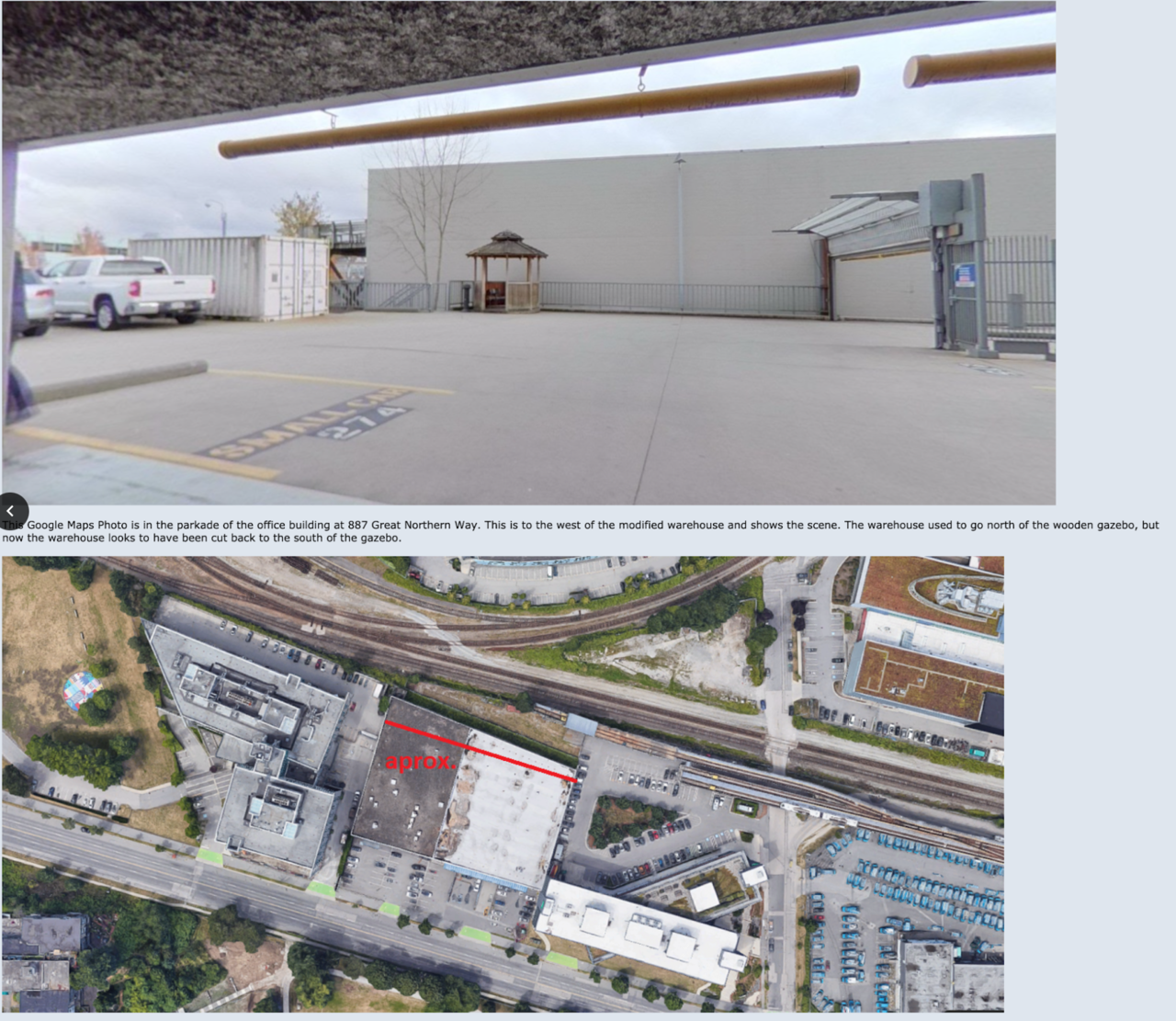

Since I think it would be interesting for viewers here, this was JUST done in Vancouver for the new Broadway Subway extension, also happening elevated along heavy rail tracks. Pics are from a Vancouver forum (a Gazebo is also involved):
So maybe being from Vancouver biases the way I see things, but technically speaking this all seems possible to me.

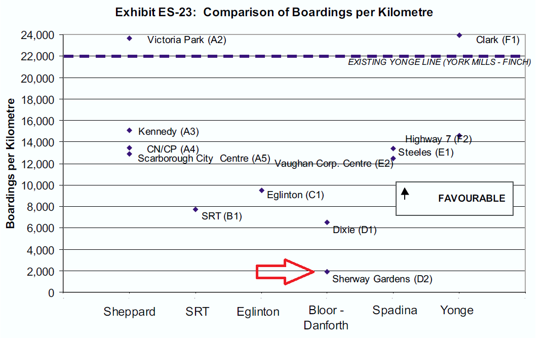

^ Does anyone remember how it scored on that assessment TO City Planning did back in the Keesmaat era?
Sherway scored very poorly - by far the lowest ridership of the many options they considered. The report is available here - https://transittoronto.ca/archives/reports/rtes2002.pdf
Thanks. That's helpful but it went back further than I was thinking. I was wondering if the Line 2 (West) Extension was ranked as part of Keesmaat's "Feeling Congested?" reports to Council. Looks like it was (the "Feeling Congested?" site appears to have been taken over by someone other than the City and the original materials are no longer available. Someone would have to search TMMIS to find them).
No mention of a Line 2 (West) Extension in those 2014 and 2015 documents (that I can see).
I did some further searching and there was a 2016 City staff report as well and it doesn't look like the extension was covered.
Start article here and it has a map from a staff report (haven't had time to find the original):
