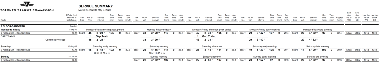

My post that you quoted had an explanation for "how". I shared my reasons why the number is excessive. If TTC needs 61 trains for this line, then in my opinion resources are not being utilized efficiently.
I was trying to be diplomatic so that you would check your math, where the error was clear,
You stated that:
It's a 26 km long line. Assuming a conservative average speed of 30 km/hr for trains, a round trip will take 52 minutes. Add a few minutes for turnaround and that makes it an hour for one full round trip
Your mistake is that you only included the travel time for one direction. It's 26.23 km in each direction. The average speed is about 30 km/hr! (actually 29.8 km/hr in AM peak pre-Covid - though currently they are running at 30.9 km/hr). So the one-way travel time is 52.8 minutes. There's actually no time scheduled for turn-around (which is odd).
So if it's about an hour for a one-way trip, it's about 2 hours for a round trip, not one (actually 1.75 hours).
So instead of your estimate of 40 trains, the number would be closer to 80 trains. As they are planning 80 trains for the whole thing, including the 7.5 km extension, then they are actually utilizing resource BETTER than one might thing!
Here's the last - pre-Covid schedule:
I remain concerned that 80 trainsets might not be enough if there's no plan to short-turn some trains at Kennedy, and that they can run better than every 141 seconds (25.5 trains an hour) once ATC is installed.
Simply put, station dwell time for passengers during rush brings the end-to-end speed well below 30km/h.
Deadpool is correct, that is the average speed - which includes station dwell time.
