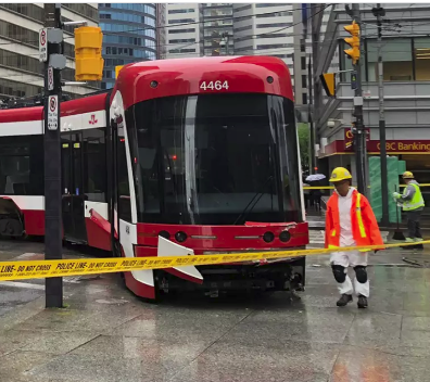

Addendum: Looking at the impact marks on the SUV, and where the impact damage was on the Flexity, the soft skirt *appears* to have contributed to the derailment by the impacted vehicle lifting the frame/chassis of the first Flexity segment as the vehicle was captured underneath it. Something as simple as a 'lower chassis attached bumper' that would prevent getting jammed under the chassis overhang (the impact of which is clearly visible half-way up the SUV door) and thus deterring lifting forces under the Flexity chassis. Those soft, plastic replaceable skirt cowls might be well-intentioned for pedestrian impact, but might have to be revisited. What you see on the front of the Alexander-Dennis latest low clearance DD buses is much more apt.
The down-side would be greater deflection of impacted vehicles, but given the risk of damage from a vehicle being deflected, vs tram derailment, it's a no-brainer. There's also the consideration of impact detritus sliding under the frontal area to then derail the trucks (bogies).

^Take a look at the front right wheel of the impacted vehicle. It jammed under the Flexity frame, and a very good chance it lifted it. I stand by my claim, that clearance gap is another derailment waiting to happen. Those SUV wheels are slightly higher than most sedans' but crushing onto the top of a sedan's slightly smaller wheels will also render a lifting force.

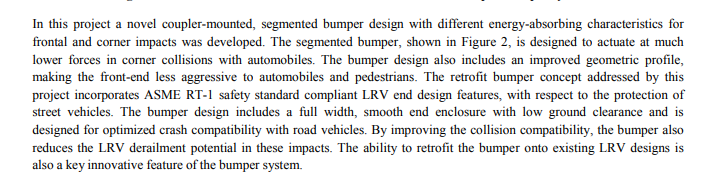

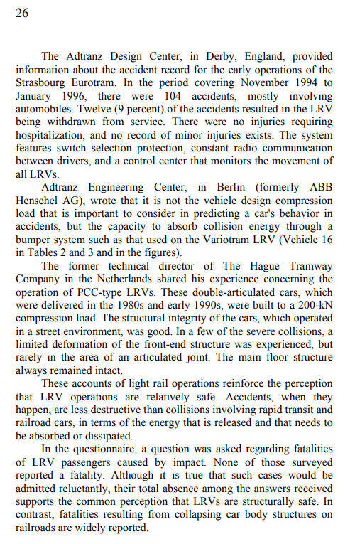

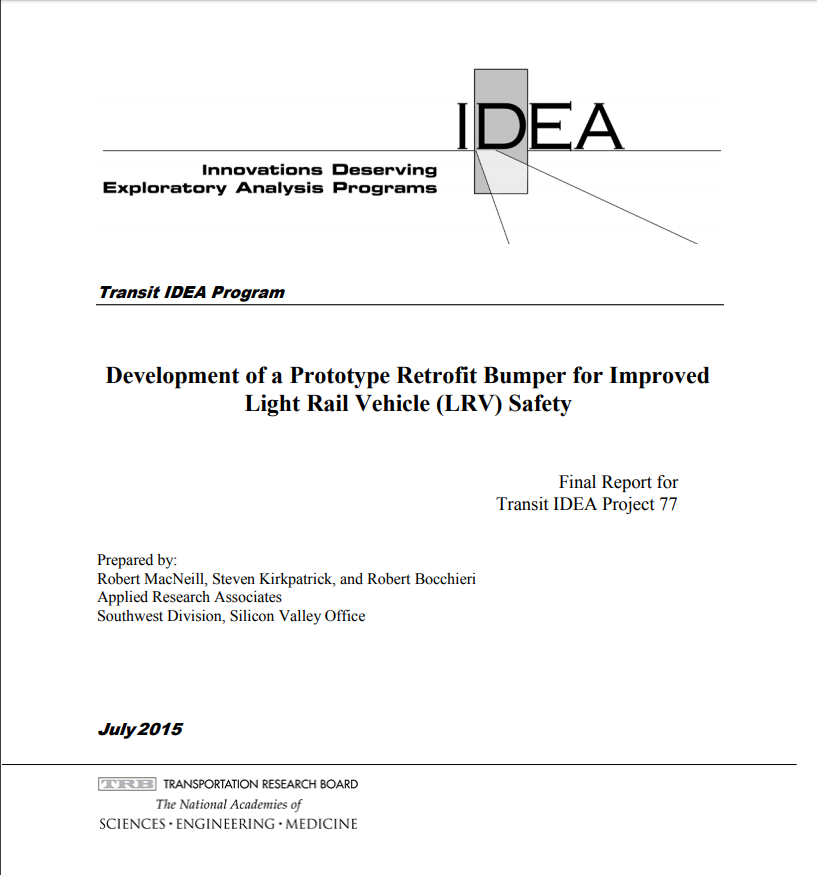

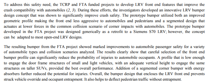

Some reference might be helpful, you can start here, but then again, it is Toronto and Region:
189990
http://onlinepubs.trb.org/onlinepubs/IDEA/FinalReports/Transit/Transit77.pdf
189992
189993
189994
This paper if 30 pages, be warned, it might cause thinking and introspection.
