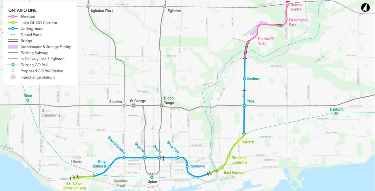

It's going to be fun seeing how big chunks of the Ontario Line will have to be shut down when incidents occur, because that line will have very few crossover locations.
Ah so it's one of those days in the TTC where there's incidents every hour on the hour huh? Was there some kind of mass release from the Toronto South Detention in the past few days or something, my goodness.
How many crossovers will the O/L have?
