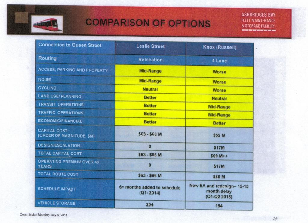

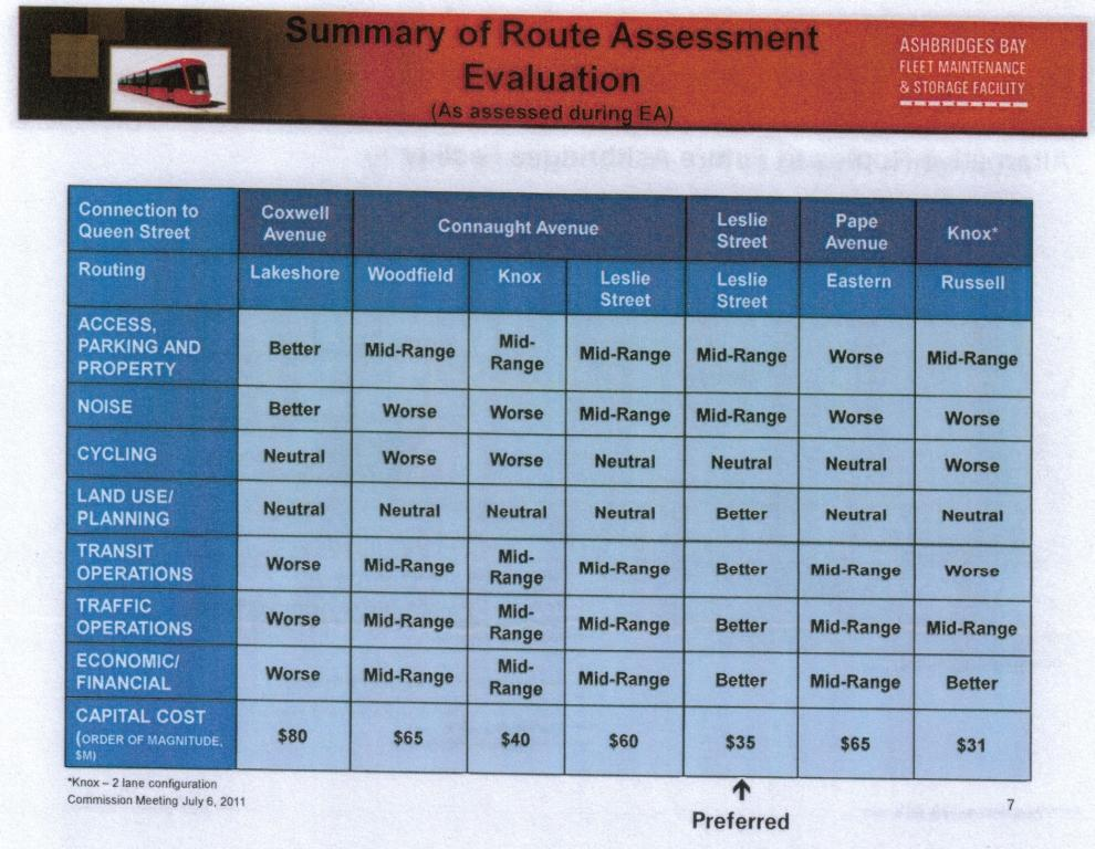

The Coxwell route was examined at the time and rejected early from further consideration. There are a couple of slides I found from Steve Munro's blog (https://stevemunro.ca/2013/04/13/the-saga-of-leslie-barns/) that seem to show how they narrowed their choices:
Additionally, both Knox and Woodfield were objected to by Canada Post due to their facility adjacent to both roads on Eastern. Woodfield. Information on that can be found in Steve Munro's article here: https://stevemunro.ca/2011/07/07/the-route-to-ashbridge-carhouse/
My own suspicions about Knox are drawn from the fact that it was the second choice. I believe they were considering routing cars through Russell so they would avoid the one way section on Knox. As a backup connection to Leslie it might encounter reduced opposition from Canada Post allowing it to be built.
I'd doubt Coxwell because it is long and that makes it expensive. Since this is a redundant connection to the network, it's already going to be tough to get funding.
