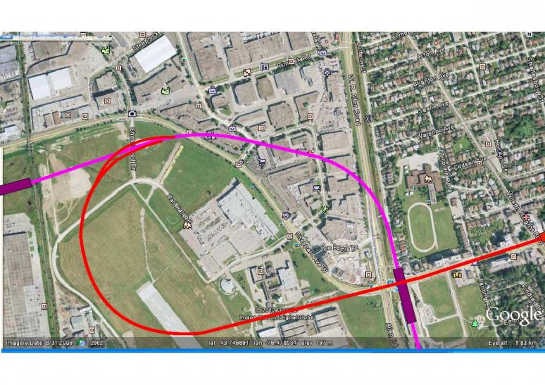

I suppose 1 other option would be to have the Sheppard interlined with the Southbound Spadina line. Instead of every second train short-turning at Downsview, every second train would turn Eastbound onto the Sheppard Subway. Then a westbound Sheppard train would take its (the train the would have short-turned) place going Southbound. The downside of this is that it involves almost a 270 degree turn with a radius of about 300m. (The Spadina line will have a 310m radius curve that is about 50 degrees to turn off of Allen Road).
There would be some issues with running 7 car trains on Sheppard. If Sheppard would run at half the frequency of the Spadina Line (at all times), then Sheppard line may not even need a Downsview Station (at Allen and Sheppard) since every Sheppard train would stop at the current Downsview Station. This would allow a Sheppard Station at Faywood.
PS. This would mean it is a one seat ride from Yonge/Finch to Sheppard/Don Mills. :)
It might be costly to add a new connection to the underground Downsview Park station. Plus, I am not sure if the subway is allowed to run under the Downsview landing strip.
If the goal is to interline Sheppard with southbound Spadina, then it should be easier to veer the Sheppard line south-west at the Wilson Heights intersection, and connect to Spadina line halfway between Downsview and Wilson. The line runs on surface there, and quite a bit of empty space is available to the east. If necessary, Allen Road can be just shifted 10 - 15 m east to make room for the subway connection.
Wilson would become the last common station, after that one branch would serve Downsview and continue to VCC, whereas the other would go to Faywood station and continue along Sheppard.
You are correct, this is much simpler. The Spadina northbound to Sheppard eastbound ramp would be just over 300m radius - the same as the "Allen curve" on the Spadina line just north of the current Downsview Station. The Sheppard westbound to Spadina southbound ramp would have to go under the Spadina line to join in from the west side.
