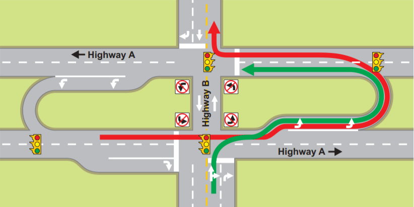

In the early plans for the Eglinton and Finch West LRT, there was discussions on the "Michigan U-Turn". REJECTED by the automobile lobby.
That's really frustrating, it's not like the Michigan Left takes up dramatically more space than the existing protected left turns. It seems like a fair compromise for drivers to me - you keep more of your left turns and in exchange there's a small delay with the additional signals and queuing.
The Michigan Left as designed does require a lot of space, and are generally found on wide medians as you have on Michigan state highways like Telegraph Road, 8 Mile Road, as well as Michigan Avenue and Woodward Avenue outside the City of Detroit.
For regular traffic you can have narrower U-turn lanes like you have on St. Clair, but they do not easily accommodate tractor trailers as would be necessary at certain intersections on Eglinton or Finch.
