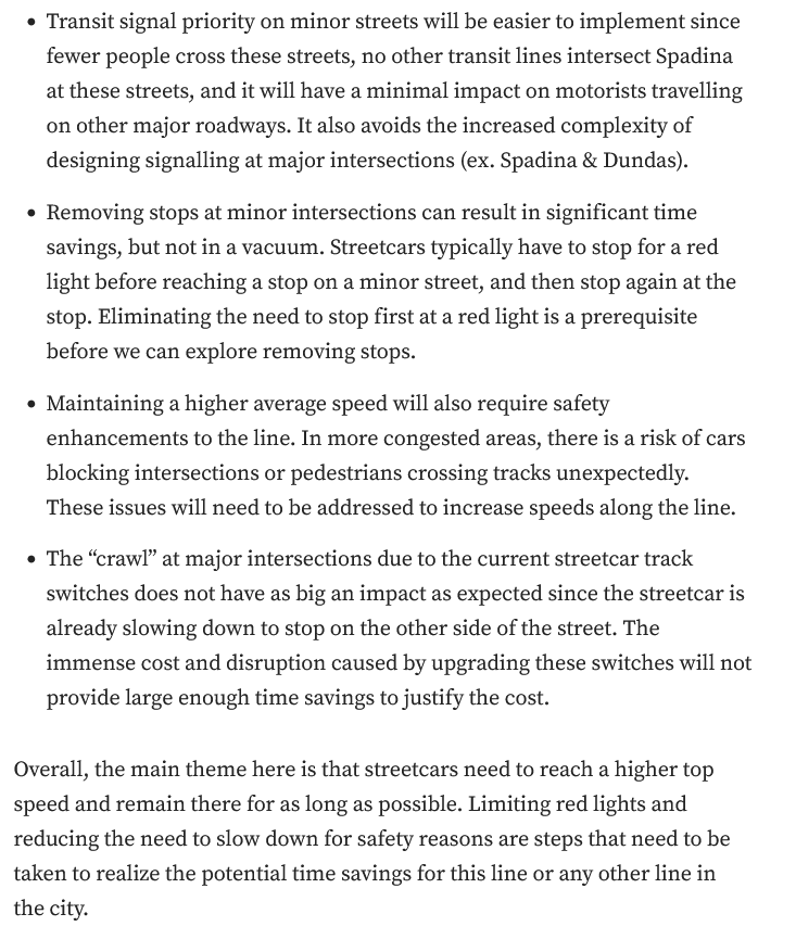

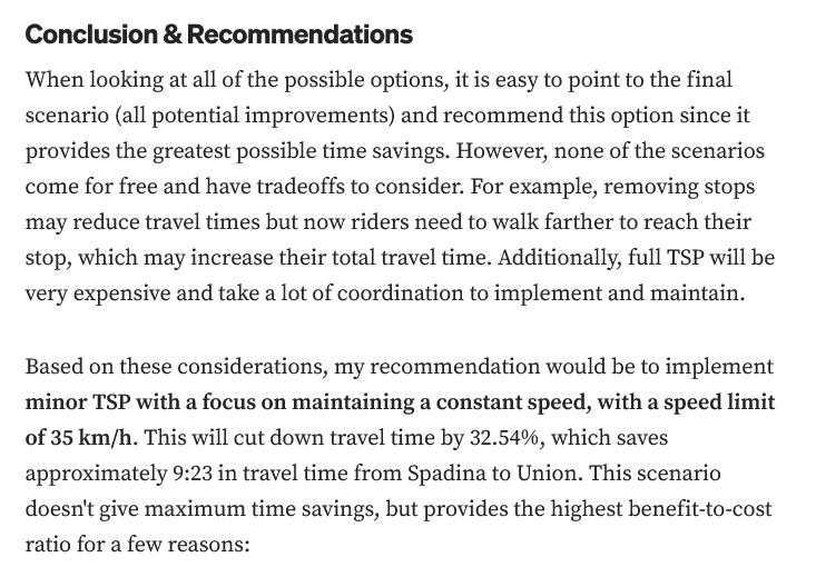

So .............. in the course of my internet travels.................. I came across something of interest in light of our recent subject here............(Spadina)
It actually dates from January '24, but I don't recall seeing it before............(perhaps I missed it or forgot it, if so my apologies) but a fellow named Paul Gallagher posted detailed modelling on different ways to speed up Spadina.
I searched his last name on UT and came up empty, so I'm assuming we missed this......
I'm particularly keen to hear @reaperexpress thoughts:
He modeled for reduced stops, greater transit priority and higher maximum speeds among other things.
I'm not going to pull forward all his detailed modelling, follow the link for that.......... but I will pull forward his final recommendations:

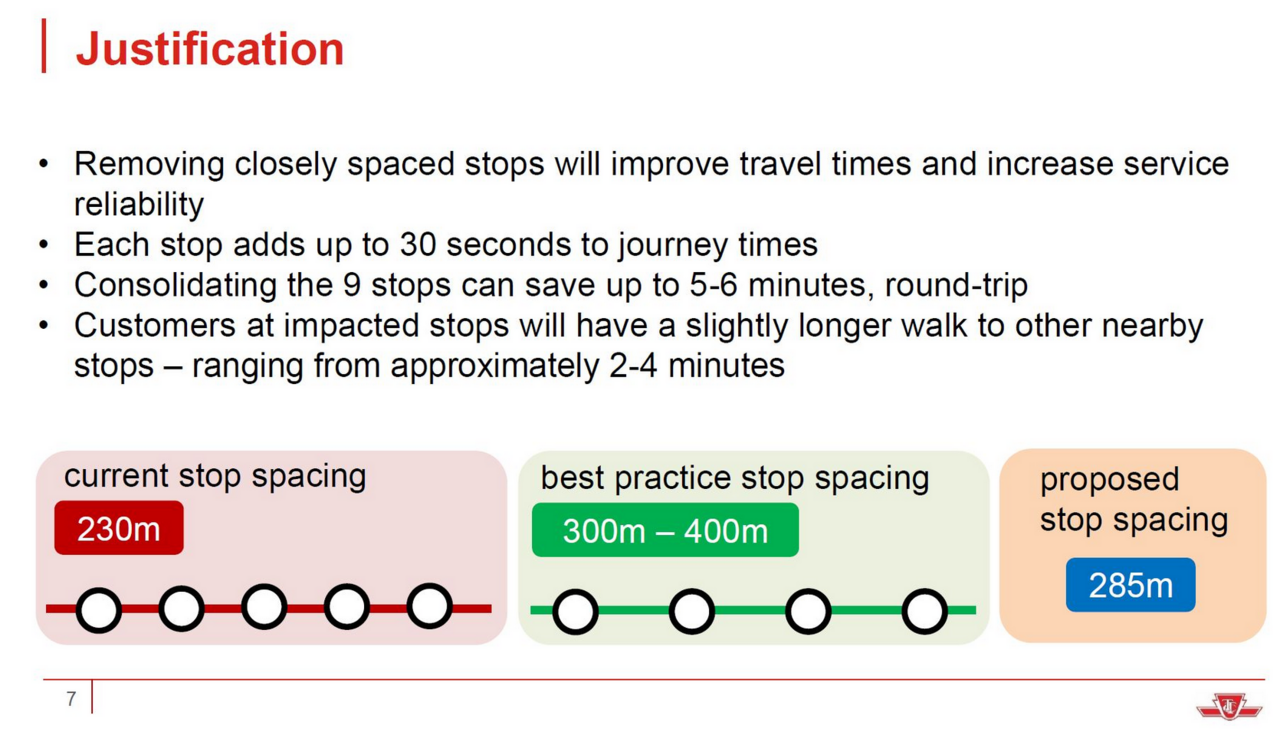

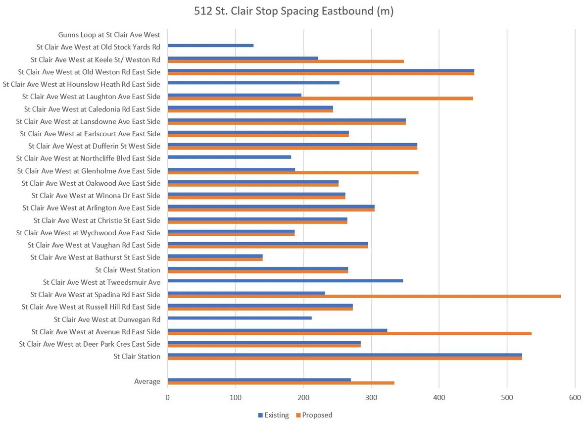

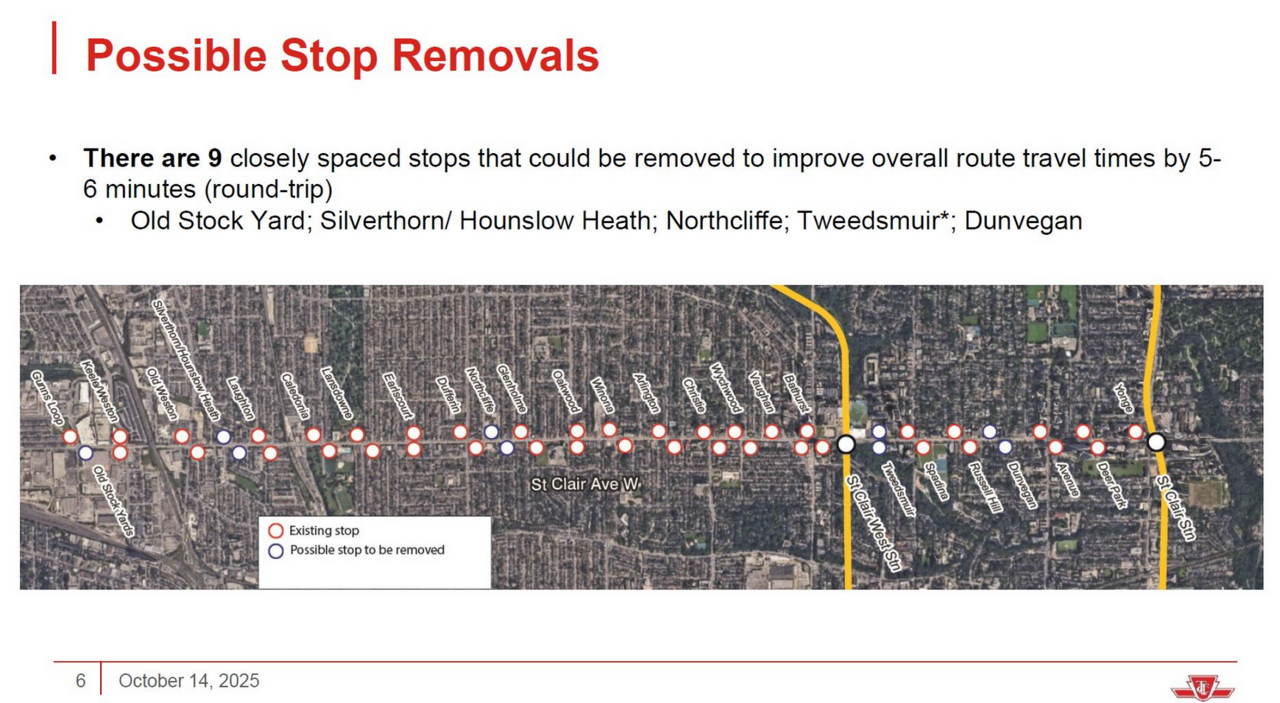

Steve Munro brought out in a recent post that the TTC is musing about cutting stops on the St. Clair LRT ............Yay!
Steve, I think is less enthused, but I like the choices, maybe in part because they come fairly close to mirroring my suggestions............with one notable omission.
I''m a very bit advocate for merging the Bathurst and Vaughan stops into one Bathurst-Vaughan stop. I find the stop absurdly close.
Link to Steve's piece:
It appears that they created a good model of the service. But most of their assumptions were incorrect, which makes the model results and conclusions invalid.
- The model incorrectly assumes a maximum speed of 25 km/h. The actual speed limit is 40, not 25. The 25 limit only applies within signalized intersections. There's also a 10 km/h limit over special trackwork, and a requirement to stop-and-proceed at facing switches, which are not mentioned in the description of the model, though the conclusions do mention switches, so I'm not sure if or how they've been modelled.
- The model incorrectly assumes a fixed dwell time of 20 seconds. The actual dwell time is actually correlated to the headway, so long dwells slow down the line much more than if the two variables were independent.
- The model incorrectly assumes that at each signal 50% of streetcars get a green light and the remainder get a random delay of 1 to 60 seconds. Normally delay in a coordinated signal system would not be random but on Spadina the dwell times on Spadina are so variable that I actually think it is reasonable to assume random variation in signal delay. The bigger issue is that the delay varies dramatically between intersection, but that is not reflected in the model. I don't have my spreadsheet of signal timings on me, but off the top of my head at College only about 16% of streetcars get a green with the remainder getting 1 to 75 s delay. Meanwhile at Sussex it's something like 56% green with 1 to 40 s delay for other streetcars. And that's all assuming there's no TSP, but there is TSP at Sussex but not at College.
As is standard practice in traffic models, they fudged the numbers to get the baseline travel time to match reality. They accidentally included less signal delay and switch delay than there actually is, and compensated for that by setting the speed limit lower than it actually is.
I'd love to see what the model would produce with the input parameters corrected. It seems well designed, so it could potentially be a useful tool with relatively minor adjustments.
Odd they keep the two closest together stops - eastbound Bathurst and Vaughan.
The fact that the TTC is even considering this is pretty astonishing. I dont know what sparked this but whatever it is, it's refreshing to see.
Now let's see if all or even part of this gets implemented, and can get through residents in the area who will no doubt bring pitch forks to protest this.
