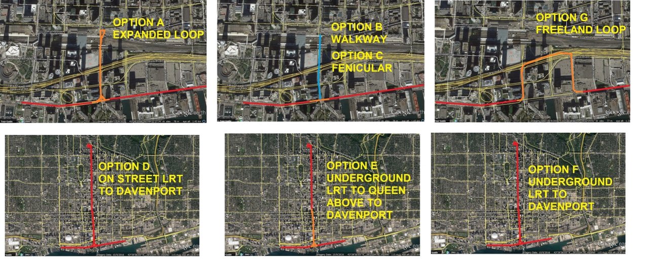

What every transit project should look at is the "bang for the buck". It is essential to know what the "bucks" are - as those should be able to be determined reasonably accurate. The "bang" depends on ridership projections, as well as transit rider desires, and it harder to quantify accurately. Here are my cost estimates:
Option A. Expanded Loop ($275M).
QQE portal ($25M) and Interchange ($50M) and Loop Expansion ($200M).
Option B. Underground Walkway ($100M).
QQE portal ($25M) and Interchange ($25M) and walkway ($50M).
Option C. Underground Funicular ($150M).
QQE portal ($25M) and Interchange ($25M) and funicular ($100M).
Option G. Freeland Loop ($235M).
QQE portal ($25M) and underground track (900mx$150M=$135M) and underground station ($50M), and underground intersections ($25M).
Option D. On street LRT ($290M)
QQE reconstruction ($25M) and 3.5km onstreet (3.5x$75M = $265M)
Option E. Part underground LRT ($600M).
QQE portal ($25M) and Interchange ($25M) and under subway ($150M) and part underground track (800mx$150M=$120M) and 3 stations (3@$50M=$150) and Queen portal ($25M).
Option F. Fully underground LRT ($1050M)
QQE portal ($25M) and Interchange ($25M) and under subway ($150M) and underground track (3kmx$150M=$450M) and 3 stations (7@$50M=$350) and underground loop ($25M).
If service is only to Union Station - I would say the Freeland Loop (option G) would be the best. The "bang" of each of these is in the same order of magnitude, although likely Union loop is best, followed closely by the Freeland Loop.
If service is to continue through downtown, then the cost vary substantially. The service would also vary substantially since, even if Bay is closed, there are some heavy east-west routes that would slow things down.
Thanks for taking time to think about it and make the sketches, but Options E and F do not seem doable. The current streetcar tunnel ends at the same level as the subway tracks, rebuilding it to go under the tracks would come with an astronomical cost, for a relatively small number of riders.
Viable options are A, D, and G. Option G looks interesting, although it may be no cheaper than A while being slightly less convenient than A.

As I stated in the past, both current option for B & C where looked at in detail during the study and were rejected like they should be today.
As for BurOak 6 plans, A & D are the only 2 options that will work.
Option D & F would require Bay St to be dug up to replace the current tunnel since it will have to slope about 60 feet down from where it is to get a new platform under the subway. You are digging up Lake Ontario since this area was where the lake used to be back in the 1800's and was fill in because of the railway. Lake Ontario Shore line was Front St and the The Esplanade. The cost for this area alone is not worth the cost to take line north.
Option G has been looked a number of times during the EA as well the past 5 years and has been rejected by Metrolinx for various reason who is not willing to work with the city on having a combine transit hub for their new bus terminal location.
