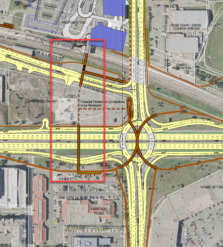

This will never, ever be built as designed. It checks Calgary's box for a unconventional one-off interchange design that consumes as much land as possible that is a design local requirement, but is otherwise outdated and impractical.
Bonus points for the engineer who thinks a triple-stack pedestrian bridge over an interchange is feasible or useful. That's like a +60 level bridge - will never happen!
Of course, just because a wildly impractical design won't happen doesn't mean it's not on the books and can't screw up all the development potential nearby as we see occurring. The city should scrap the whole thing and either sink McLeod Trail down or keep at-grade and spend about 1/10th of what this will cost to actually pedestrianize these arterial car sewers with half-decent sidewalks, reduced slip lanes and free up development lands for real development.
Given the elevation profile of the site, it is less unreasonable.
It looks like they will be reviewing pedestrian connections, and have a potential plan similar to my suggestion. If they implemented this pedestrian connectivity to the Heritage LRT station, there would be some hope for the area. The development at Heritage Plaza wouldn't be TOD, but at least Transit adjacent, and that would still be far better than what it is today. Even better, maybe someday the city will get it's head out of the sand and build the TOD proposed in the diagram.

I might be missing something, but this doesn't make sense to me. Heritage Dr isn't high flow, and there's lighted intersections both north & south of here. I would think that MacLeod would want to be more of a boulevard and less of a stroad - this interchange would move in the opposite direction.
Roads Dept: “Quick!! He’s onto us! Shut him down!”
I live in Haysboro and would love to see some improvements to the area around Macleod and Heritage. I feel bad for those who bought in the London buildings thinking the other two towers would be built and the area around be redeveloped. Horton Rd. is nasty. If this project at Heritage Plaza goes ahead hopefully it'll spur some other improvements around here. Though I'm not sure a big interchange will help. Instead of an interchange could they have Heritage go under the tracks on the west side of MacLeod?
I don't think they could. Heritage still needs to connect to Macleod, which means ramps and that awful mess we see in the diagram above. And, there's the additional challenge that Heritage goes up a hill to the east. This is why I think putting the tracks in a trench is the best solution.

Macleod is a lost cause as it is too vital a commuter route and is already suburban strip mall hell. The primary benefits of the Heritage interchange would be grade separation from the LRT and CPKC freight rail, and improved access to Horton Road which could potentially enable TOD. Carrying Heritage over Macleod is likely of small incremental cost and may be the only feasible option given the grades.
Some form of grade separation might make sense as part of the transit-grade separation project - but if it's hard today for the area to be attractive to TOD, imagine trying to locate next to an elevated free-flow traffic circle with swooping curves and a 50km/h minimum design speed, 10m above the ground out everyone's 3rd and 4th floor windows. At the very least, reduce the footprint and design speeds of everything in the interchange to tighten stuff up.
TOD is about championing land development potential and pedestrian connections near transit - the current and proposed future state are not anywhere close to achieving this. MacLeod is hardly a lost cause - TOD can be successful on big, loud roads too - but not when 40% of the land is taken up with a design like this.
Would that mean a complete redesign and do-over to Heritage station? I assume so as Heritage Dr. is right next to the station.

Yeah, they would need to move or rebuild Heritage station. But I don't think any land would need to be purchased.
The TOD potential is mostly on the west side of Macleod, mainly along Horton Road
IMO there's an easy and exciting solution here...
  • Build an interchange where Macleod runs as it is, Heritage goes over Macleod and the tracks
  • Backfill the Northeast, Southeast, and Southwest corners of the interchange
  • Stop Horton Road at the bottle depot and turn it into a cul-de-sac, it can be accessed by the very capable Macleod and 86 Ave intersection
  • Cap/cover over Macleod from the edge of the Minit Lube to the access road to the Spirit Halloween big/small box store strip mall thing in the Northeast corner. I mean just look at this:
The city can put in their traffic circle for people entering/exiting Macloed but it will feel much different to the TOD as from the surface what you see is a traffic circle. You lose the ability to make this section of Macleod a Mainstreet but the trade-offs of a walkable, green, interchange that makes TOD here a pretty intriguing proposition.
