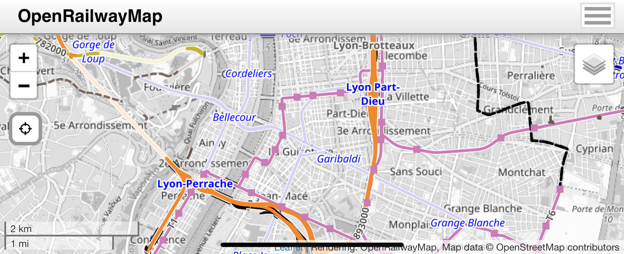

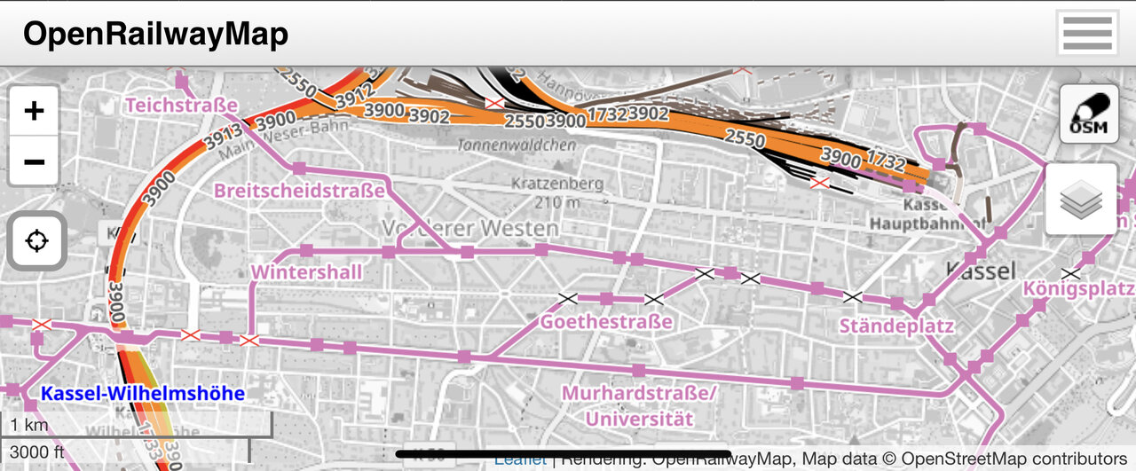

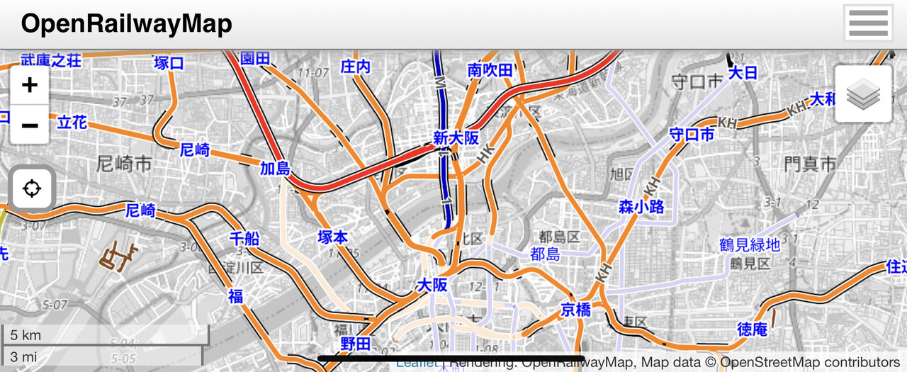

To quote myself from groups.io:
This might be true for near-downtown stations which are nevertheless transit and local rail hubs. Shin-Osaka, Lyon Part-Dieu and Kassel-Wilhelmshöhe are such hubs and reasonably close to the respective downtowns. Dorval and Kennedy are neither and I struggle to identify any other locations which could possibly serve as such near-downtown termini…
In a previous post on groups.io, I also wrote:
[…] At the same time, serving downtown stations is one of the biggest competitive advantages of intercity rail over the plane.
Personally, I live along the green Metro line, approximately a 30 minute journey (door-to-door) away from Gare Centrale and my office in Toronto is literally across the street from Union Station. I therefore leave home 45 minutes before the train departs and can continuously work for the full five-or-so hours I'm sitting on board the train until I'm only a five-minute walk away from my office. If you reduce the travel time of the train from 5 to 3 hours, but add a 30 minute transfer on both sides of my trip (because my train no longer goes from downtown Montreal to downtown Toronto, but from, say, Dorval to Pickering), then you've cut 2 hours from my productive time, but only a single hour from my actual travel time. And even worse: research suggests that forced transfers add a penalty of 15 minutes to perceived travel time, at which point my perceived time saving is only half an hour.
You can therefore believe me that there are very good reasons why cities all over the world have been investing countless billions over the last decades to move their intercity rail terminals closer towards the city centre rather than further away, as even though having suburban stations (like Dorval, Oshawa or Oakville) is a very useful feature, not having a downtown station is a fatal flaw. […]

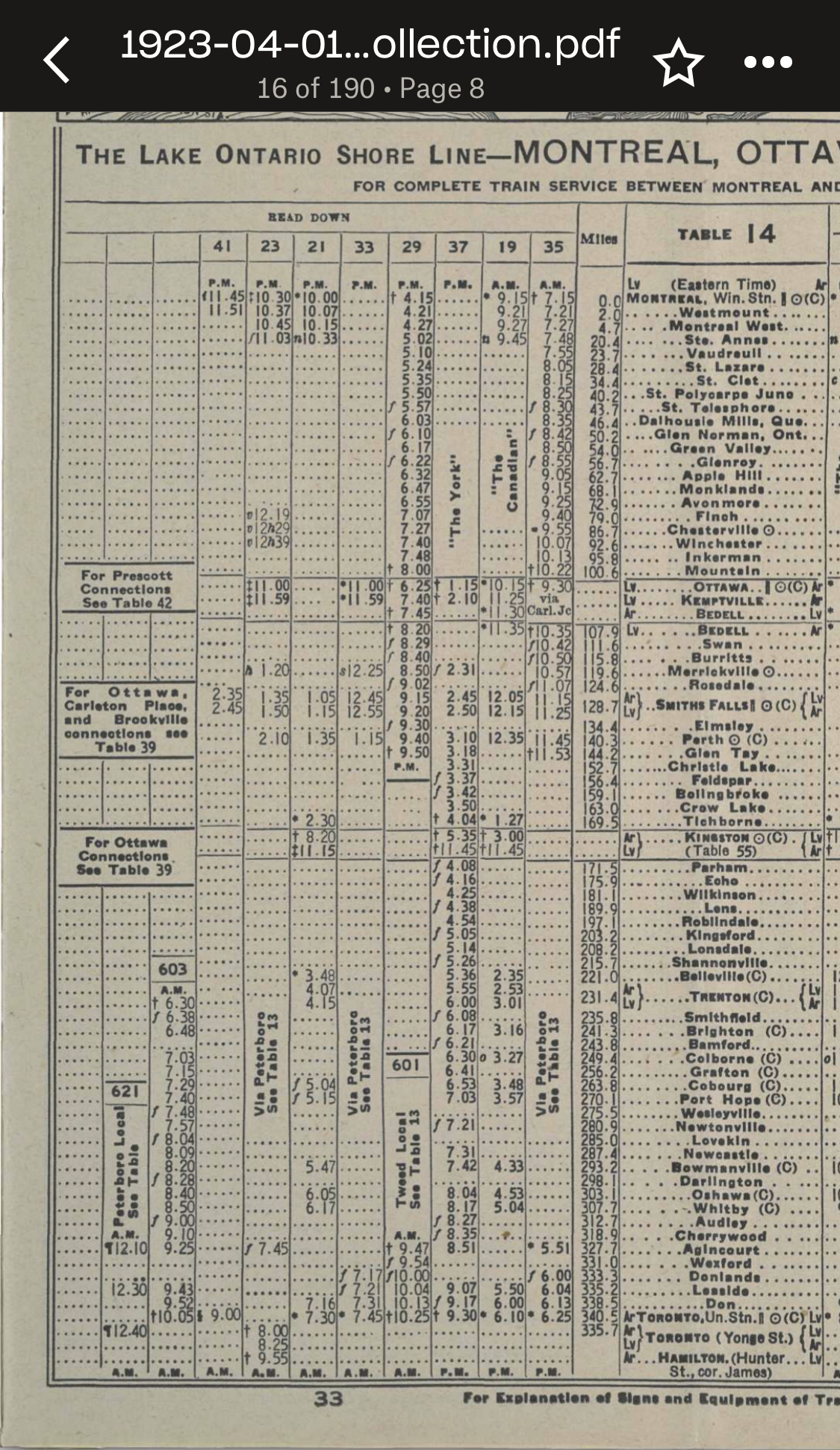

There's better options on the subway network. As someone mentioned above, the old CP station (Toronto North) at Summerhill station on Line 1 would be perfect. It's where CP's Peterborough-Ottawa service ran to, many years ago.
LOL, 107-96 years ago and until what exactly opened?
I love the building and could see it repurposed for some transit use. But not this. You are speaking of a major terminus if used for HFR. I cannot see myself jumping on a VIa service from London, taking the subway to Summerhill to catch a train to Dorval…..And where, besides TTC subway and local TTC horse and buggy service, do other transit players connect.
