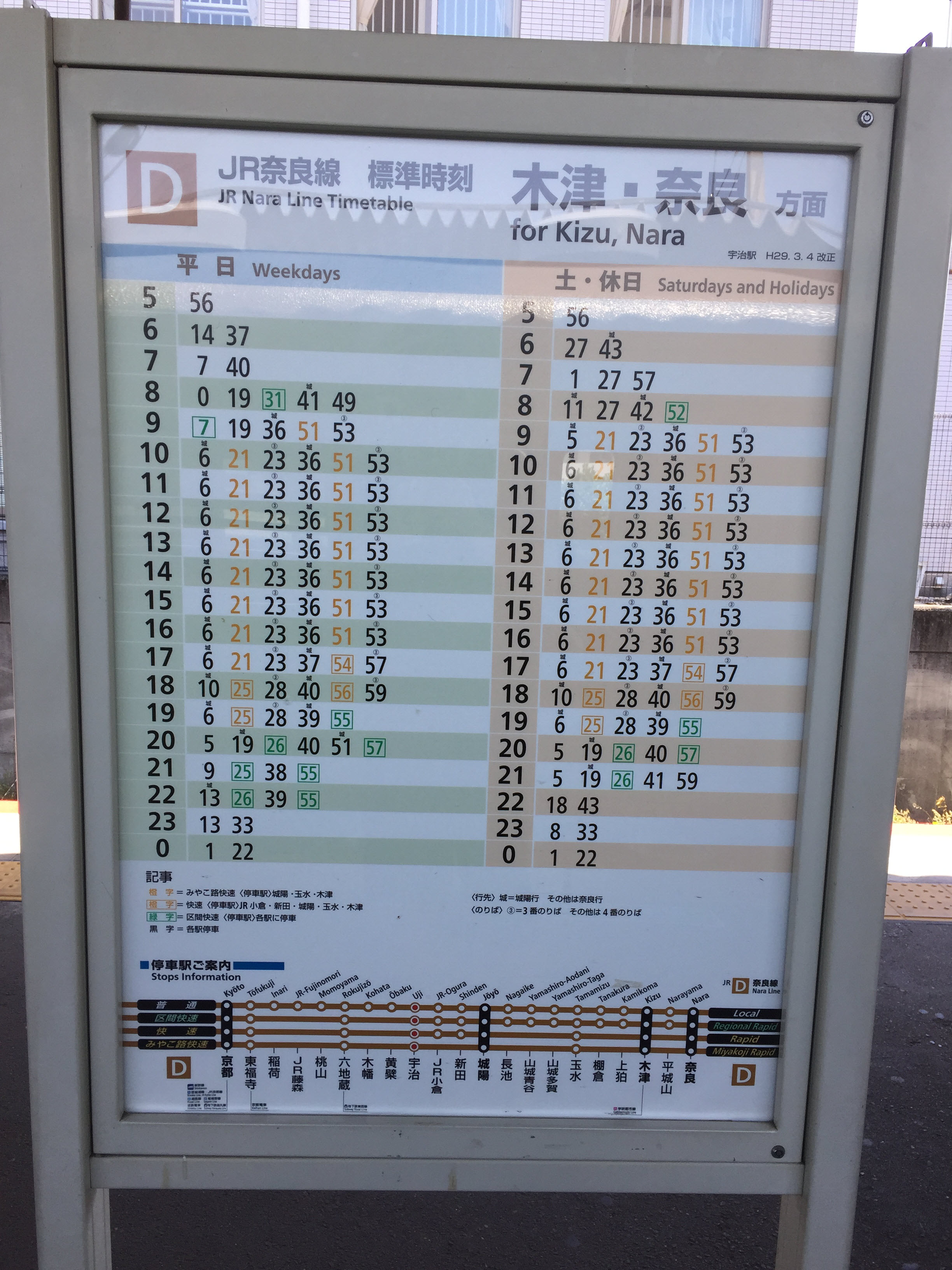

I can confirm that many of the Shinkansen stations in Japan have passing tracks in the center. Passing trains just zoom by while the stopping train gets rocked by the pseudo sonic boom. It can be done, they have 5 min headways at times as well

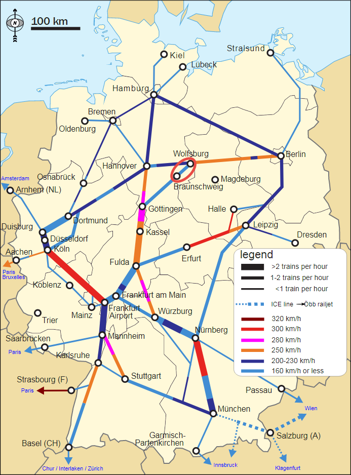

I found the note my friend left me on the ICE:
ICE, Braunschweig-Wolfsburg (One ICE and one RE (Regional Express) train per hour and direction):
This is the timetable with 6 trains per hour and direction (the orange trains overtake the preceding train at Uji) on what is a single-tracked line between Momoyama and Uji (all stations equipped with passing loops, but single-tracked sections are up to 2.2 km long):
He had drawn a map which I can't find at this time, but the former attachment above displays it circled on the official map. I'm still looking for more examples.
