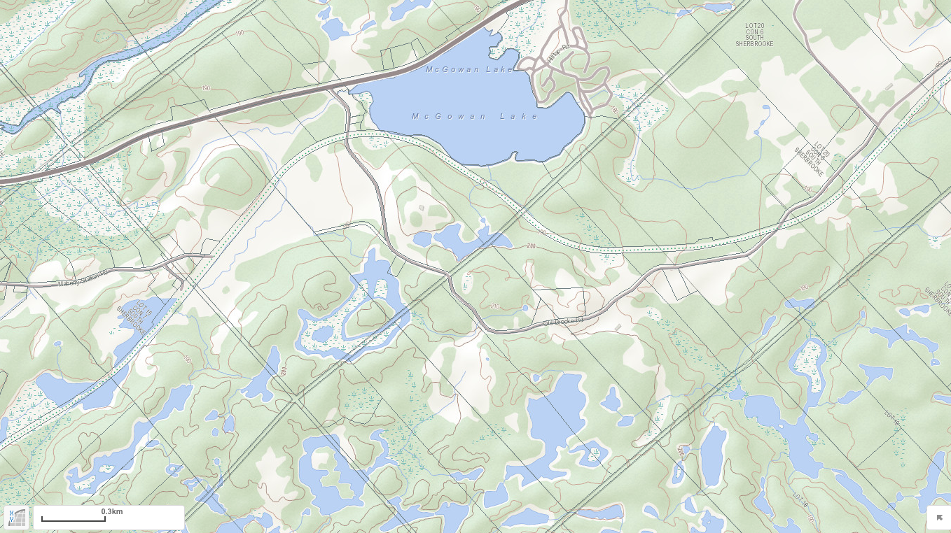

Here is a map from a June 29, 2017 VIA meeting with Frontenac County
So they want a stop at Eglinton eh? Here's what the area looks like at the moment. I'm going to cross post this in the Crosstown thread to see if folks there have a reaction. I can't remember if a rail-LRT connection was looked at during the Crosstown LRT study process. Wonder what CP would want to put a station there? The addition of two dedicated tracks including bridge expansion?
2vyR2hv
Really, HFR will stop at Tweed and Sharbot Lake? those are tiny little villages. I hope they only make a few trains a day at most make those stops.
Also, Eglington, Really? Its Eglinton.
