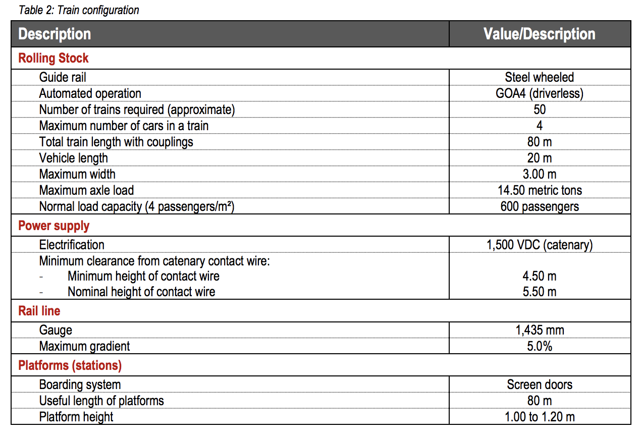

Note the train length appearing in the rendition, and this is appearing in others too. This is not what was originally touted. The original plan called for 'single pods'.
You're wrong. Since the inception of the project, the REM trains were always planned to be up to 4 cars long (80m), just like in this rendition
Is that the ultimate length? That seems rather tiny, particularly for such narrow trains.
Narrow? They're 3m wide.

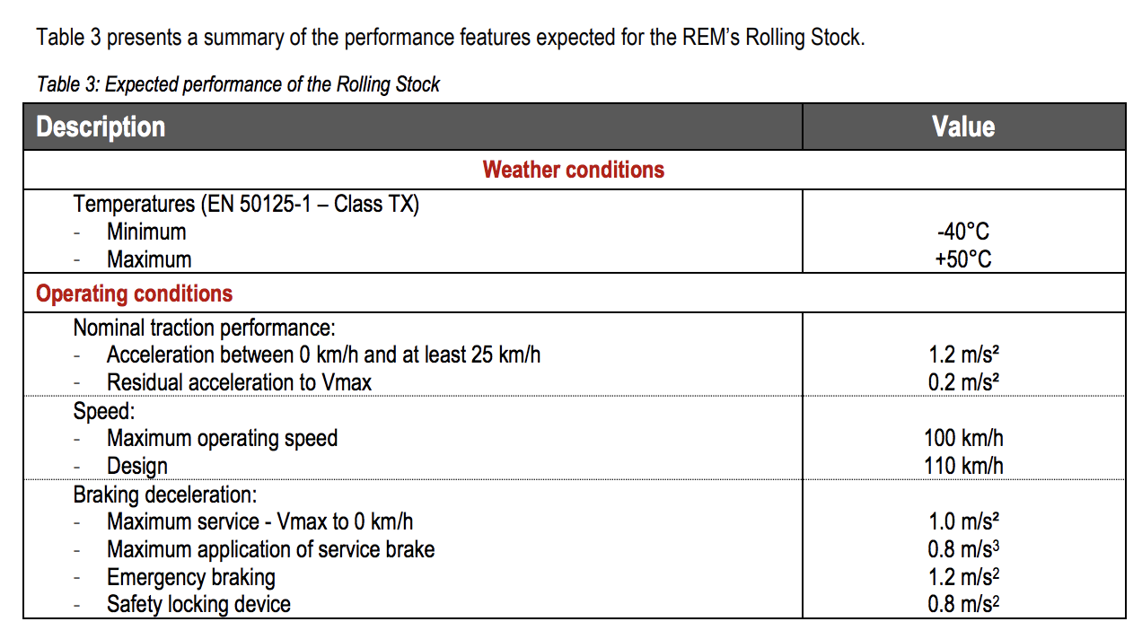

600 passegenrs * 90 sec headway = 24k pphpd. That's a fairly large max capacity.
Oh ... what vehicle is this then? Someone posted the picture of the Citadis Dualis, which is only 2.4 to 2.65 metres wide.
Still, if they are on these type of tracks, why isn't the width equal or greater (given the ability to bend around corners) the average subway car width of about 3.15 m?
Ninety second headway is hard to do. Particularly for a network like this, where there's going to be a huge number of people exiting at Central station.
The frequency is only as good as the time it takes to traverse the busiest station. Unless they are willing to build extra tracks at certain stations.
But if they do, 24,000 is good. But I'm surprised they wouldn't go for a more normal platform length - if only for protecting for future redundancy.
This is just four cars? Fitz' musing on the width is justified.
