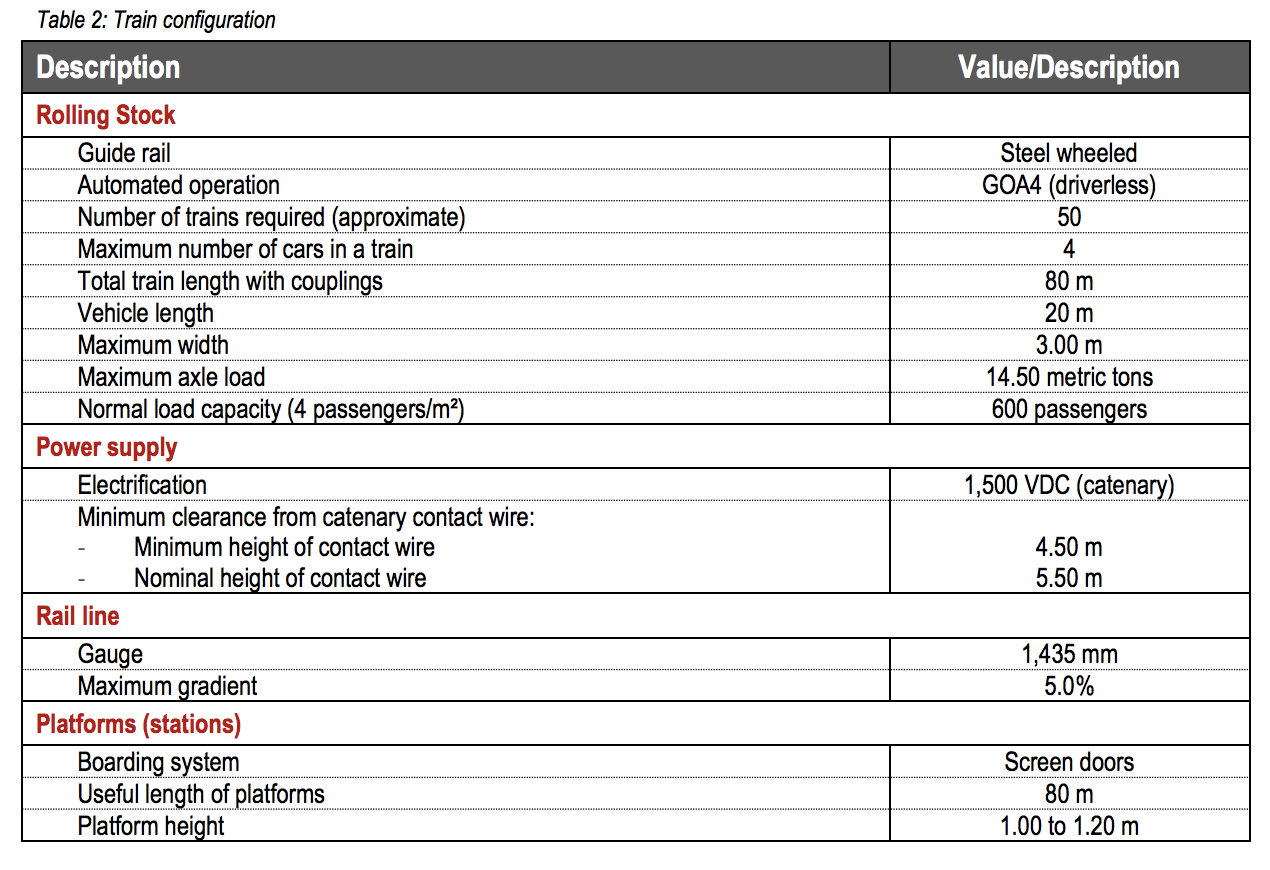

Btw: Have REM themselves actually stated vehicle width at the floor level?

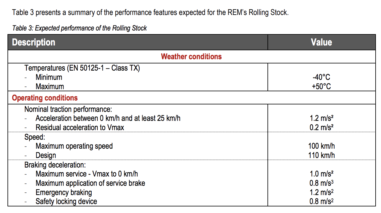

If you look at one of my previous comments, I posted the specs that rolling stock bidders had to comply with for the REM:
Check your reference closely. It states "expected". You haven't supplied a link for that chart. Where did you get it perchance? And when was it collated and posted?

The doc in question stating 'specs' is dated June 2016, far from being up-to-date. It's a 'guide' to submitting RFIs. Comment on "width" end of post.

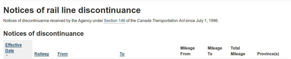

So where is the application to the CTA? I'm sure that's not just an oversight, is it?
Transfer and discontinuance of railway lines
How to transfer or discontinue a railway line
Under Part III, Division V of the Canada Transportation Act, a federal railway company must take these steps before transferring or discontinuing operations:
  1. provide notice in the company’s three-year plan for at least 12 months of its intention to discontinue operating the line;
  2. publicly advertise the railway line’s availability or any operating interest that the railway company has in the line;
  3. negotiate with interested parties;
  4. offer to transfer all of its interest in the railway line to the applicable federal provincial and municipal governments and urban transit authorities; and
  5. notify the Agency if the line will be discontinued.
Learn more about how to transfer or discontinue railway line operations.
How the Agency can help
Upon application by a party, the Agency can assist by:
  • determining whether a particular trackage is subject to the transfer and discontinuance process;
  • ensuring compliance with the transfer and discontinuance process; and
  • ensuring that the railway company and an interested party negotiate in good faith.
Find out how to file an application.
https://otc-cta.gc.ca/eng/transfer-and-discontinuance-railway-lines
They're a guide:
In addition to certain criteria presented in Table 2 below, CDPQ Infra recommends the following for the REM train configuration:
[...chart...]
The configuration options for the Rolling Stock to meet initial and future demand, while optimizing use of the Rolling Stock, will need to be examined by the RSSOM Contractor.
Pg 58 https://www.cdpqinfra.com/sites/def...ifications_and_addendum_01-8001_mrsem-eng.pdf
