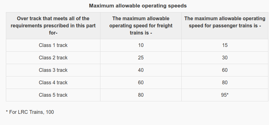

To start with, I would hope that the new trainsets would be cleared to 100 in “LRC 100mph” track territory,
Googling shows 110 mph allowed at one time on certain stretches of the Lakeshore Corridor. One wonders if that could be reinstated?
Addendum: Here's the best I could find on the books still, albeit elsewhere in regs is reference to the Minister granting an exception for higher:
https://www.tc.gc.ca/eng/railsafety/rules-tce54-832.htm

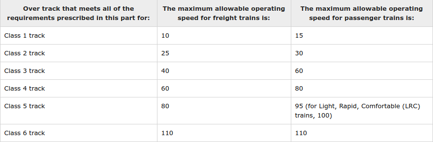

Further digging reveals:
http://www.bst-tsb.gc.ca/eng/rapports-reports/rail/2007/r07t0323/r07t0323.asp

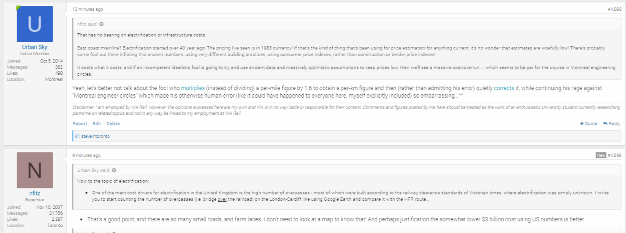

That has no bearing on electrification or infrastructure costs.
East coast mainline? Electrification started over 40 year ago! The pricing I've seen is in 1983 currency! If that's the kind of thing that's been using for price estimation for anything current, it's no wonder that estimates are woefully low! There's probably some fool out there inflating this ancient numbers, using very different building practices, using consumer price indexes, rather than construction or tender price indexes!
It costs what it costs, and if an incompetent idealistic fool is going to try and use ancient data and massively optimistic assumptions to keep prices low, then we'll see a massive cost-overrun ... which seems to be par for the course in Montreal engineering circles.
I would have hoped that having just been corrected on an otherwise human error (like it could have happened to everyone here, myself explicitly included) would make you slightly more nuanced on your own judgements about other engineers...
[Edit: rephrased and defused in the light of nfitz comment immediately below this comment, which he apparently wrote at the same time]
Now to the topic of electrification:
  • One of the main cost drivers for electrification in the United Kingdom is the high number of overpasses - most of which were built according to the railway clearance standards of Victorian times, where electrification was simply unknown. I invite you to start counting the number of overpasses (i.e. bridge over the railroad) on the London-Cardiff line using Google Earth and compare it with the HFR route...
  • That's a good point, and there are so many small roads, and farm lanes. I don't need to look at a map to know that! And perhaps justification the somewhat lower $3 billion cost using US numbers is better.
