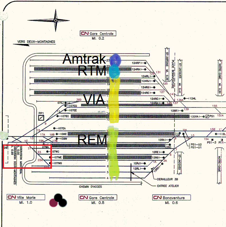

Secondly, staying southwest of the existing tunnel means that you would arrive onto tracks 7 and 8, which are reserved for storage by REM trains (which is the smallest issue), require a station entry on the western side (which will be expensive, but not impossible):
197441
Adapted from: track layout posted by @nephersir7 as post #3,566 (i.e. some 150 pages back)
The bigger problem will be, however, to exit the Gare Centrale on its eastern side, as it is completely covered by three separate massive building (Place Ville-Marie, the Queen Elisabeth Hotel and the Place Bonaventure) and would require the removal of a significant number of supporting columns:

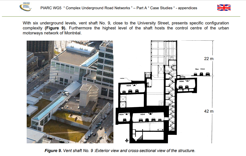

As for going below the current ROW, there is the slight problem that the Autoroute Ville-Marie (think of the Gradiner Highway, but well hidden in a tunnel) happens to be the most complex just at the eastern end of Gare Centrale:
197448
Adapted from: World Road Association
Just to give you an idea of how deep you would have to dig to avoid the Ville-Marie and Viger tunnel complex, it reaches until 42 meters under street level only 200 meters north of where VIA passengers leaving Gare Centrale view the daylight for the first time (exact location here):
197449
Source: World Road Association

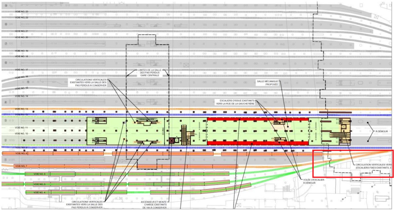

Here's a cross section plan from the 10 year old AMT study to build a commuter rail station under McGill College. (west is right).
We can see that the underground parking of Place Montreal Trust extends under the street.
There was enough space to add a third track to the west (A) , but that probably won't be the case with the REM station. Not to mention the southern bottleneck near Place Ville-Marie.
At this point, it's more viable to explore the idea of extending the tunnel on the eastern side, following a suggestion from the 2007 Champlain Bridge LRT proposal:
The technical viability of this idea is at best uncertain, especially given that the feasibility of an extending the tunnel north of McGill station wasn't assessed. All that's mentioned is that the terminal station would have been 5m under the western end of the metro station.
