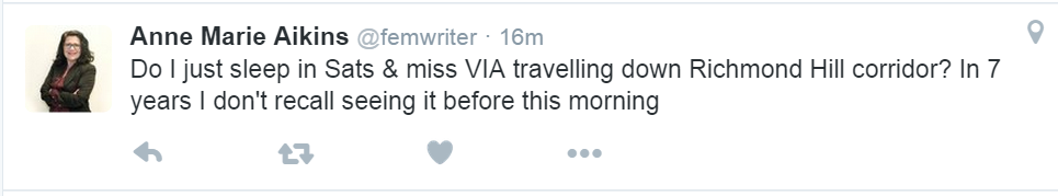

That would be a very late Canadian. It takes the Richmond Hill corridor into Union Station.
I can't deny that delayed arrivals of the Canadian at an extent of the 5 hours suggested here (or even more) have happened in the past, but it seems like it arrived Toronto less than 1 hour late yesterday, so maybe that Metrolinx spokeswoman was already up a lot earlier yesterday morning than you assume...
