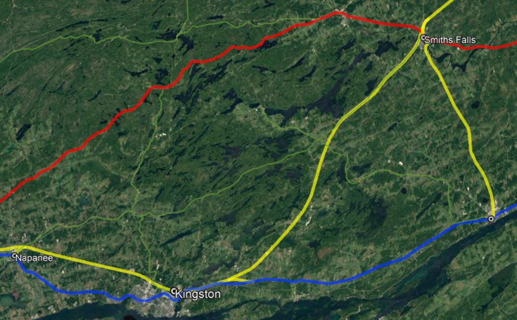

I too have also been known to promote a more southerly alignment in the past, as part of a 300 km/h high speed rail option.
Abandoned ROWs in faded green, CP in red, VIA in yellow and CN in blue.
I suspect the cost of a 200+km/h Kingston - Smiths Falls railway would be similar to the 200+km/h Kaladar - Smiths Falls line. The terrain is certainly easier, but it's also a lot more populated which means more road/rail grade separations, more expensive land acquisition and more political opposition.
Whether the southern route makes sense overall then depends on the intended speed. If the goal is 300 km/h high speed rail, then certainly the southern alignment makes sense - it's a lot easier to build there and can consolidate more of VIA's service onto the new line. But if the goal is only 110 mph at-grade rail, the prospect of reusing large parts of the Havelock ROW makes that option cheap enough that it probably makes more sense financially. Even with the costs of somehow getting VIA trains along and across the CP main line in Toronto and the need to continue running some service along the current CN route.
