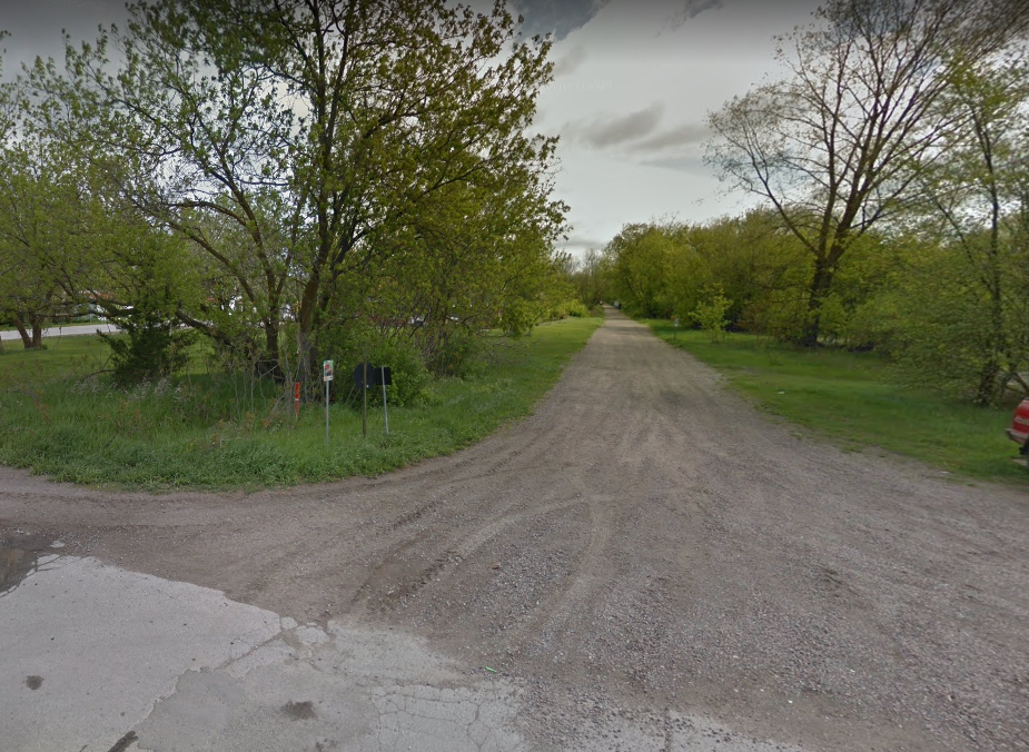

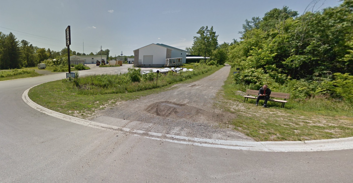

One other thing to consider, both around Sharbot Lake and elsewhere, are the number of private/public roads and driveways that have crossed the ROW, many most likely since abandonment. Depending on the speeds envisioned, level crossings would either need to be eliminated or signalized, which would seem unusual for a cottage laneway. Building alternative roads or even expropriation might have to be built into the costs.
No question, there will be a lot of this along the entire line. If one looks at Streetview, there are many tire tracks visible, and even some vehicles, on the ROW. It's hard to tell how much is "necessary" access versus pleasure driving. But again, a glance at the top map suggests the number of "stranded" properties may be fairly small, actually.... the one benefit of having built thru so much swampland all those years ago, perhaps.
