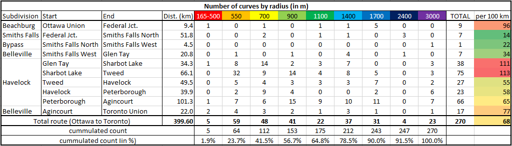

First, here's the summary of what I found in the document :
screen-shot-2020-09-08-at-9-22-48-am-png.268257
Translation: There are 86 segments where the as-exists curvature exceeds 1.5 degrees. At that curvature, a "typical" train would have to reduce speed to negotiate the curve. My assumed "typical" train is the equivalent of an LRC with tilting deactivated - ie, assumed track superelevation (banking) of 3 inches, and equipment with a "cant deficiency" rating of 3 inches. (I pulled the LRC specs from memory, and may not be accurate, but it's just a straw man anyways) The speeds shown under the "FRA 3 inch" collumn are the speed allowed by the US Federal Railroad Administration for that track profile. (Note that the length of the curve does not affect the restriction - although a longer curve will require holding that train to the restricted speed for a greater distance).
So, under this baseline, in the 94 miles from Havelock to Glen Tay, a "typical" train would have to navigate 3.8 miles at 47 mph, 10.6 miles at 53 mph, and 12.9 miles at 65 mph.
Of the remaining track, trains could run 42.9 miles at 95 mph+. Because of all the slow segments, there are about 23.7 miles of track that is straight, but is adjacent to the slow bits, so trains would have to be accelerating/decelerating through these segments. These segments while straight consequently must be considered "restricted" by all the slowing down and speeding up.
The question is, what can VIA do to improve on this? One solution would be to increase the banking of the curves and/or use a tilting train that can handle curves faster. The collumn "FRA 6 inch" shows the speed restrictions that would translate to "LRC train with banking operating as designed" - ie 3 inch superelevation, 6 inch cant deficiency. As you can see, if VIA either found a tilting train, and/or banked the curves more, speeds through all those tight curves would rise.

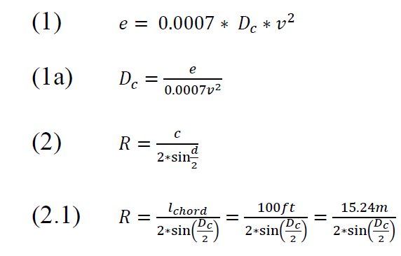

Railroads in North America generally apply the formula shown in Figure 19 to determine the equilibrium superelevation. Given that the formula does not treat actual and unbalanced superelevation differently, it is sufficient to determine one single value for the maximum permissible superelevation. While FRA regulations allow up to 3 inches of unbalanced superelevation and a maximum actual superelevation of 7 inches on Track Classes 3 through 5 [21], the limit of 5 inches of total superelevation used by Caltrain in California for their own urban mixed-operation rail corridors (Caltrain, 2011) seems to be a reasonable assumption to be adopted within this thesis.
Starting from the first equation provided in Figure 19, we can isolate the maximum permissible degree of curvature, which then becomes an input for a different equation (Calvert, 2004), which can be used to calculate the minimum permissible radius for the 5mph-increments shown in Table 17 [23]:
[21] It should be noted that the track classes defined by the FRA are slightly different than those defined by Transport Canada and that, for instance, the maximum speed of Track Class 5 is 90 mph (145 km/h) rather than 95-100 mph (153-161 km/h) north of the border.
[23] It should be noted that the degree of curvature (𝐷𝑐) needs to be converted to radians before being inserted into Equation 2.1.

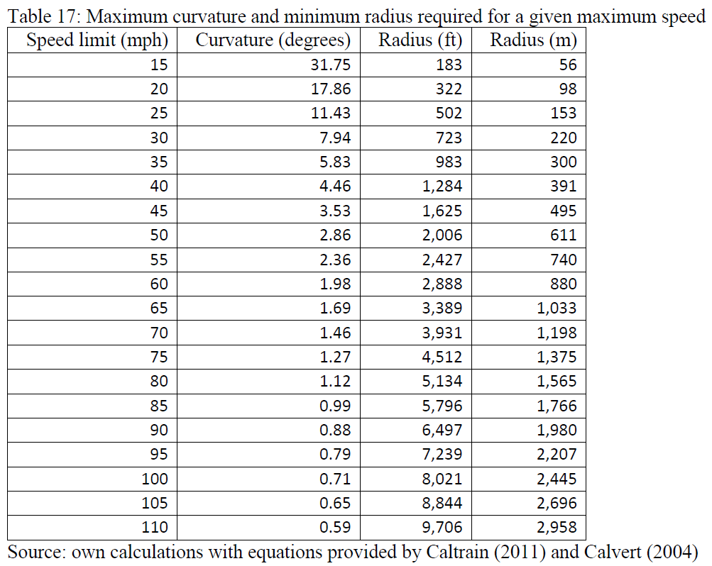

I've created a more detailed version of "Table 17" to show the degree of curvature and radius for an equilibrium superelevation between 1 and 10 inches and speeds between 15 and 200 mph and if you refer back to the first table from Paul's post I quoted above, it becomes clear that the "FRA 3 INCH" and "FRA 6 INCH" columns presented by him assumes 2 inches of cant deficiency (unbalanced superelevation) for a total superelevation of 5 and 8 inches, respectively:
I've created a more detailed version of "Table 17" to show the degree of curvature and radius for an equilibrium superelevation between 1 and 10 inches and speeds between 15 and 200 mph and if you refer back to the first table from Paul's post I quoted above, it becomes clear that the "FRA 3 INCH" and "FRA 6 INCH" columns presented by him assumes 2 inches of cant deficiency (unbalanced superelevation):
Thanks for the table, it's very informative! For others' reference, here are some numbers I pulled from it:
Based on the typical 560-metre radius present on the eastern segment of the Havelock sub, here's the applicable speed limits from the right table given different equilibrium (total) superelevation:

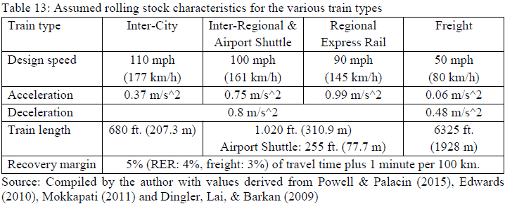

The only practical way to model train running times is to assume uniform acceleration, by which only two parameter determine a train's capabilities to accelerate and decelerate (one parameter for each) along its route, which I explained in all detail in Section 6.2.
As you could also read in Section 5.3, I selected four different train types for the Toronto-Kitchener service I was modelling:
Source: my Master Thesis (p. 60)
Needless to say, that the "Inter-City" train is the most appropriate train profile as the closest equivalent to the Siemens trains which would serve the HFR route.

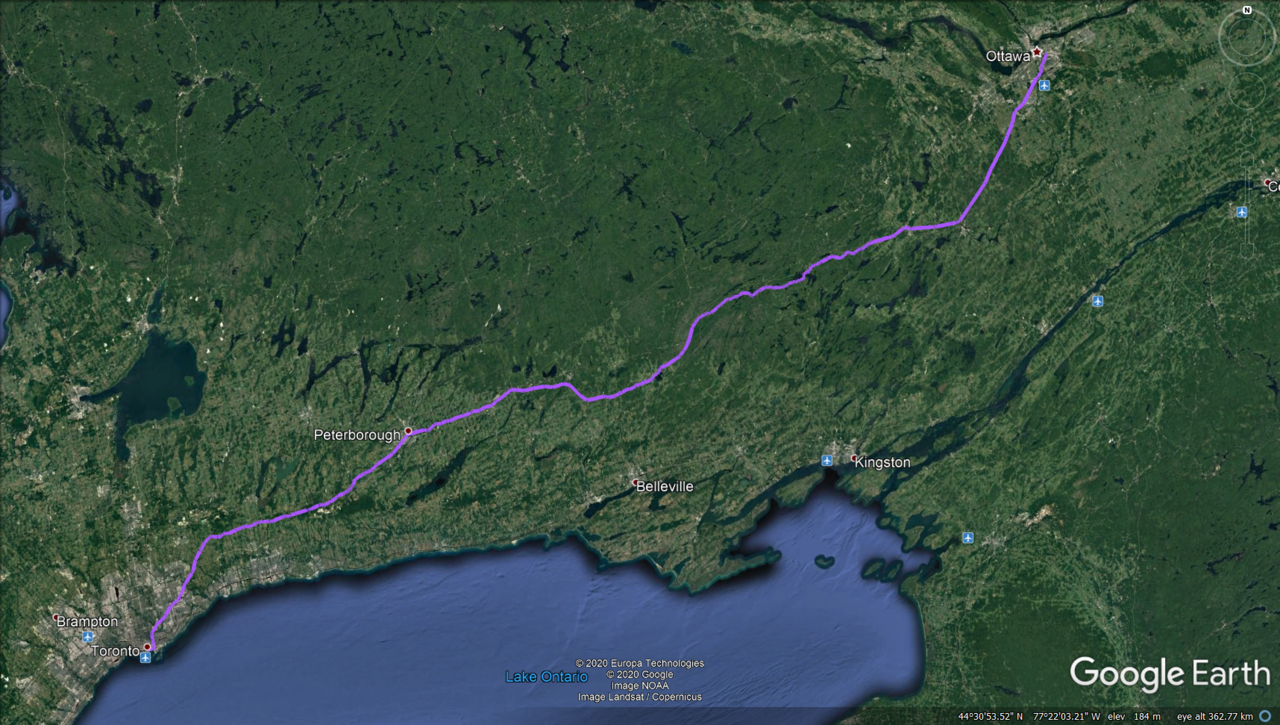

I extracted the routing from the excellent Ontario Railway Map Collection and only modified the relevant lines to cut them as required (and to make them meet each other at Agincourt). The only line I actually had to draw was the bypass northwest of Smiths Falls, for which I simply placed a circle with a radius of 3000 meters (i.e. sufficient to allow a maximum speed of 110 mph even with a total superelevation of only 2 inches, see next section), which touched the lines extended from the Smiths Falls and Belleville Subdivisions:
The result is the following route:

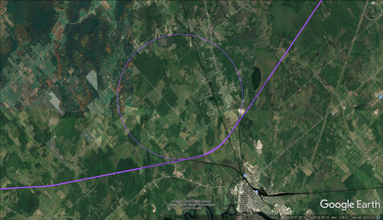

Let's move on to the tricky part, the curves: using the only perk of Google Earth Pro about which I care (i.e. the circle drawing tool), I have measured every single curve I could spot (by drawing tangent lines between those curves I could spot) - and believe me, there are a lot! Long story short, I identified 270 curves along the alignment, of which 229 were located on the Havelock Subdivision (thus 85%, despite only accounting for only 73% of the total distance:
No less surprising, the most Eastern segment of the Havelock Subdivision (i.e. between Tweed and Glen Tay) has 8 times as many curves (per 100 km) as the Smiths Falls Subdivision:
Before I continue with determining the speed limits, I'll give you my .kmz file and some time to explore the curves I've identified and to find any curves I might have missed. Also, please let me know if you have any questions so far or struggle to see where I derived my assumptions from! As I said at the beginning, full transparency and exclusive dependence on publicly accessible sources is the only way for me to help you with modelling the HFR route...
