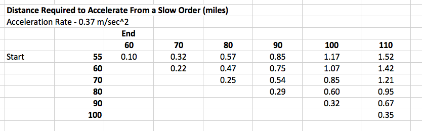

Here's the rub: Using the 0.37m/sec^2 spec, converted to mph of course, it takes a longer stretch of tangent to apply this principle than the actual track allows. I produced a table showing the distance needed for a train to accelerate from one speed to another speed.

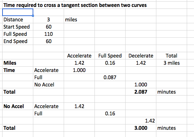

For the most favourable scenario - ie a train having slowed to 60 mph, then sprinting back up to 110 mph, it will take 1.42 miles to get back to 110 mph. If another slow section is approaching, it will take a further 1.42 miles to slow from 110 mph back down to 60 mph. Conclusion #2: Because the tangent sections between curves are rarely a minimum of 2.84 miles long, in many places the usable speed of tangent track will frequently not be 110 mph.
The practical problem this creates is that, in the absence of a sophisticated autopilot, a train run by human hand will have difficulty handling all the changes in speed to extract the optimum speed-up/slow-down cycles required. Further, the number of full throttle-followed-by-heavy-braking cycles are not condusive to equipment SOGR or fuel efficiency. The likely solution will be to impose "zone" speeds which limit speed over the short tangent stretches to something close to or equal to the slow points of the curves.
How much does this affect the speed envelope? Here's a hypothetical example. Consider a three mile tangent section between two 60 mph curve sections. One would like the train to accelerate in between, but here's how that looks:
Now consider the alternative - just declare the whole length of track, ie the two curves, and the tangent connecting them, as one "zone" limited to 60 mph. The "No Accel" scenario shows the time required, compared to the speed-up-then-brake scenario. The "zone" scenario adds an extra minute to the timing over the "go like stink" scenario. Again, the sheer number of these short tangent sections suggests that a great deal of tangent track will not be usable at the vision of 110 mph. That will add minutes to the timing.
One reads many anecdotal accounts of how fast trains ran in the steam era, where locomotives didn't necessarily have a speedomenter, and speed enforcement was minimal. Old-school engineers did often work from the "go like stink" premise. However, I doubt that it would pass either today's regulatory regime, or a value engineering analysis.
I thought I would put this out there before I try to guesstimate where "zone" performance will be reality. It's a good news, bad news picture. While I haven't concluded that the line is a dud, I would discourage those who imagine it as a 110 mph racetrack.
Please, critique the above to shreds..... I'm still working on the granular picture, better now before I have to rework stuff.

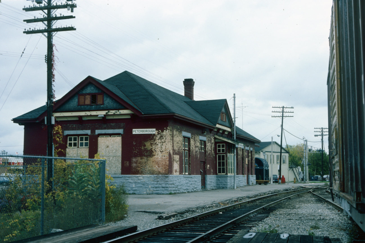

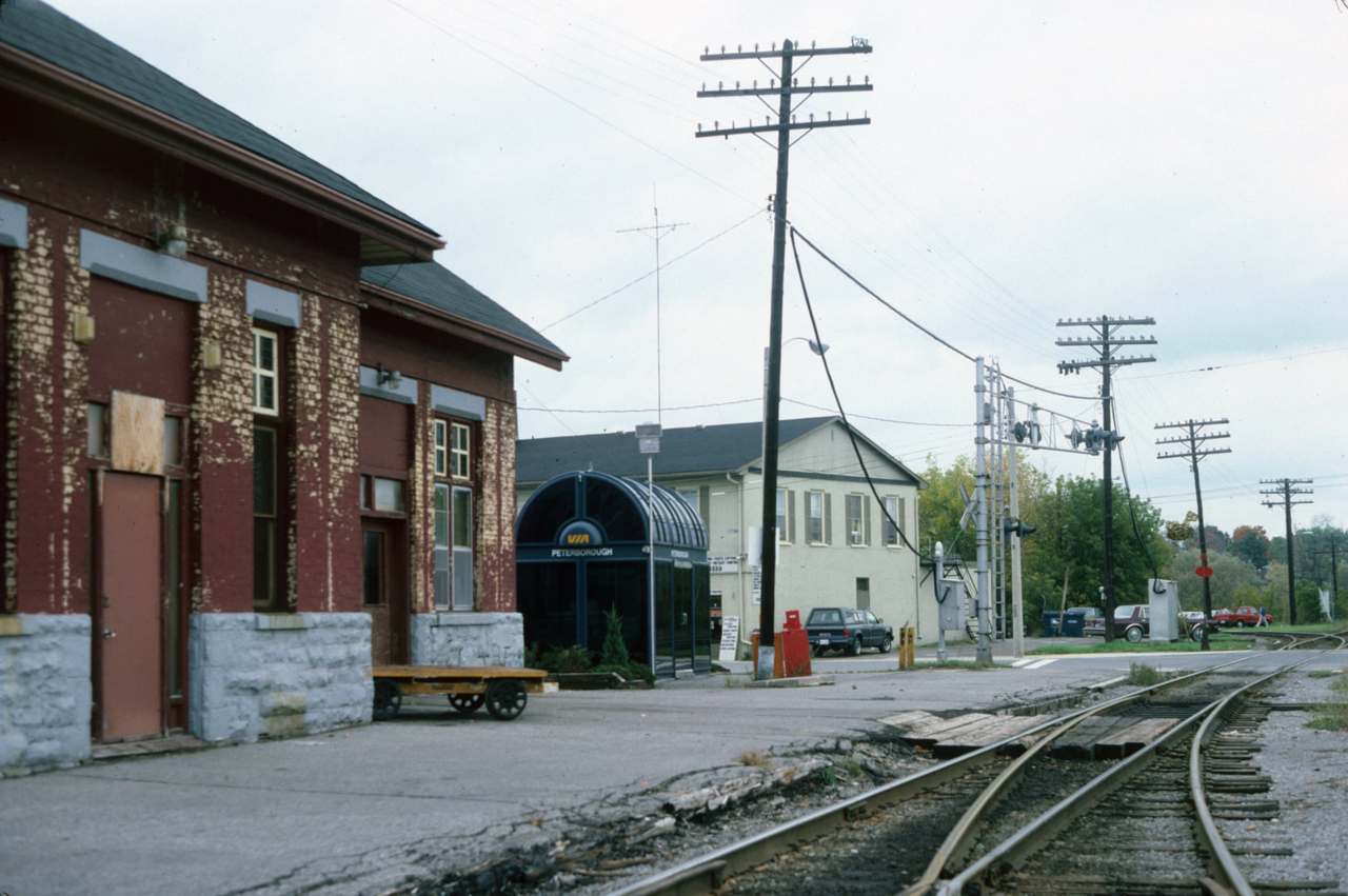

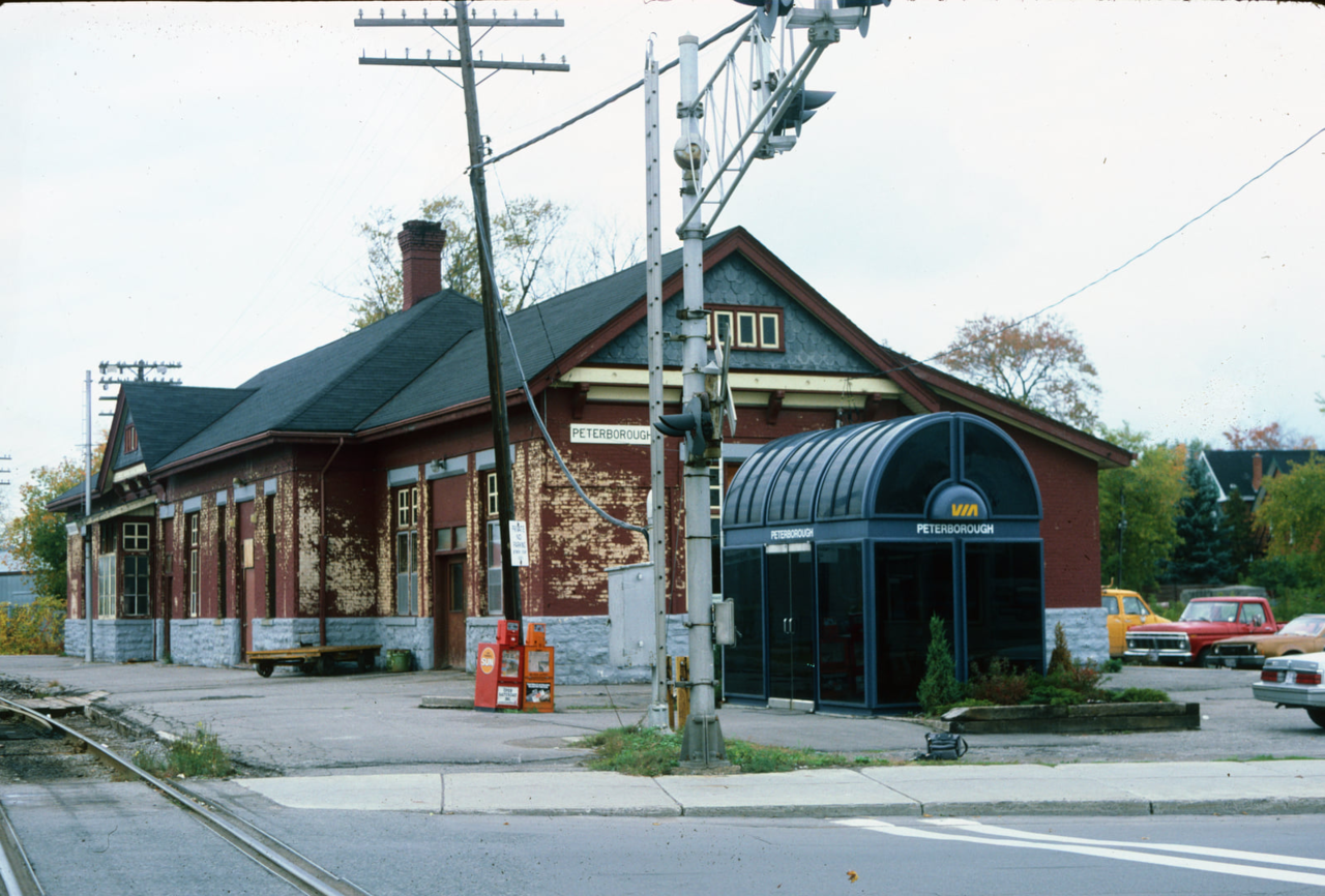

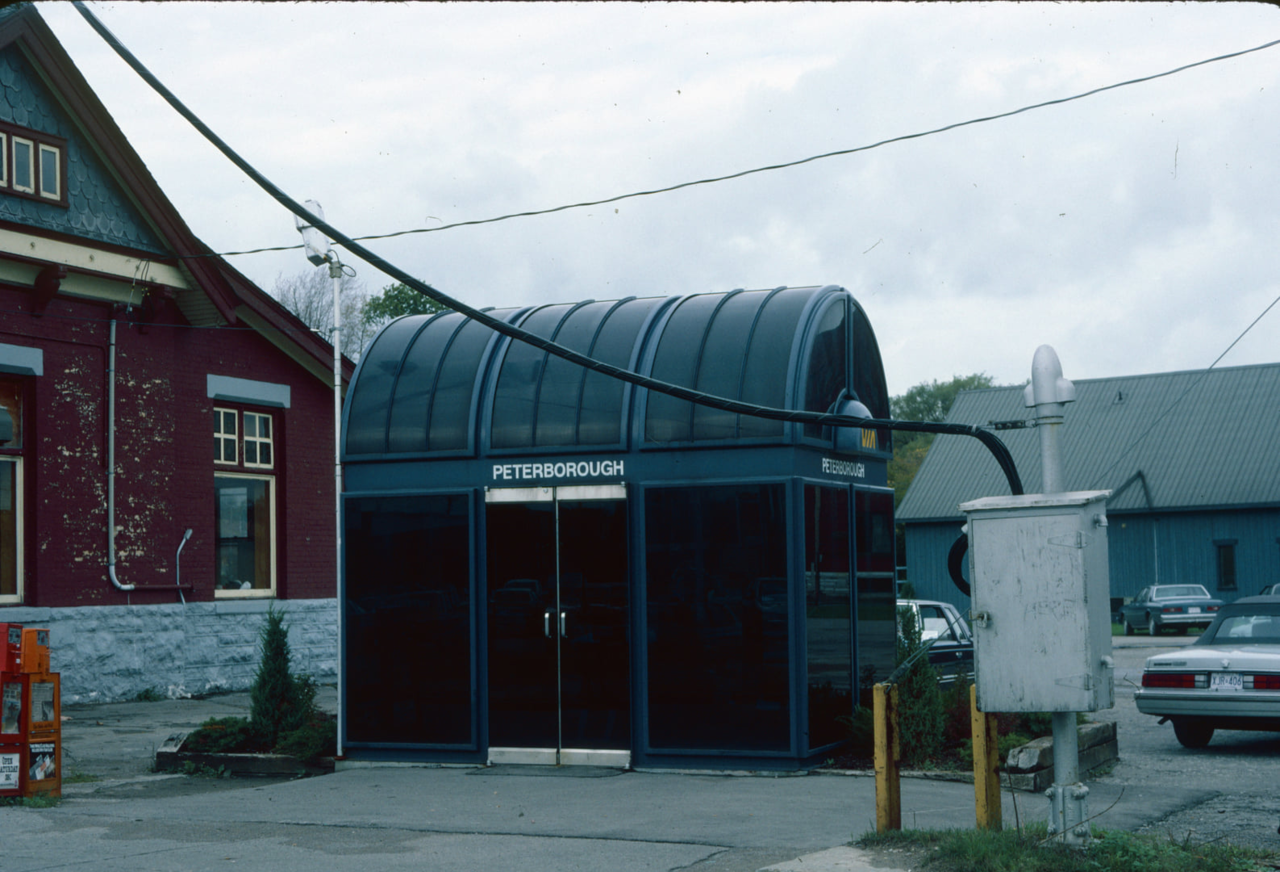

Just a bit of a throw back to the last time Peterborough had VIA Rail service until it was cut by Mulroney in 1990. I hadn't seen pictures of the VIA shelter beside the historic station before. The photos are by John Cowan and he has a great Facebook page for his photos here. Link to pictures here.
If those photos don't sum up the state of North American intercity rail in the 80's and 90's, then I don't know what does.

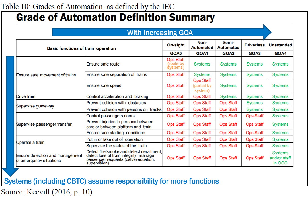

All the specs you see in that table are the result of arbitrarily selecting a train type in the literature (see table below) which I found most relevant for the Toronto-Kitchener route, but they won't necessarily have any resemblance to the capabilities of the trainsets which will actually be selected for GO RER and any other services on that corridor. That said, any service which has frequent stops (e.g. GO RER) will have a focus on acceleration, while those covering longer distances with fewer stops (e.g. VIA's HFR trains) will have a focus on maximum speed instead...
Quoted in: my Master Thesis (p.58)
The state of a still in-service station (at the time), in a comparatively major town was indicative of the value place on rail service, certainly the politicians and arguably the broader public.
That's the sort of thing that drives ridership lower over time, making cut politically easier.
Death by (wilful) negligence.
