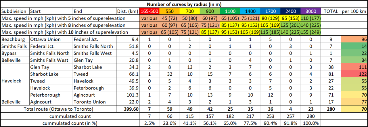

Concerning the financial performance, if you refer back to the table I posted in Post #6,745, an operating ratio (i.e. variable revenues divided by variable expenses) of more than 130% for the Corridor services, 90-100% for the Canadian and 45-50% for the Ocean suggests that VIA's subsidy requirement would be minimized by expanding frequencies on the Corridor, keeping the Canadian where it is and reducing frequencies on the Ocean (referring to the pre-CoVid schedules of course, but leaving the question of how much more can you cut from an already thrice-weekly schedule on the Ocean):
1585527242974-png.238779
Compiled from: VIA Rail's Summary of the Corporate Plan and Annual Plans 2017 and 2018
Note: figures in bold are provided in above documents, whereas all other figures are derived from these figures.

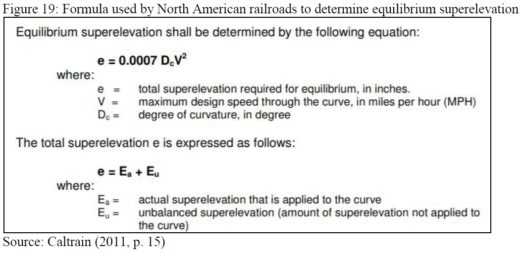

Finally, I am assuming that the superelevation that VIA can achieve on curves is, as noted in above posts, 8 inches total - three unbalanced and five balanced. While there is freight traffic west of Havelock, let's assume its volume is not so great to force lower superelevation. Using this FRA chart, the good news is, I can assume that a 3 degree curve can be negotiated at 60 mph. (I am doing all my work in miles rather than kilometers, so as to align to railway mileposts....it just keeps the source data readable). Since 3 degree curves are the most problemmatic limiting curve, 60 mph becomes the "worst case" for speed, other than in a few sections where either curvature is extraordinary or speed may be restricted for other reasons eg in urban areas.
As I showed with the example of Brightline, 8 (i.e. 5+3) inches of superelevation seems to be a realistic assumption...

Therefore, I'm not trying to prove that 3:15 can be achieved with little or no alterations to the existing alignment, but to show that claims that such a travel time would be achievable are reasonably credible. This means that I'm making relatively aggressive (but not implausible) assumptions and I will hand over the spreadsheet to you two (and anyone else interested) to play with the various parameters until you believe that the results are reasonably dependable to assume that such a travel time might very well be achievable.
This is a fair point and it emphasizes the differing perspectives we are working from. I will declare a bias, based on past experience stretching all the way back to the unhappy rollout of the Turbo in 1960’s, where initial assumptions around performance of new trains in this country proved unworkable and performance was scaled back over time. I’m also thinking of what the investor’s confidence level may be.
And I am especially worried about what the Ottawa bureaucracy may be trying to achieve by whittling away at the envelope, notwithstanding ROI. My gut says that an $8B HFR would be a winner, but if the bureacracy manages to hold VIA to $5B, will the business case suffer a “death by paper cut”? What can VIA actually do with a skimpy envelope?
The test I am using is undoubtedly more conservative, not because I am trying to naysay, but rather because I am looking for proof closer to “beyond reasonable doubt”.
As I chew through the data curve by curve, it’s very apparent just how much of the value proposition for HFR depends on extracting speed from every short section of this route. It is also apparent that the optimum approach may have to be banking and quick sprints rather than trying to straighten curves, given really rough terrain. So I’m very interested in the sensitivity tests - will HFR really be held to 60 mph on a 3 degree curve (of which there are many)? If that number can be 65, how many minutes are gained? If there is a 60mph curve, how much tangent must there be between it and the next curve to make a “quick sprint” feasible, or will the tangent also acquire a 60 mph limit? Will VIA discover that the “quick sprints” put too much stress on equipment and consume too much brake shoes or fuel, or will crews just find them too onerous and not push to the envelope?

As I wrote in my previous post, Brightline in Florida operates with 8 inches of superelevation (5 inches of banking plus 3 inches of cant deficiency) on infrastructure which is still owned and operated by a freight railroad. Also, you should keep in mind that the freight railroad's resistance to increase the cant is less a result of safety concerns as that operating trains over tracks which is banked more than the equilibrium superelevation simply increases the tear and wear on the rails (as the wheels keep grinding at the inside of the lower rail), which suggests that even though freight railroads hate more aggressive superelevations as a RIC (rail infrastructure company), they should be rather indifferent about it on lines where they are merely a ROC (rail operating company) as a tenant...
