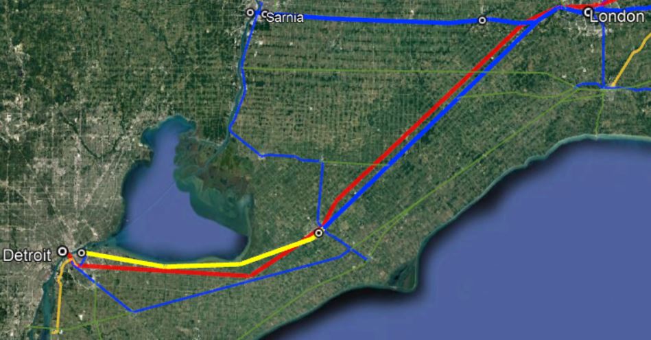

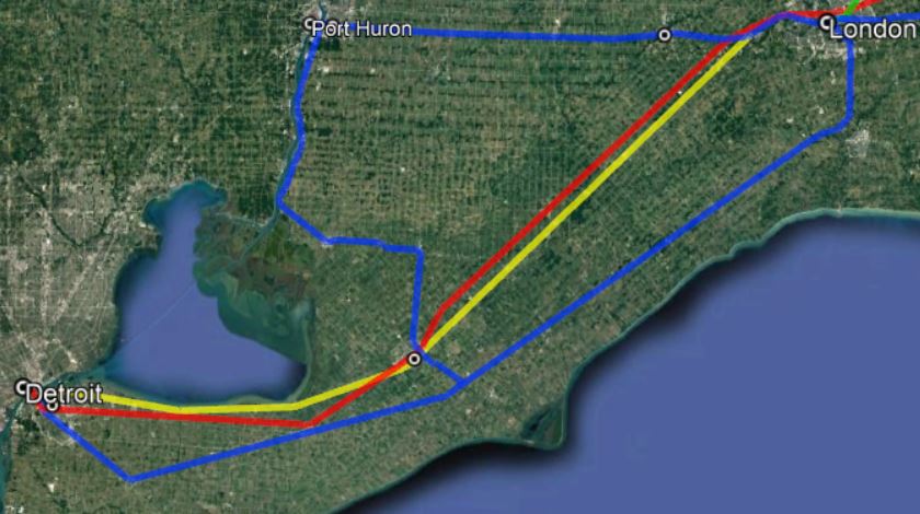

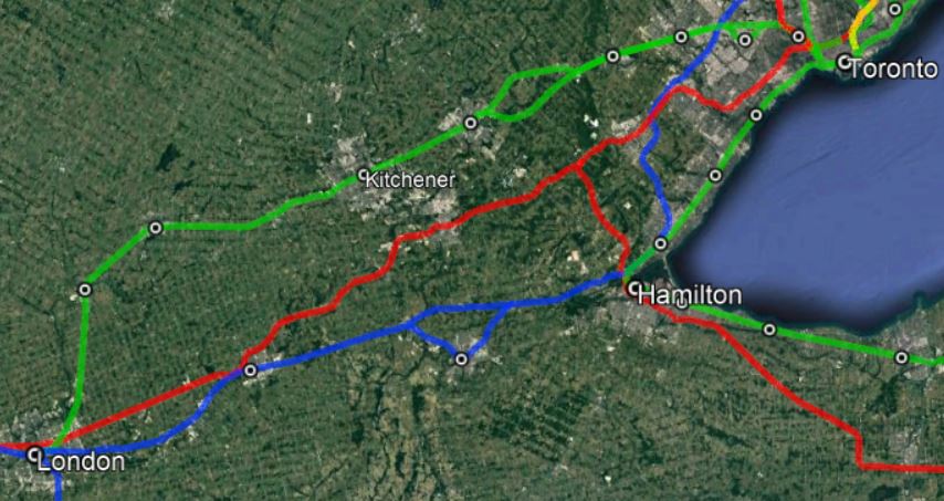

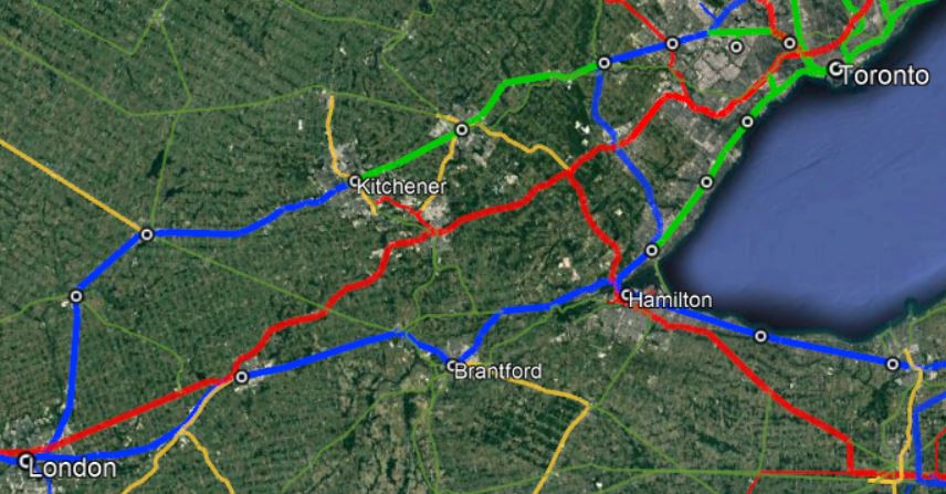

I'm really hopeful that eventually VIA will create an HFR southwest by buying the GEXR sub from CN to London and upgrading the rail to Class 7 200kmh. They will have to contend with Metrolinx and CN on the portion from Union to Kitchener but I dont see that as much of a problem.
As far as Windsor goes, theres lots of farm fields, so building a rail line adjacent to the existing CN/CP mainlines would probably be quite easy. VIA fortunately already owns the track near Windsor so getting into Windsor where land acquisition would become expensive and difficult is not a problem.
For the K-L line, you'd need to straighten those curves west of Kitchener, and bypasses of Baden, St. Mary's, New Hamburg, and Stratford. You'd be better off building a new alignment there (in my uneducated opinion. Does anyone else have more information than me?)

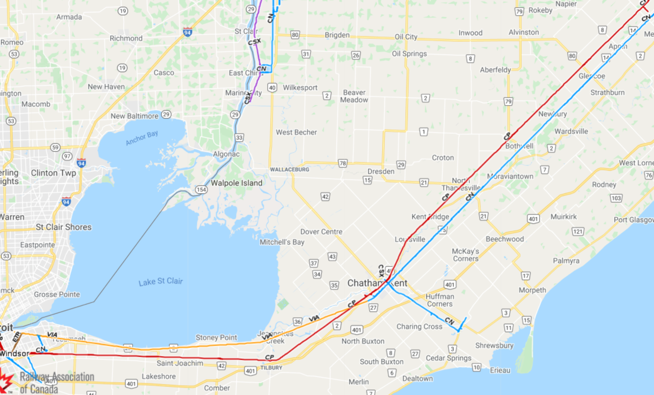

Given that CN was willing to sell that section of the Chatham Sub, I think there's a decent chance of just persuading them to sell the rest of the sub to Komoka, though you'd probably need bypasses for a lot of towns. Now you'd need to consider speed vs cost.
I really don't think it would be difficult for VIA to buy the remainder of the Chatham Sub from CN (if they had the funding). The difficult would be obtaining dedicated tracks through London to connect the Guelph Sub to the Chatham Sub as the Dundas and Strathroy subs are part of CN's mainline.
I actually struggle to see CN selling the Eastern part of the Chatham Sub, as I believe freight traffic to be substantially higher than it was west of Chatham/Bloomfield or along the Alexandria Subdivision at any point after CN sold these segments...

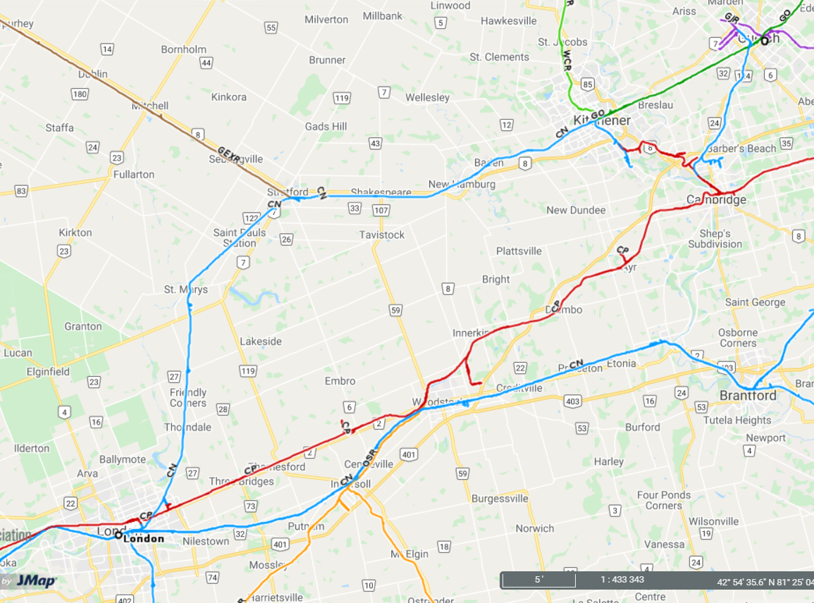

Historically there was no slow order on any of the curves west of Kitchener - they were always good for 70 mph..... until CN and GEXR stopped maintaining the track, anyways. Worst case if VIA fixed up the line would be a short 70 mph slow order - not a big penalty timewise. I bet with banking that could be improved upon.
Collenette suggested a pretty nifty route to the south of the CN line in his HSR study.... and that got a pretty hefty backlash from local residents. I would say stick with the CN routing. Clearly Baden and maybe New Hamburg might justify a grade separation. A bypass around New Hamburg would require a new bridge over the river.... no doubt cheaper to stick with the one that's there.

The merit, such as it is, involves the savings in distance, as well as creating a straighter line, capable of sustaining higher speeds over longer distances.
If you compare KW-London, via Stratford to KW-London via the straightest possible line, you save about 10km.
But you would also net increased track speed, and presumably fewer stops.
I happen to agree with you on the value of Stratford; but I also think there is some value in future-proofing and thinking about the value of shorter travel times between larger centres.
(ie.. Detroit-Toronto)
The savings off that one bypass aren't huge, but they aren't 'nothing' either.
The key is more in what you save by repeating similar exercises multiple times over the route.
I don't think there is a business case, based on current circumstances, or top speeds of 200km/ph for creating an entirely new ROW for optimal speed.
But I can foresee the day when that will be true, and a top speed of 300km/ph or greater.
As such, I like the idea of protecting the optimal route; but not building it, in the near-term.

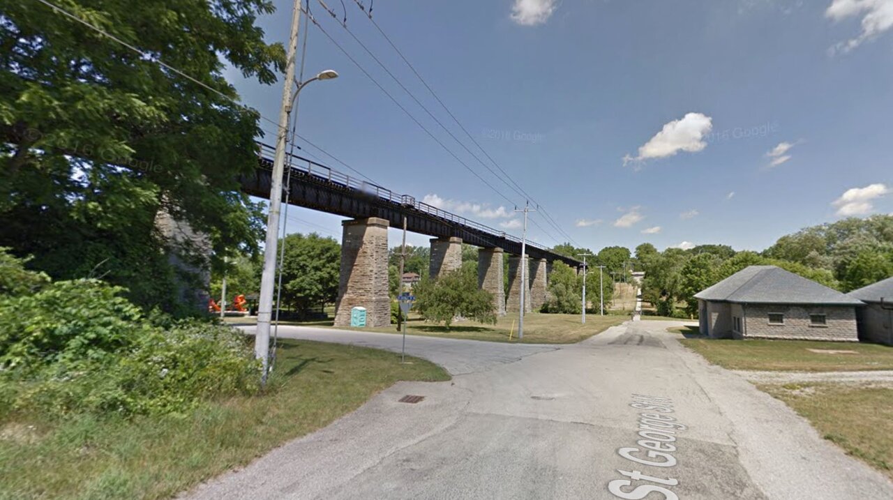

In the super long term we may wish to bypass St Mary's because there's a single-track viaduct through the middle of town that would be quite expensive to double track, thus reducing the net cost of a bypass relative to maintaining the existing alignment.
However at the moment we're a loooong way off from needing to fully double track the line. Having one small single tracked segment along an otherwise double-tracked line would still easily support 3 different train services per hour per direction, which is more than we would have in the foreseeable future anyway.
The existing alignment is pretty good, as I showed yesterday, so there's no way any kind of new alignment would beat the cost-benefit ratio of upgrading the existing line between Kitchener and London. The only place bypassing might make sense in the foreseeable future is Acton and Rockwood, since those 70 mph curves are within built up areas and cannot be widened, and the eastern half of the line will be considerably busier than the west.
