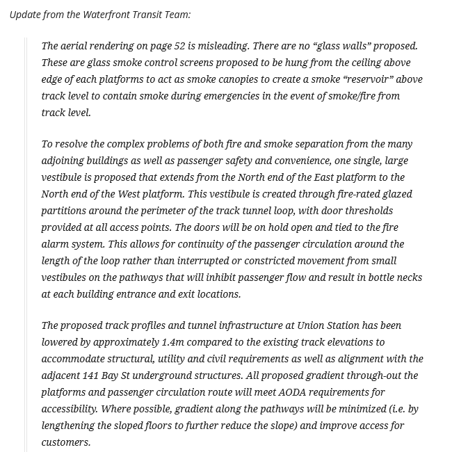

@Amare has several good points above. But I want to add.
The current Union Station Streetcar Loop does not meet Fire Code , this is a huge part of the cost. The alternative, if one leaves the existing loop in place, capacity issues notwithstanding, is that if a fire were ever to occur, there may be a considerable loss of life. I don't think one can really set that aside. The moment you decide to alter the loop/station to meet code, you've opened the can of worms to the tune of several hundred million, it hardly makes sense not to finish the job.

A good point. Though the cost to deal with fire code at the Danforth Line stations hasn't required 100 million per station. All you need is a fire exit on the platform. A low-cost stairwell with fire-doors from the east-side of the current platform to just south of the southeast corner of Bay and Front would accomplish that. It doesn't need finishes and form. Just function.
I'm afraid the fire code issue is rather more involved at this particular location.
From Steve Munro's site:
Source: https://stevemunro.ca/2021/02/16/waterfront-east-lrt-virtual-public-meeting/#Update
