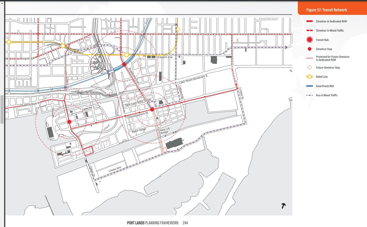

Clearly the designers of the new Portlands bridges have not taken streetcars into consideration, so any move from Cherry St. across Lakeshore to the Portlands will need its own bridge. It just seems silly to let the Cherry St. bridge and the awkward bend of Lakeshore and the Gardiner dictate where public transit can go. Imagine you're living in a new condo development near Poslon and Cherry St. and you want to travel to the Distillery District. You decide to take the streetcar, but then see that it must go all the way to Leslie. Here's what we need, from https://www.toronto.ca/legdocs/mmis/2017/pg/bgrd/backgroundfile-107828.pdf

You seem a bit confused. The new Cherry Street bridge bridge across the Keating Channel has a huge transit section on its east side. This will bring streetcars from just north of the rail berm south to Commissioners Street and the latest plan has a (temporary) loop created on Commissioners a bit east of Cherry. The Commissioners Street bridge does not (yet) have a streetcar section but the bridge 'island' in the middle of the new Don has apparently been built so that it can support the centre pier of the future Commissioners Street transit bridge - immediately north of current bridge. Probably long after we are all dead, this bridge will be built and that will allow the streetcar connection to Leslie Street (and the Barns). In theory the tracks on Broadview south of Queen could be built to Commissioners and then east to Leslie sooner but I doubt our successors will be any more keen to built transit infrastructure! If a person living at Polson & Cherry wanted to go to the Distillery, they would presumably walk up Cherry to Commissioners and take a northbound streetcar going up Cherry to Distillery or a west bound one going to Union/Exhibition along Queen's Quay and then walk up Parliament from Queens Quay.

This is where the Portland tracks will crossover the Lake Shore to go under the RR corridor that will be near the north pier support of the Gardiner
