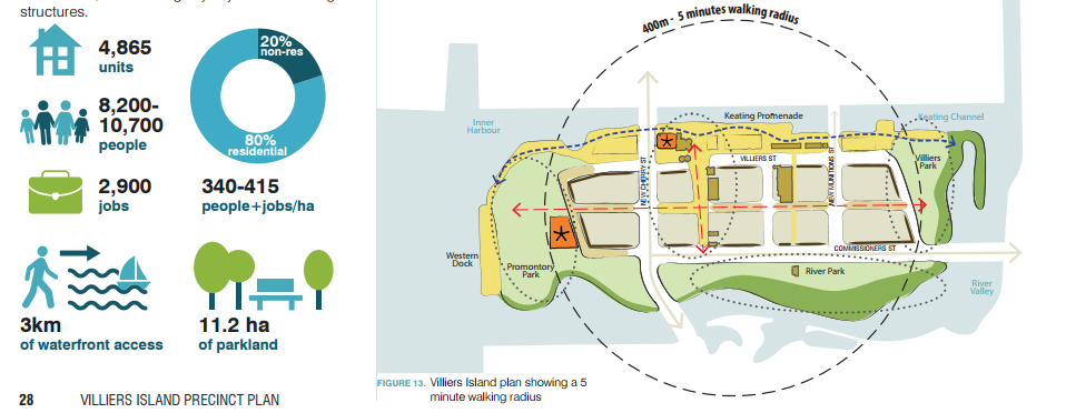

Peering through the Lower Don Lands / Portlands EA that got released earlier in the week, I can see now why they are projecting high ridership on Waterfront East LRT.
Villiers Island alone is expected to have between 8,200 to 10,700 people whose only transit access really will be the Cherry Streetcar. (For reference, the entire West Don Lands is supposed to house merely 6,000 people upon completion.)
Acording to the EA, the East Bayfront district is looking at 6,000 Residential Units (using Villiers Island math; that comes to between 10,080 and 13,200 people) and 8,000 jobs.
The Keating Channel District (north side of Keatin Channel), is projecting 4,000 Residential Units (6,720 to 8,800 people).
The Polson Quay & South River District (south of Villiers Island) is projected 4,500 people.
The Film Studio District (east of Villiers Island; Cherry Streetcar to turn east on Commissioners into this district) is projected 9,225–13,350 people and 9,500–14,500 jobs.
Added together, that is some 38,725 to 50,550 people along with 20,400 to 25,400 jobs (and this is not counting Lower Yonge and Jarvis precincts, and assuming East Harbour workers take other transit lines) that you got to pack on the streetcar/LRT line along Waterfront East/Cherry Street.

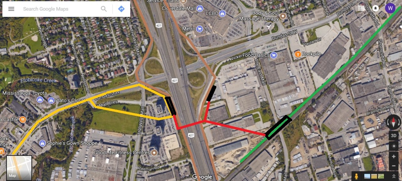

From the Line 2 West Extension thread:
Regarding the Dundas area, I don't wan't the subway to pass 427 - it adds big costs. It's a bit of a walk from the Honeydale Station to the 427 NB BRT (about 350m) and the 427 SB BRT / Dundas LRT terminal (550m including bridge). Of course, if the downtowners can do it from Queen's Quay to Union, this can be done too.
