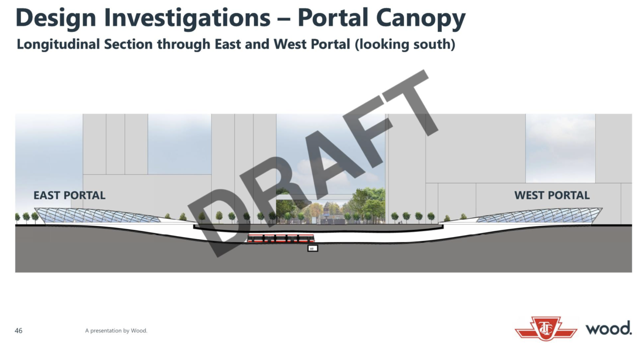

I see the Bremner portal is back (kinda). Clearly it is considered but the alignment goes through retained vertical supports.

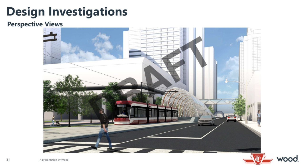

Don't think I've seen these canopy designs before. Nice to know there's a matching one proposed for the existing portal.
Thanks for posting these! Was waiting for them yesterday...
The canopies proposed in the original West 8/DTAH Central Waterfront scheme is broadly similar - but of course the design has evolved a bit over the past decade and a half (it was originally a wood lattice with no external glass covering).

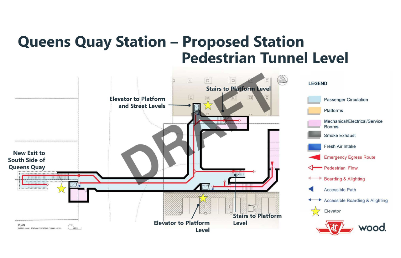

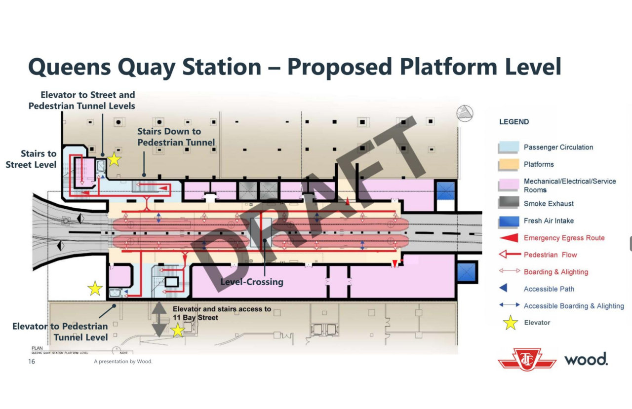

Something new in this revision, there's a level-crossing at QQ station in the middle of the platform. Much more convenient than using the lower level and leads me to wonder why the tunnel would still be providing access to the west side tracks.
Tunnel continues to the south side of Queen's Quay and the ferry docks.
  • Like
Reactions: rbt
Yup, I understand why the east side still has a stairwell and elevator to the lower level. My observation was that technically the west side doesn't need one since there is a path from west to east through the level-crossing and the east side stairway and elevator are there. I can think of two reasons for it, one is to provide a redundant elevator to that lower tunnel, and the second is to increase capacity for circulating passengers during busy periods. I wonder if it will survive subsequent revisions if they try to cut costs.

Level crossing... let the cheapening process begin!! Are they going to put in a crosswalk with walk/don't walk lights in the middle of the station? Hopefully having a level crossing in the middle doesn't suggest that they aren't going to be building the station floor up to allow level boarding.
