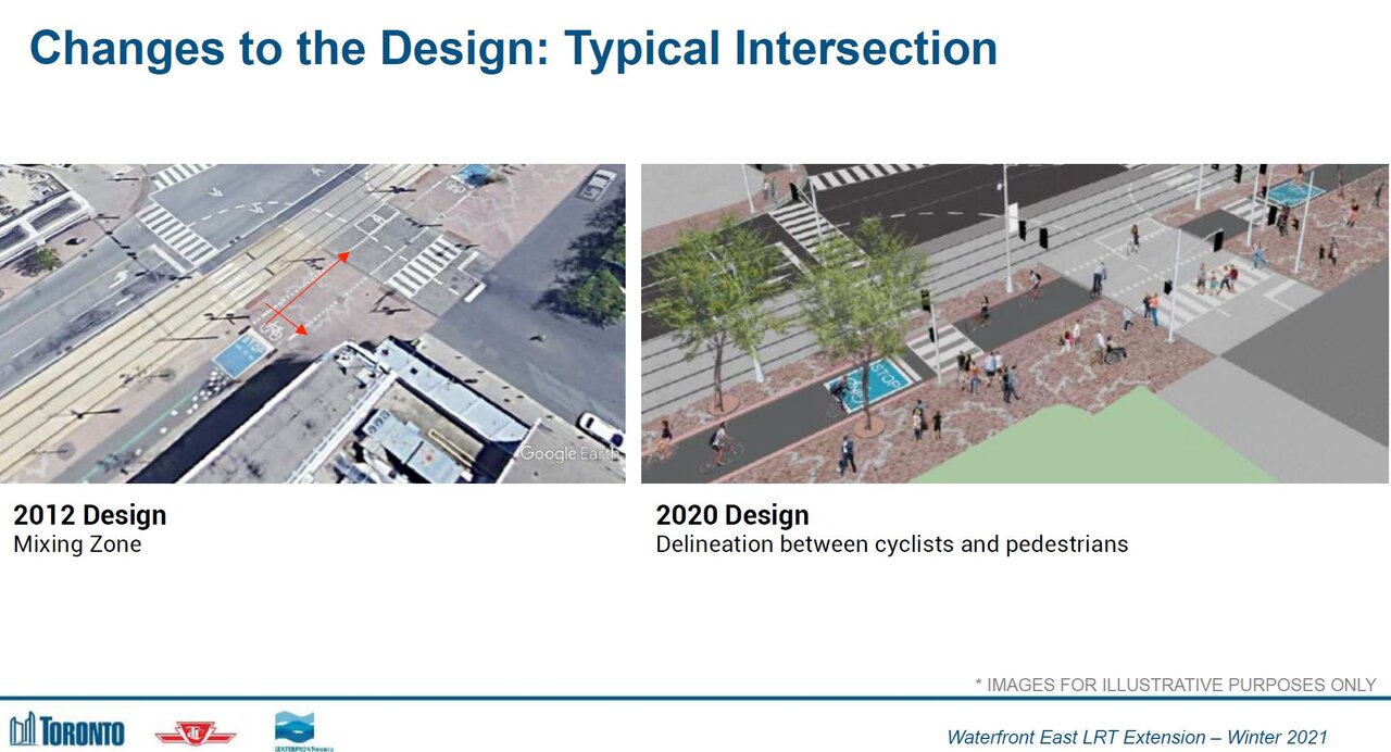

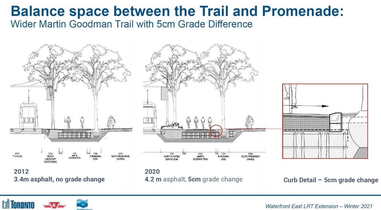

Wow, my goodness, I know we're all probably generally more interested in the LRT but I just want to call special attention to these shots from Steve's blog regarding the Martin Goodman Trail and cyclist/pedestrian separation:
Are my eyes deceiving me, or did the City/WFT actually LEARN something from the mess that is QQW? 5cm grade change with a curb separating the MGT from the sidewalk, asphalt MGT continuing right up to the roadway at intersections instead of turning into a "mixing zone" with the same reddish brick as the sidewalk, and an "open planter" zone seemingly with dirt/grass throughout instead of red brick sidewalk separating the MGT from the streetcar tracks? Wow. Hats off to WFT for actually noticing how badly those decisions impacted QQW and responding to fix them for QQE. Now, if only the streetcars were centre- rather than side-running (to this day, on both QQW and Cherry this remains a regular source of confusion for motorists), but still, this is a huge fix to cyclist and pedestrian separation. And during the busy summer tons of pedestrians used to stand on the super-narrow red brick "sidewalk" between the MGT and the streetcar tracks forcing streetcars to slow to a crawl and frequently stop and honk for them to move, so the "open planter" is also very welcome.

As a note, TTC has objected to the side ROW and prefer the centre of the road ROW from day one for both QQW/QQE and Cherry St. TTC has always wanted some type of barrier between the MGT and the streetcar. I do agree on this, but not what TTC wanted
I do agree there are a number of things that need to be change, especially at intersections that cause issues for everyone and this new change for QQE is one of them. How trees will be planted as well the different types now going to be use is going to help the trees to grow, not to die like they have on the QQW. The intersection will be setup better for drivers than QQW, but EMS is still call shots for the ROW which the should not consider how little they use it in the first place..
