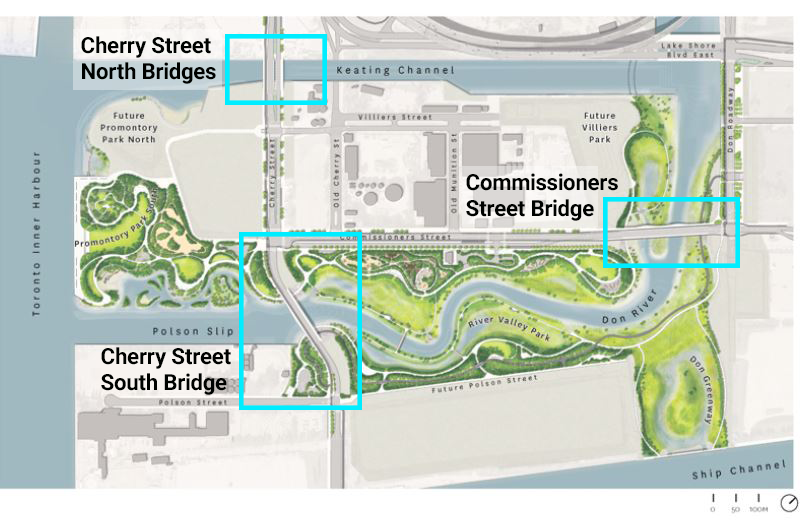

I was under the impression that the 4 bridges are - 2 Cherry St North bridges (road + transit), 1 Commissioners Street (road) and 1 Cherry St South. You can see the 'gap' where the transit bridge should go! Here's the last Waterfront DRP on them.
So they will need to order another Cherry Street South bridge if they want a Polson Loop! (And another one at Commissioners, eventually)
Map from here
Map from here
That's correct - the south Cherry LRT bridge needed for the Polson loop isn't a deliverable under the ongoing Lower Don project.
AoD
Will it fit under the existing Cherry Street South bridge to be hoisted up on the east side?
Unless I'm missing something, Cherry Street South has yet to arrive. We've only got the Cherry Street North transit bridge & one span of the Commissioners Street vehicle bridge. According to this video from WT:
the second span of the Commissioners Street vehicle bridge is next, then the Cherry Street South vehicle bridge at the end of this year.
One hopes the order can be modified so that then Cherry Street South transit bridge arrives first, but I expect that metaphorical ship to have sailed.

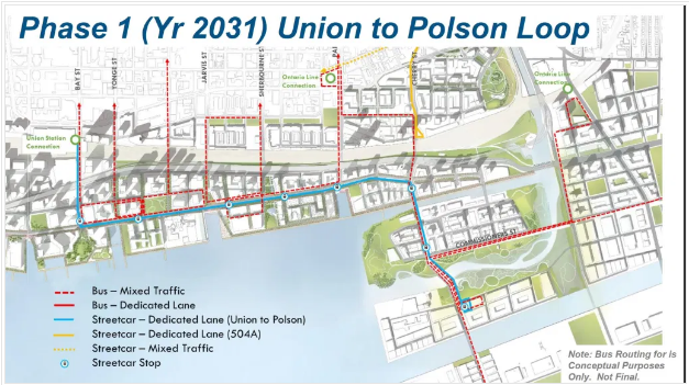

I believe the slides stated that going with the Polson Loop would require an additional LRT bridge order. I’m…honestly not sure what’s involved. Was the bridge designed but never funded? Does it have to be designed?

Ideally we try to push for as much expansion as possible before the development hits, the last thing we want is for the developments to spring up before we start building parts of the extension, and all of a sudden there's a bunch of NIMBYs that don't want streetcars on their doorstep. If Toronto wants to build out the Poison first, let's build out to Poison first, that way we have more guaranteed streetcar tracks that will be available at the end of the day.
