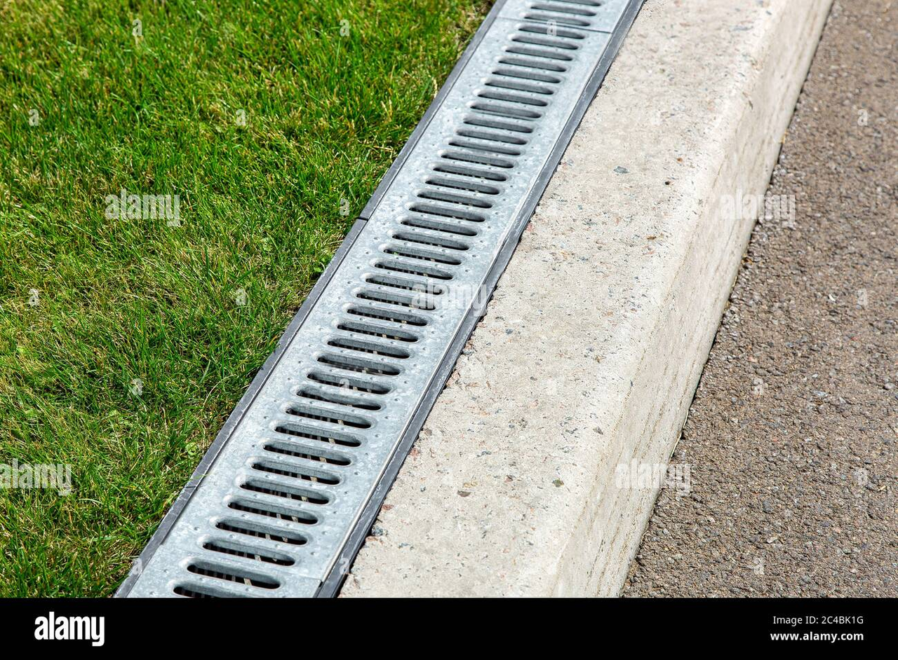

Generally speaking as long as it's sloping away from the house, you're fine. What I would do (not saying it's the best solution), but I'd make sure the backyard slopes toward the garage, put a small grate covered culvert (similar to below) along the garage, and have it wrap around the side of the garage out toward the alleyway. It's the cheapest solution, but I have found they work well for draining away water from the yard and only need to be cleaned once a year. If the gravel beside the garage already slopes toward the alley, you might not need the culvert along the side.
Whatever you do, just make sure it doesn't slope toward the house 👍
