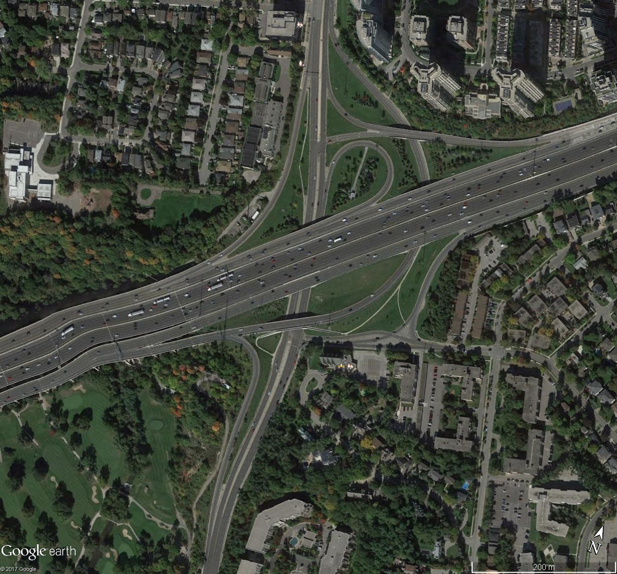

The picture also shows why EB 401-NB Yonge is configured as free-flowing: look at the traffic volume, vs. that of EB 401 to SB Yonge. It's also a reason why localizing Yonge in the NYCC stretch may not be the wisest idea. It may be to the best interest of condo dwellers, but Yonge serves a regional function, even though it's no longer a provincial highway. (before people jumping in to say Bayview can serve as the alternative, no it can't - the 11 Bayview buses already get messed up every rush hour by the long traffic queue around the 401 interchange.)
Yonge does serve some regional function, but not as access to the 401. Everyone who wants to take the 401 eastbound from north of Finch is already taking Bayview or Leslie. Even from Sheppard & Yonge, it's often just as fast to drive east to Leslie and take the 401 there (or go west on the 401, turn around at Avenue and take the Express lanes) because of the regular traffic between Bayview and Leslie on the 401 Collector lanes.
Agreed, but taking Bayview or Leslie would only work if they are going EB on the 401.

What’s the solution for the north set of lights?
Think about it,... what part of ParClov works well (free-flowing) and what part doesn't. Ditto for Four Leaf Clover,... basically any interchange configuration. Then figure out how to adapt what works well (the free-flowing part) to the part that doesn't (the not free-flowing part),... hence the perfect solution!
So a cloverastack? Add an extra free flowing ramp from westbound to southbound and a loop from southbound to eastbound. And BAM, no more traffic lights.
Argh,... you're too focus on design template. Cloverstack (like 404-407) are multi-level, ugly, not pedestrian/cyclist friendly and will cost about $500million far in excess of $50million budget.
Yonge-Jedi,... focus on basics,.... interchange has 4 direction of travel, as each approach interchange, there's 3 choices (traffic movements): straight through, right turn, left turn,..... thus full interchange need to handle 4 right turn, 4 left turn and 4 straight through.
- Which of these traffic movement is (generally) always free-flowing (regardless of interchange design)? Why? Where is it relative to the interchange?
- Which of these traffic movement is (generally) not naturally free-flowing (regardless of interchange design)? Why? Where is it relative to the interchange? Now, how can you "easily" convert these traffic movement to free-flowing???

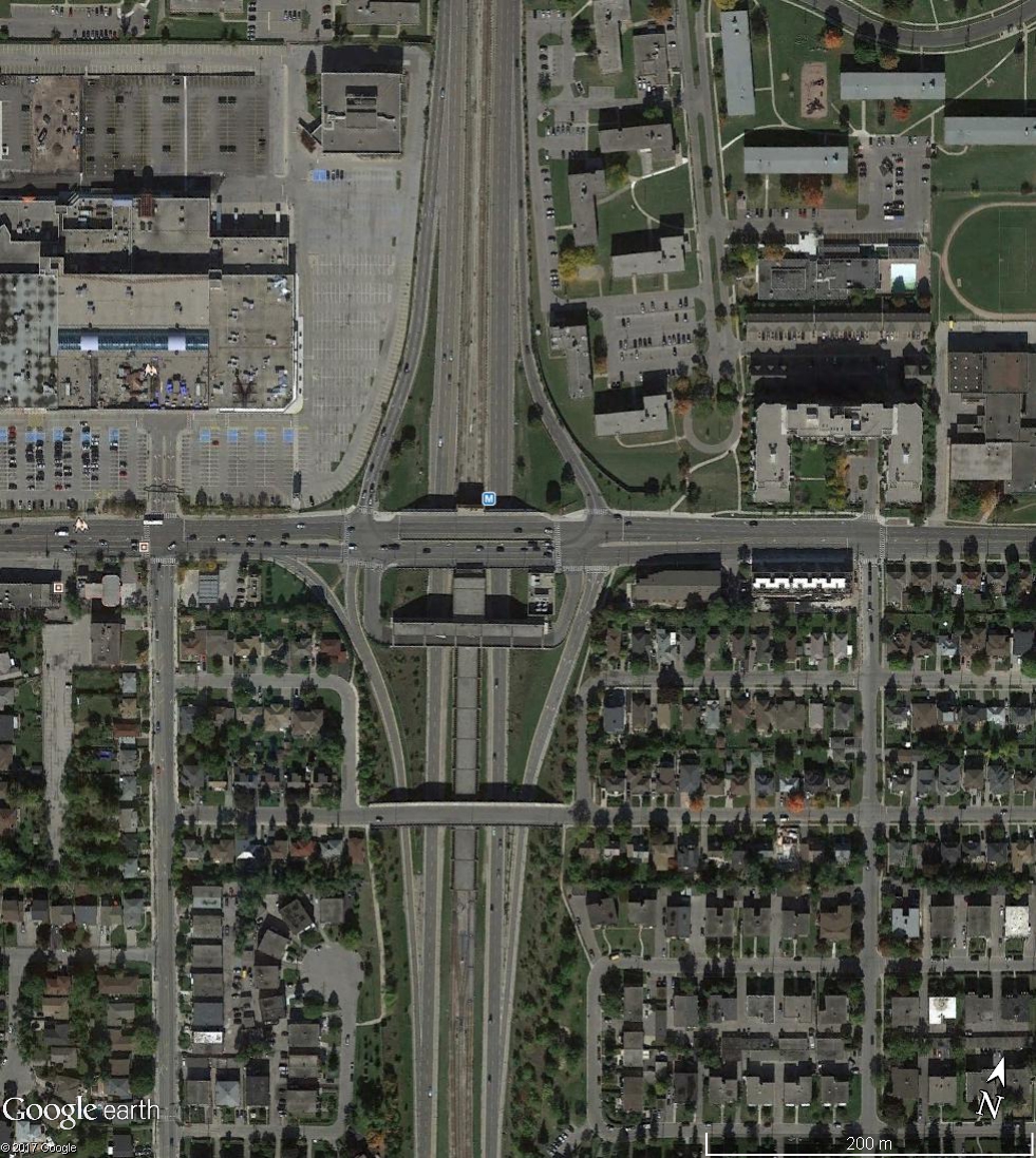

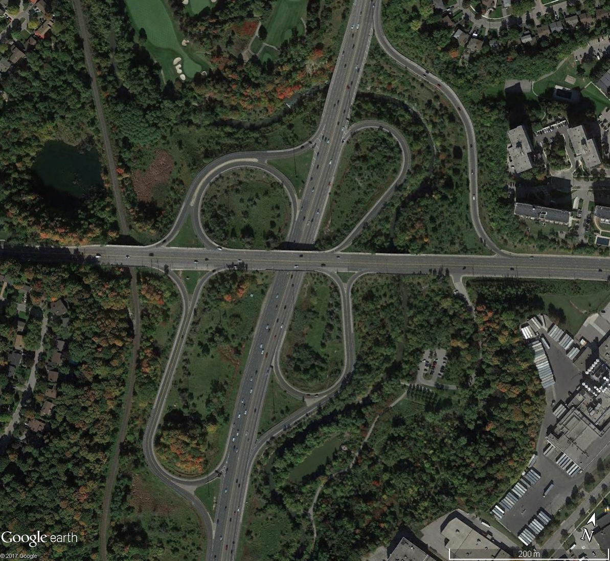

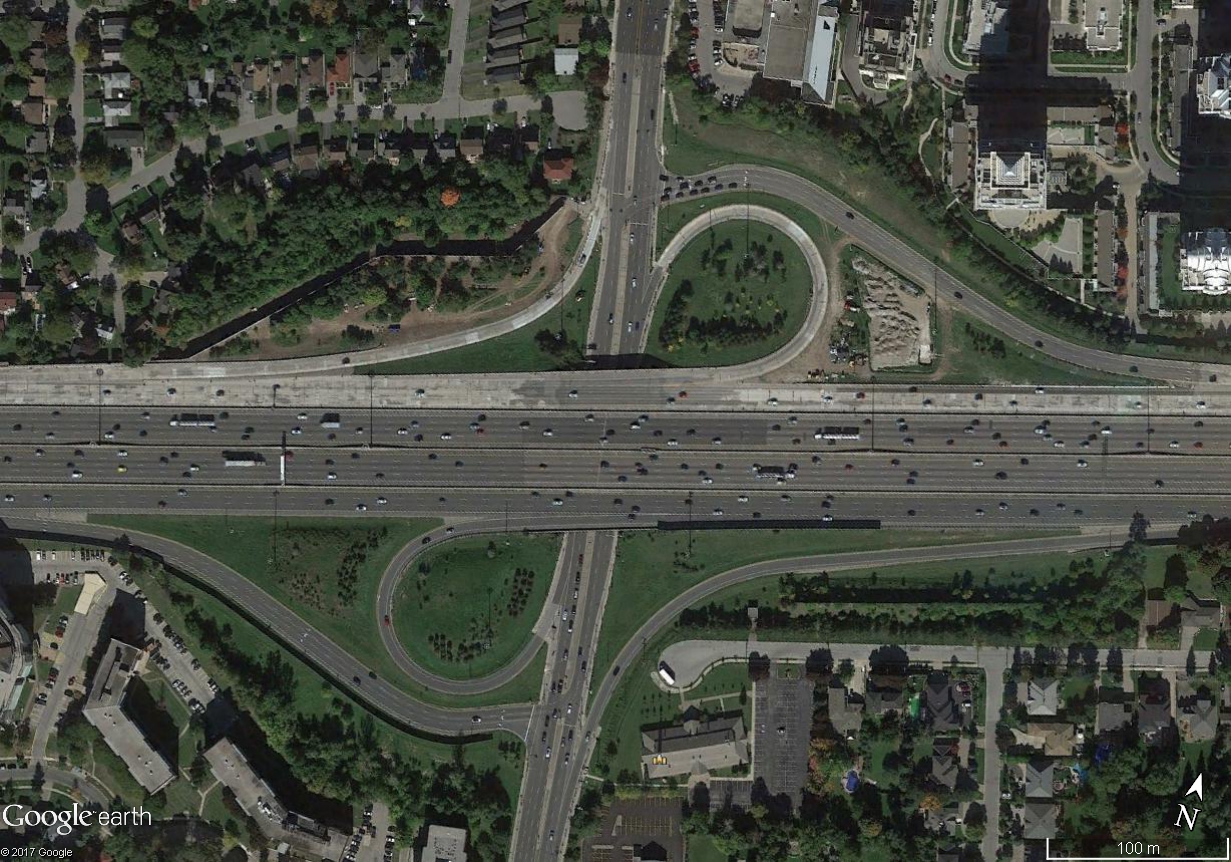

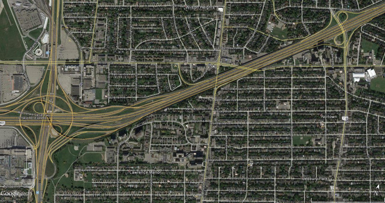

Here's some various interchange designs,... mark up right turn VS left turn VS straight-through,....
Partial Clover A4 at Bayview-401:
Full Clover at Lawrence East - DVP:
Typical American Diamond at Lawrence West - Allen Rd (NOTE: two very inefficient 3-phase signalized intersections):
Our odd Yonge-401 ParClov-Diamond hybrid interchange:
