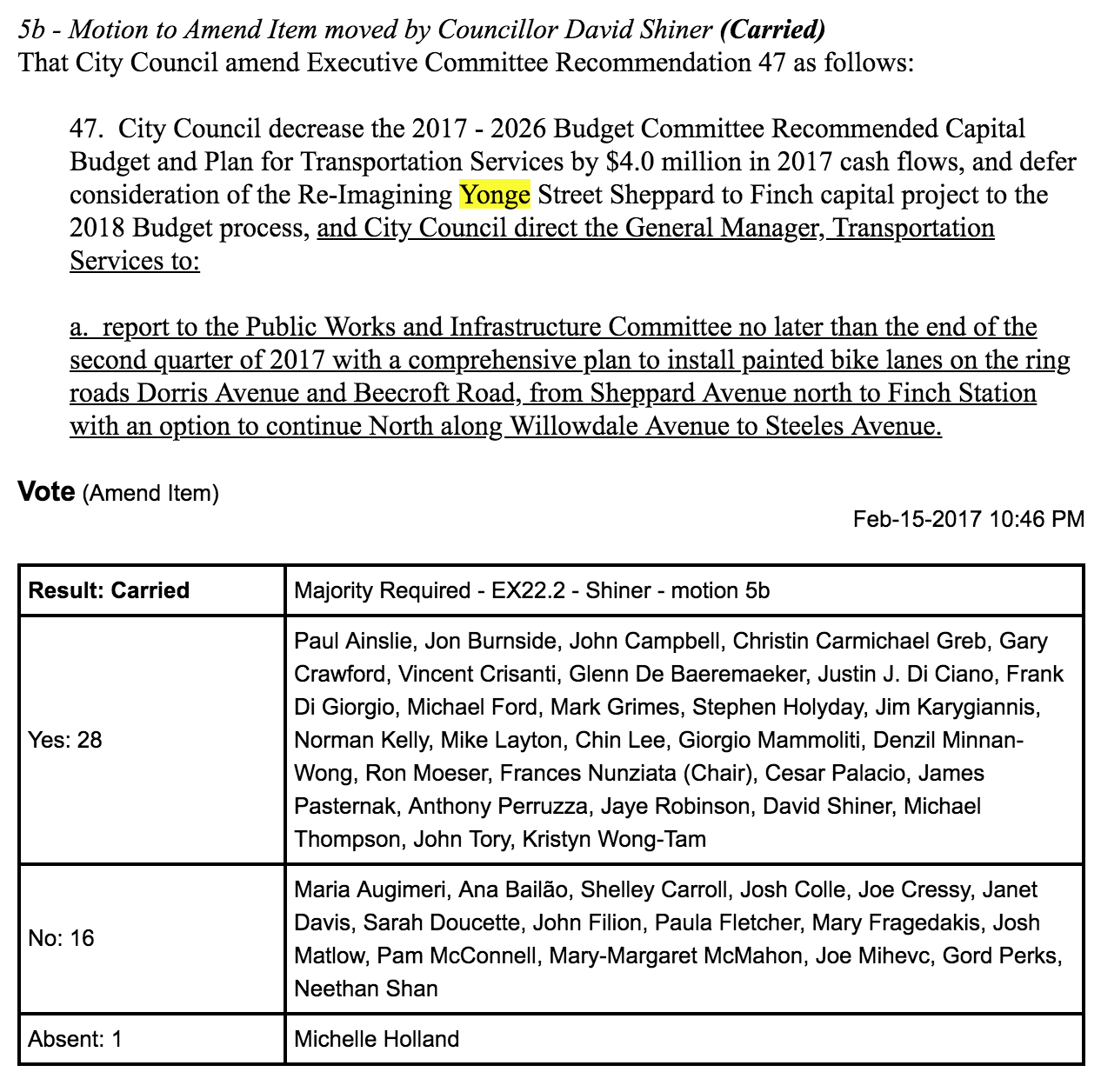

That was the Executive Committee, not PWIC. And the Committee couldn't kill the amendment, it had to be approved by the whole Council (which did approve it, 28-16).
Here's the vote, by the way

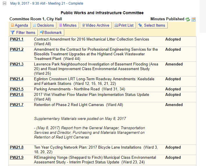

Yeah, I'm talking after that vote, though; PWIC considered it at its May meeting, in which it cast aspersions on essentially the plan that staff are now recommending. Motion 1, which was adopted, was all about finding alternatives to cycle tracks and lane reductions on Yonge.

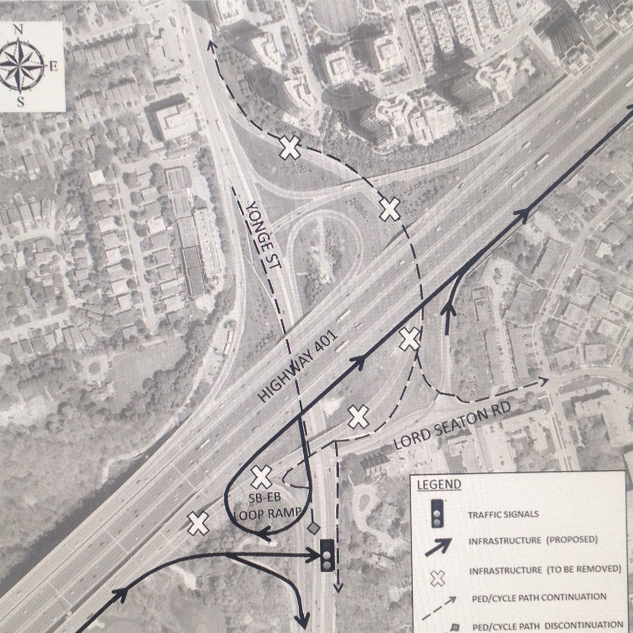

What is stopping the city and the province from re-configuring the Yonge/Hwy 401 interchange to a proper Partial Cloverleaf interchange? Is it the space restraints from the gold course, ravine, and cell tower? Or is the current interchange the same level of pedestrian and cyclist "friendly" as a parclo could be? Is vehicle flow capacity considered?
This really is a weird interchange, it is free flowing for eastbound 401 to north and southbound Yonge, but southbound Yonge to eastbound 401 required a left turn, into a ramp/local street hybrid?
The Yonge/ 401 reconfiguration would need to be a joint City-Province project. The City and local Councillor are ready to go, but apparently the province does not see this project as a priority.
Space constraint, yes. 401 west of Yonge is on a bridge. There's no easy way to turn it into a parclo interchange. Then it seems the majority of eastbound 401 traffic are heading north rather than south on Yonge, so MTO probably wants to keep the ramp as free flowing - that means turning Lord Seaton into an off-ramp is also a no.
It was built when the Spadina Expressway was still in the works. The expectation was that most people would want to go towards there, not the other way towards the DVP and Scarborough.
Anyways, the city's done a lot to improve it with smart traffic light timing (timing at the lights south of the 401 is based on left turn demand measured at the light north of the 401). I'm not sure that a full rebuild would help much, and because of Hoggs Hollow there will never be any significant bike use no matter how friendly the intersection is.
The City and local Councillor WERE ready to go,.... but apparently the province, specifically MTO, doesn't want more traffic on THEIR highway.
Province/MTO has threw roadblocks at every (City) EA so far,... with Provincial election coming, MTO is now doing another one of their own BS performance study,.... to stall some more.
Yonge-401 (McDonaldCartierFreeway) was original built in early 1950's as Full Four Leaf Clover,... with all on-ramp/off-ramp traffic movements being free-flowing,.... but with weaving issue as seen,... with eastbound 401 to northbound Yonge weaving with northbound Yonge to westbound 401
With Express-Collector expansion of McDonaldCartierFreeway to modern 401 system,.... Yonge-401 interchange was reconfigured to today's (Partial Clover) ParClov A4 / Diamond Hybrid,.... with dedicated eastbound 401 flyover-Yonge under-401 northbound Yonge off-ramp and northbound Yonge to westbound 401 getting free-flowing 270degree reverse jug-handle on-ramp,... avoiding previous weaving issue!
Technically easy to do ParClov A4 here,... but expensive at around $200million mainly for the additional bridge structure over valley,... way outside budget of $50 million.
Some other variants City and consultants considered here: https://www.toronto.ca/legdocs/mmis/2015/pw/bgrd/backgroundfile-85343.pdf
BTW, problem with any ParClov is you'll need signalized intersections,... there's a solution that get rid of both signalized intersections, thus, all on-ramp and off-ramp traffic movements are free-flowing (without weaving),... thus increasing capacity for all traffic movement at Yonge-401 (generally by 50%, 3-times and 4-times),... traffic just zoom-zoom,... and it's pedestrian and cyclist friendly too,.... all for about the same $50 million cost of the City's proposed southbound Yonge to eastbound 401 flyover,... problem is City Staff are chicken!
