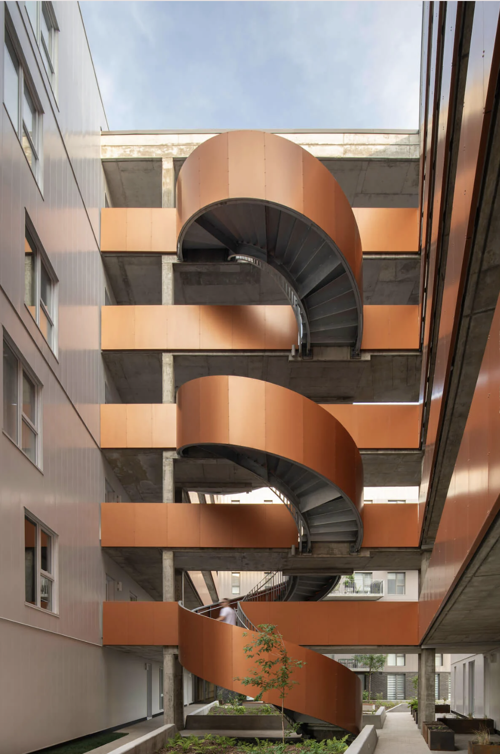

I am wondering if outside stairs may be a way around eliminating the need for two separate enclosed ones that are a barrier to building more mid-rise structures? Hopefully this will be resolved to the satisfaction of most parties this coming legislative session.
Not really. I mean, there are ways to do that...........but there are multiple challenges.
The overt issues though are security; you can't have people who don't live in the building gaining access via un-secured stairs. That requires a locked door and fenced/glazed surround of some description.
The code also requires that any stair case be effectively protected from smoke and fire elsewhere in the building, so it can be an effective exit. This is done by glazing/walls and fire doors.
You would likely need to address that, at that moment, likely looking at fully gazing in the stairs. Though perhaps the risk could be minimized satisfactorily in some other way.
But, once you add enough structure, for safety, fire proofing etc.; and lighting, and slip-resistant surfaces. I'm not sure you're saving any money, and its likely that that would be added to any GFA calculation by the City too.

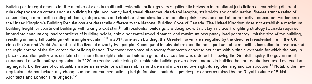

Everyone remember the horrible public housing tower fire in London, UK (Grenfell) that killed 70 residents?
Guess what it had? A single point of egress.
The proximal issue w/the spread/severity of the fire (insulation under the cladding that provided highly flammable........) was not tied to the single egress; but the casualties were.
Single egress designs in Europe are typically predicated on a stay-in-place fire fighting strategy, rather than evacuation. That strategy which held off attempts to evacuate the building were a contributing factor to the many casualties.
Source: https://secondegress.ca/A-Wicked-Problem
If people would stop treating every idea (single point egress, mass timber, more height , less parking, lower development charges) as the answer to affordability we could have frank and thoughtful
conversations on appropriate flexibility in building codes and a suite of changes which likely wouldn't significantly alter affordability but might yield slightly better unit quality and variety, albeit with some trade offs.

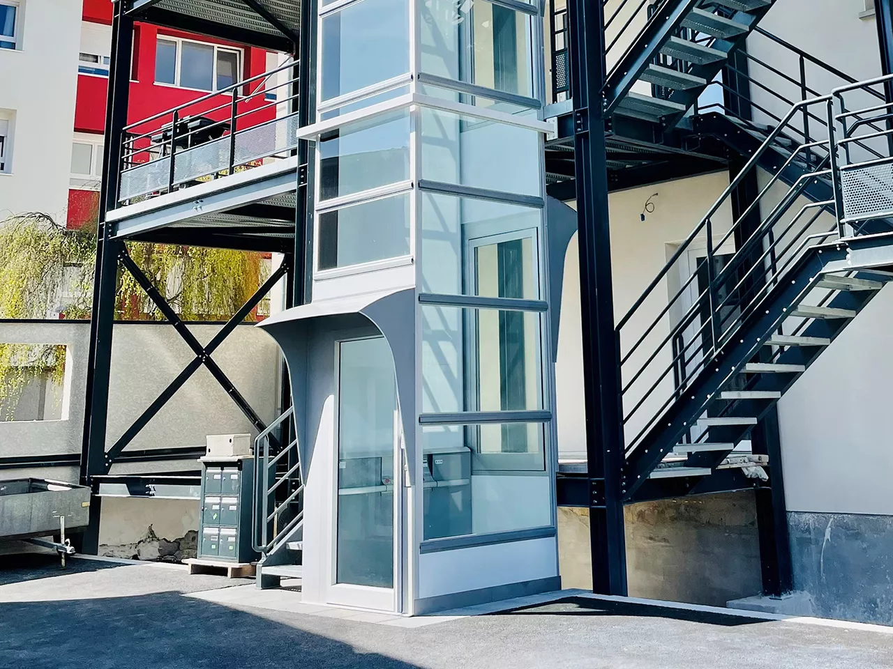

They could enclose the fire escape or second egress.
Maybe include a single person elevator.
